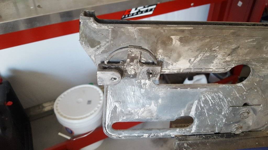

Looking for 65 300 quarter glass register, not sure that s the term. This is the part where the glass rides on. It's for a power window so no sure the manual is the same. The captured roller is broken on mine. Let me know what you have. Willing to buy a pair complete with glass.

I don't have any extra, but the part numbers are the same for all '65-66 C body convertibles and the '67-68 Imperial convertibles, so that may help the search.
2529-082 / 2529-083 are clear glass plus the frame
2529-084 / 2529-085 are tinted glass plus the frame

What about the other 67-68 C body verts?
Sorry, that was a typo.
Yes, all 1965-1968 c body convertibles, plus the 67-68 Imperial convertibles.
The other possibility, would be to find a matching roller assembly, drill out the rivet on yours, and replace it with different hardware.

That may be what I have to do. Would just need to find a roller assembly
