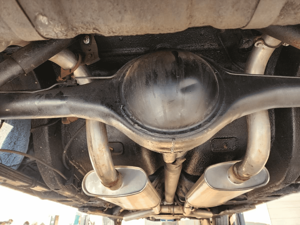

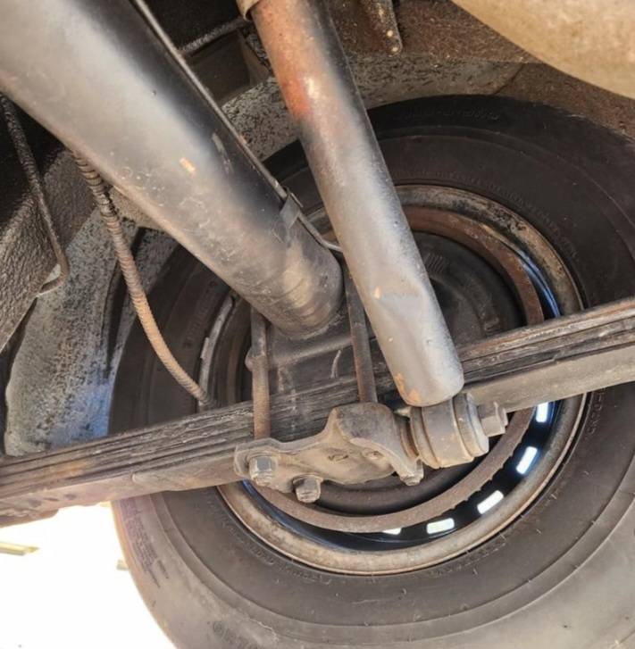

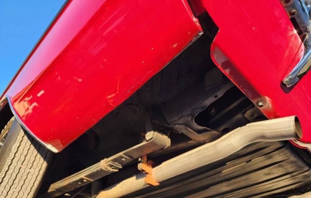

The undercarriage is the way it should be, No signs of rust or repairs..

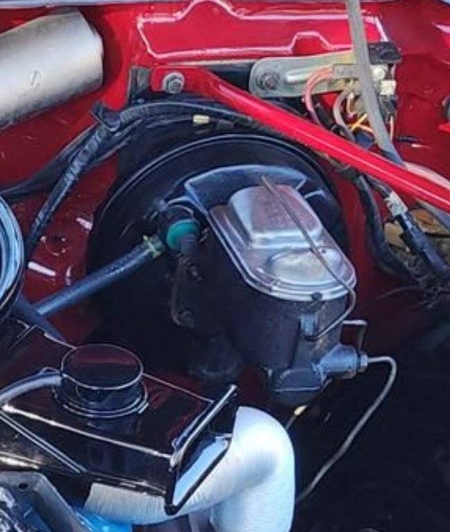

Drum booster on disc brake car...

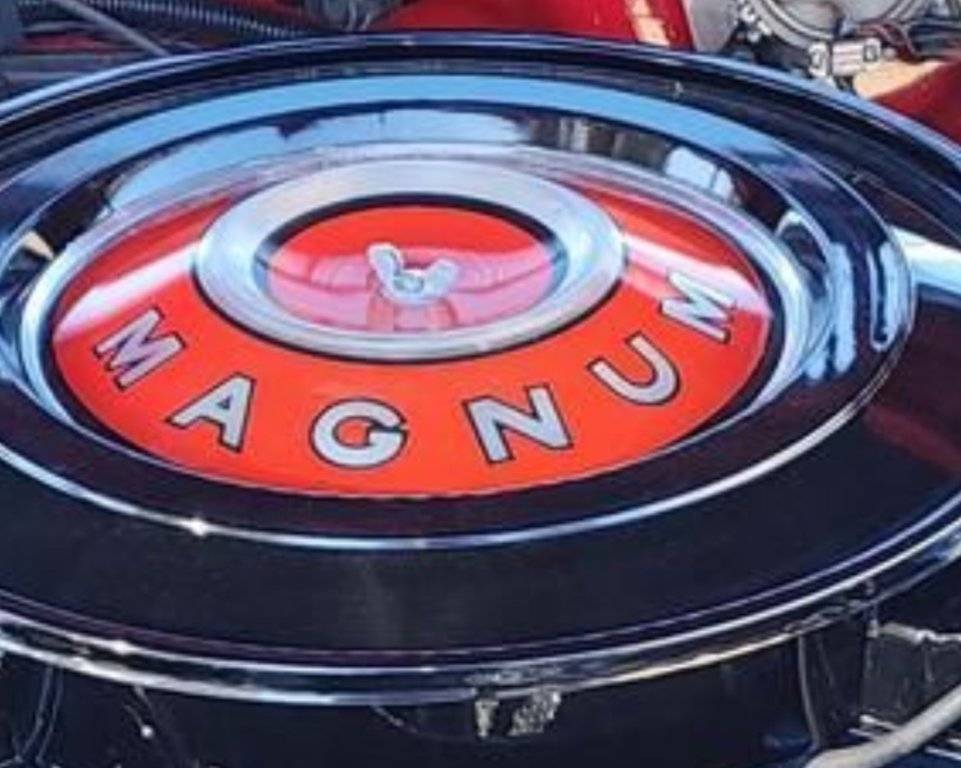

No pie tin would be correct for any engine option
No visible electronic ignition box. Also the black wire loom stuff. Totally wrong.

The car is really nice. For some, it might be slightly over restored, but I'm OK with that... At almost $40k though, I would expect no plastic GM type loom and the right booster. The ignition box is so common that it really wouldn't bother me.

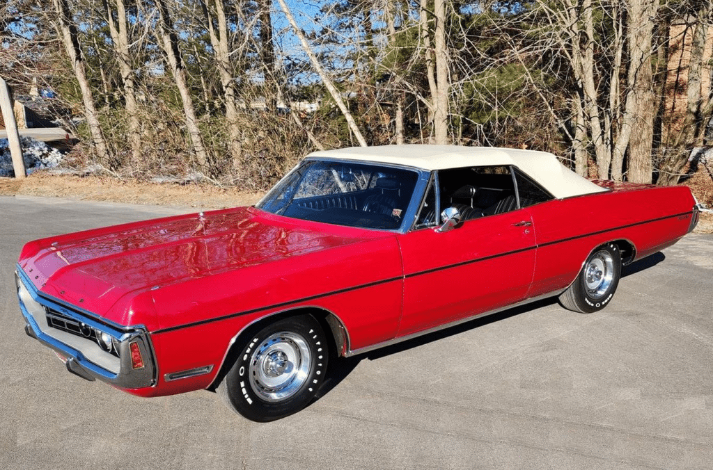

I like the Monaco grille and tail lights... But does that increase or decrease value? Same for the other deviations from how the car was built/delivered. As the price goes up, when do we start deducting for things like this? My own cars have changes like that so I'm not being judgmental. Just wondering out loud....

My black car has a 440 magnum pie tin on it currently and HP manifolds. Whenever I get around to actually restoring it, I'll go back to logs and ditch the tin.

I dont know if the Monaco stuff adds or subtracts value. To me it subtracts from the value, it's a "what if" car done incorrectly. The car needs the thick Monaco belt line moldings, Monaco seat covers and door panels.
