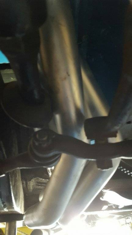

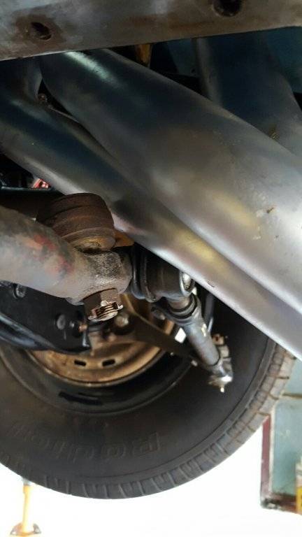

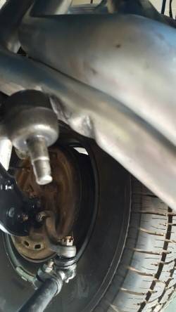

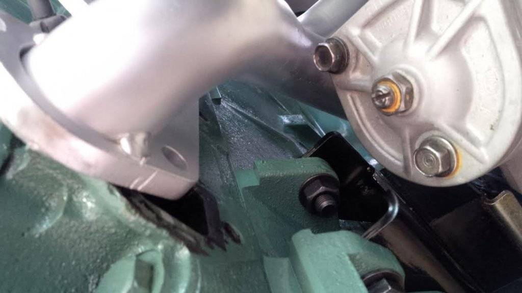

After pulling the torsion bar to get in the PS header, I found that I have serious interference issues with the idler arm (see pics) and the bellhousing. I checked TTI's website and found that their recommended fix for steering clearance issues is to slot out the motor mounts and move the motor back about an inch, which, of course, would require me to pull the engine again. However, it also doesn't appear as if 1" will solve my problem(s).
My next steps are to remove the motor mounts to see if I can modify them in any way (vs. the motor mounting stanchions welded to the frame) to move the motor back, which will partially resolve the clearance issue. I'll also have to notch out the bellhousing to allow the header flange to lie flush against the head. I'm thinking that I'll have to dimple (or dent) the header tube in order to get the necessary clearance. I'd rather not do that, but I don't see what other choices I have at this point.
Has anyone dealt with this issue, and if so, how did you solve it?
Looking at the car, I could heat and bend the idler arm, but honestly, that kinda scares me. Should I even consider the possibility?
I've heard different POVs about denting header tubes...some say it will kill performance, other say that you can get away with it, and you won't feel any difference.
I'm not looking forward to re-pulling the engine, especially to compensate for stupidly expensive headers that were "application specific" for my car.

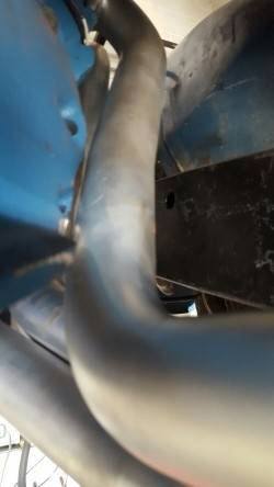

Though my Fury is a small block, I ran into a fitment issue where the the C body header on the driver side would not clear the manual steering box. I called TTI and they sent me out a B body header for that side and it fit perfectly.
Matter of fact it tucks in tighter underneath and runs nicely through the depression in the frame cross member, whereas the C body header on the other side hangs lower like you describe and is not centered in the cross member cutaway. It also comes very close to the idler arm, such that I had to put a plug in the grease nipple to get clearance on a turn. So now I have one C and one B and the C hangs lower which bothers me a bit. Can't help but wonder whether a B body header on both sides would be the way to go.
My advice would be to talk to TTI and investigate the option of returning yours for a set of 440 B Body headers. They might just work.
This is before.
Are they bolted up? They seem like they hang WAY below the frame.
Yes, the header is held on by 2 bolts. The flange won't sit flat on the head because of the bellhousing clearance issue.

Ok, headers are in. After notching the bellhousing by about 3/4", I had to massage the headers a bit to clear the idler arm and the tie rod link. Of course, then I found out that the 8 qt oil pan that came on the engine didn't have the proper relief for the idler arm when turned full right, so I had to pull the deep oil pan and use the original pan, which brings me back down to stock oil capacity. All told, I put in about 6 hours, took the headers in and out about 20 times. This was a learning experience for sure.
