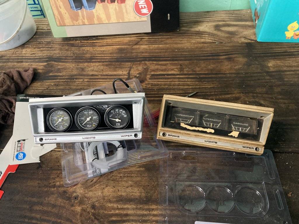

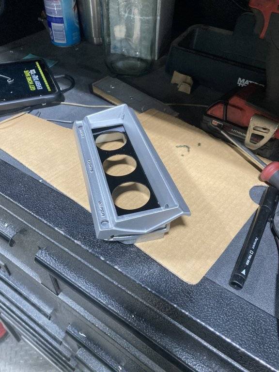

Took a factory gauge cluster that was cracked and missing the lens and turned it into a modern trio 1.5” gauge holder. Removed the back of the casing with a cut off wheel and used 20ga to make the insert. It is held on to the front face by mechanics wire bent at a 90 on top and small holes drilled between the gauges. To make the gauges fit I had to remove the bottom recessed section of the face and welded 1/4 nuts to the bottom of the front steel face to give it a small space between the gauges on the bottom.
Very nice. What about the fuel gauge? Would love to do something similar
