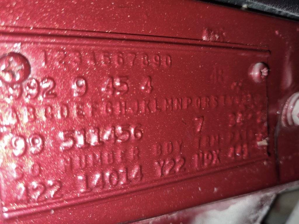

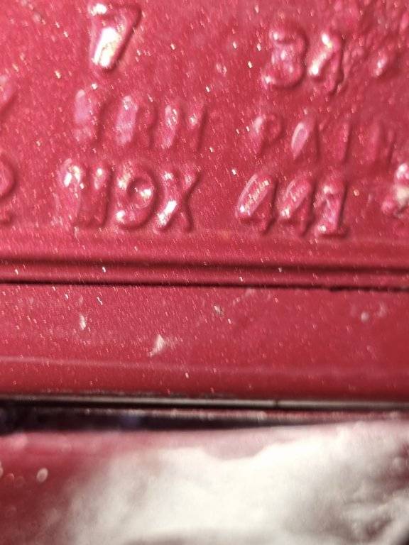

I am new to classic Mopars and Imperials, but I was trying to figure out the original color on my ‘65 Imperial. Under paint on the data tag it reads 441. I couldn’t find anything on the internet about what color was code 441. I’ve included a picture of the tag below if someone can decode it.

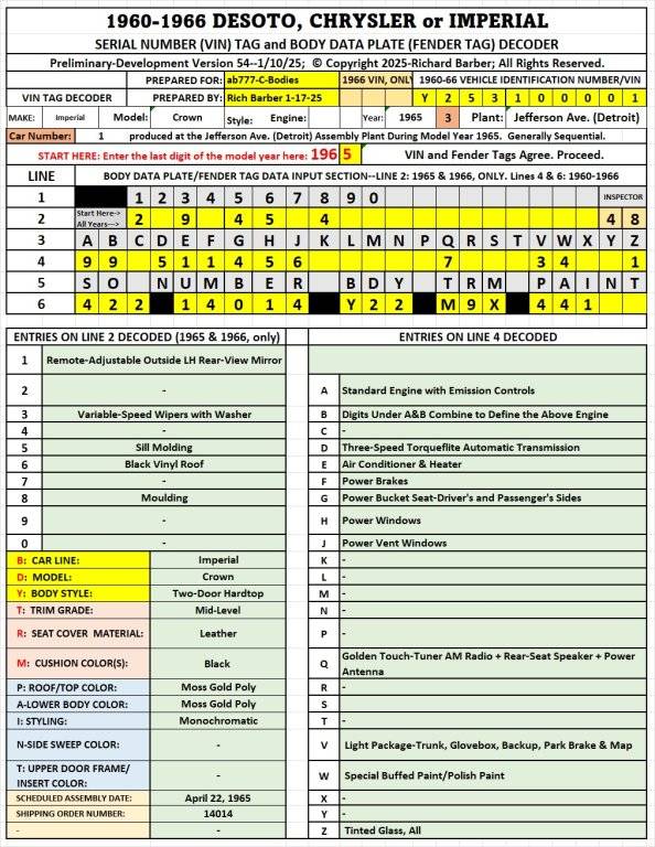

Here are the 1965 Imperial paint codes and a decode report attached. Seem about right? I would appreciate any feedback or external pictures that might help define the "Moulding" by the "4" under the "8" on line 1. Door edge? Sill? Side? I note that some LBaron's have a nice, wide moulding/stone shield running from the back edge of the rear wheel openings to the back bumper. Perhaps this is a Crown option?
PNT CODE1965 O10=5
IMPERIAL-9
ARegal Gold Poly
BFormal Black
CIce Blue
DNassau Blue Poly
ENavy Blue Poly
FMist Blue Poly
GSequoia Green Poly
HN/A
IN/A
JN/A
KPeacock Turquoise Poly
LRoyal Turquoise Poly
MGranite Gray Poly
NSilver Mist Poly
ON/A
PN/A
QN/A
RSierra Sand
SFrench Ivory
TSpanish Red Poly
UN/A
VCordovan Poly
WPersian White
XSand Dune Beige
YSable Tan Poly
ZFrost Turquoise Poly
2Sage Green Poly
3Pink Silver Poly
4Moss Gold Poly
5Black Plum Poly
6Mauve Poly
7Patrician Gold Poly
