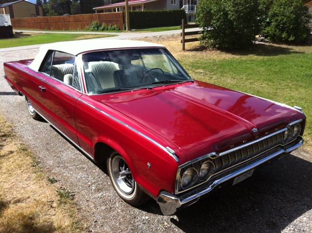

Your car would pop with 15" chromie magnum 500s and 235/75/15 Hankook Optimo tires. This is what I run on my 66 Monaco. You can go considerably wider, but not too much taller. Too tall or too short a tire will result in inaccurate speedo readings. I believe you need a 28" tall tire... There is a tire height calculator out there that can help you figure that out, but again, don't go too wide. Below is the tire calculator:

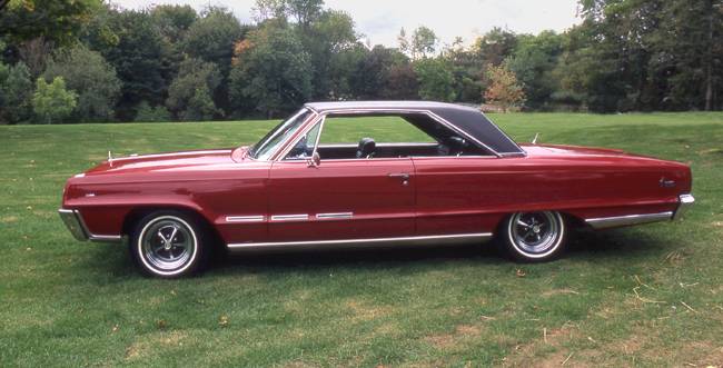

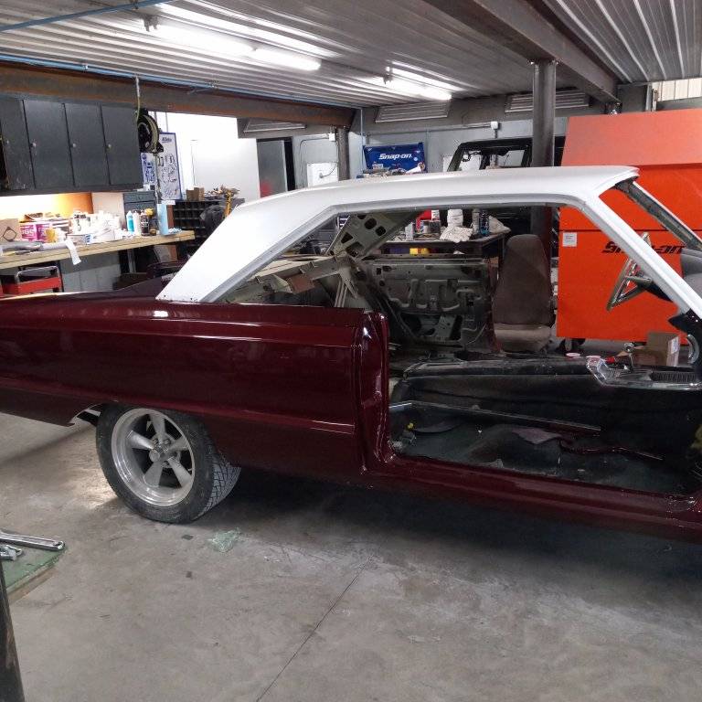

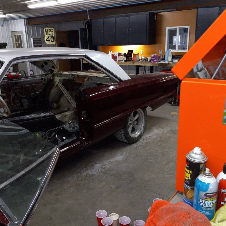

I have a 65 Monaco which has 225/50/17 tires on a 7" rim on the front with 255/5017 on an 8" rim on the back. Other than having to jack the car up at the front leaf spring perch to get the rears off and on I have had zero problems with these wheels and tires.

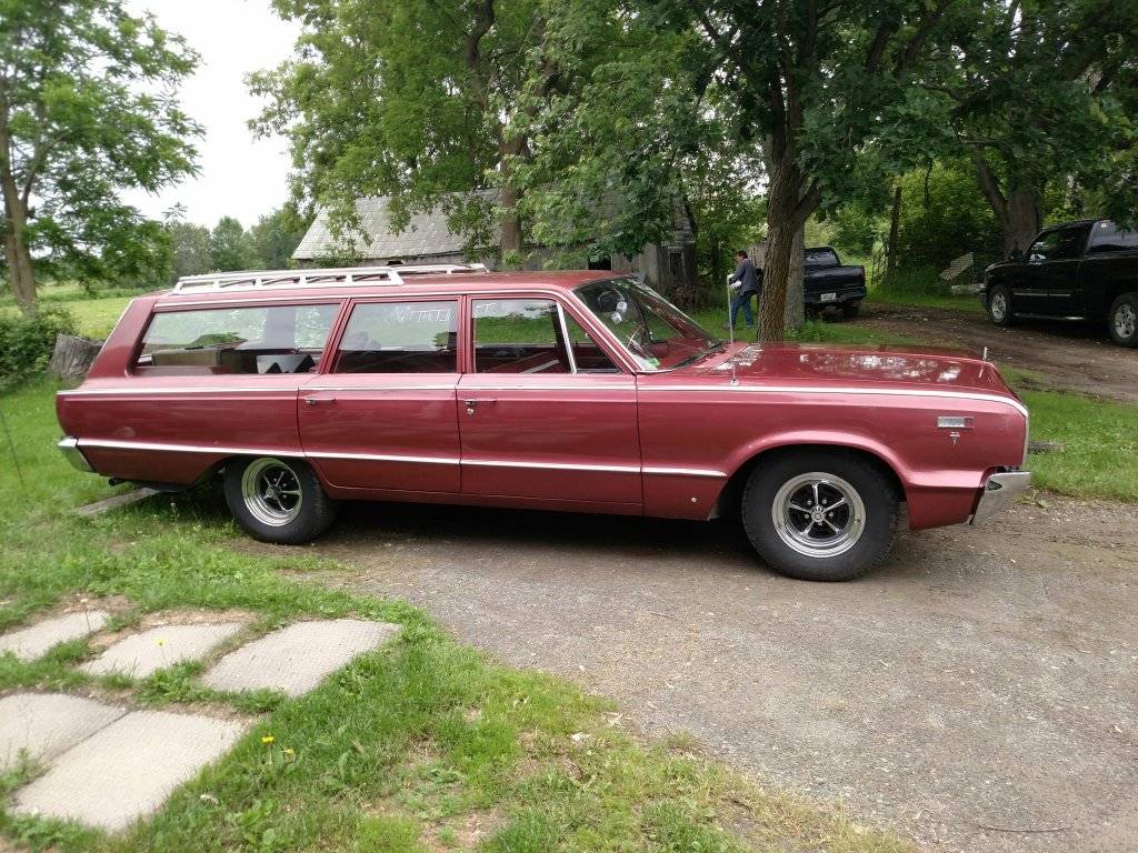

235 70 15s all the way around on our 65 wagon.

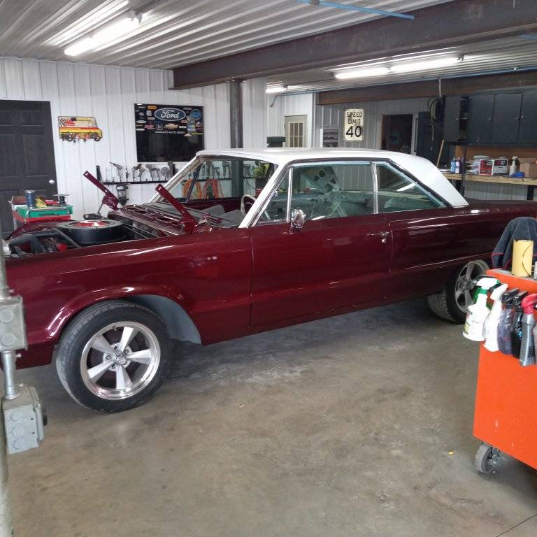

They are ridler wheels. I don't remember the model number. They have been on the car for 8+ years. I have had zero issues with rubbing or hitting any body panels. The key is, especially with the rears is to get wheels with zero offset. My apologies for the quality of the pictures. I haven't taken any since I got it back from the body shop.

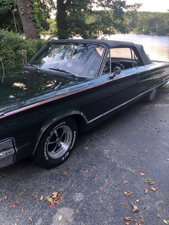

Thanks. Those wheels are discontinued.....kind of. You can get them all chrome. Mine have an aluminum outer ring, the spokes and center are silver Grey. The rears take a little finesse to get on and off, but once they are on I can get my fingers between the tire and the quarter panel.

Kevin, my 65 Monaco has the same rims as yours but in 14". Are yours Stock rims or aftermarket. I am going to upgrade my front brakes to disc and its opening up a can of worms. Thanks
