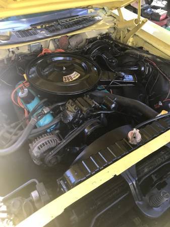

I purchased recently, and as a mechanic, tore motor down to longblock, new double roller timing chain set, timing cover, seals, water pump, accessory drive hardware, radiator, rad hoses, Valve cover gaskets, plugs, wires, distributor, cap/rotor, etc. Less than 200 miles on these items. Fresh engine oil/ filter and trans service.

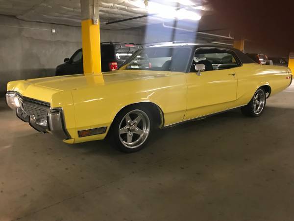

Wheels on car now are American Racing AR135 Torq Lites 17x8F, 18x8R with 95% tread. Also shown above
Car includes all original keys, books, both sets of wheels (unless you don't want), and an Edelbrock performer 4 barrel aluminum intake with a *4 barrel Holley 4160 that was just rebuilt(photo above)
