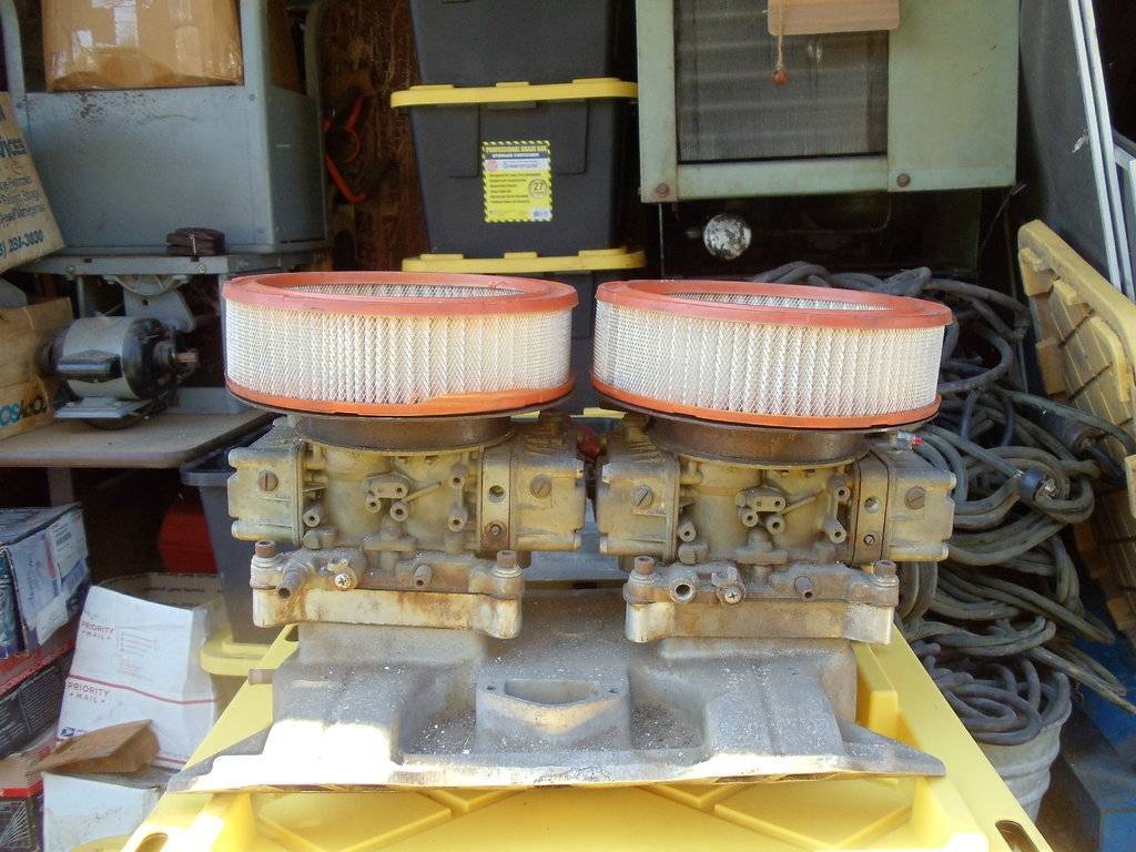

i heard the holleys have to ride sideways to fit on that intake. i dunno its just what i heard. i do know 2 eddys will fit - there is a pic somewhere in this forum of test-fitting an offy 360 2x4 intake and 2 eddys onto a 383.

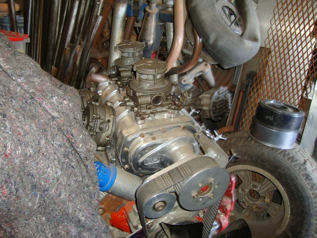

these base i made for /6 air cleaner elements . and your holley need to be raised a bit to get throttle linkage clearance as i did . guess you could stack gaskets and spacers on that offy adapters . but they bend up on the corners abit and could cause a vac leak and toning issues . i drilled those spacers to the offy bolt pattern , bolted them direct to the offy intake . maybe you could run the early /6 lids too . never tried them on this package . just this one atop the blower .
mine are thicker than that . i think 1/2'' plates would not wrap as 1/4 '' ones . i use 1'' thick solid with four thru holes i believe , not sure of your holley carbs . but these holley 660 cfm's have a lot of swing to the linkage .

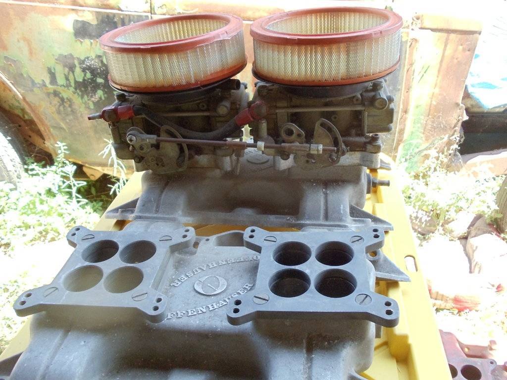

The pics of the Holley's appear to be on non-Iffy intake. The intake I purchased is the one with the aluminum adapters already mounted to the intake without carbs mounted on it posted by Pomonamissel. The Holley's I intend to use are 450 cfm 4 barrels so the overall sizing is still reasonable. Only reasons to go this route is the original vehicle story and the fact that I already have everything except for the intake. That and the cool factor, of course! ;)
