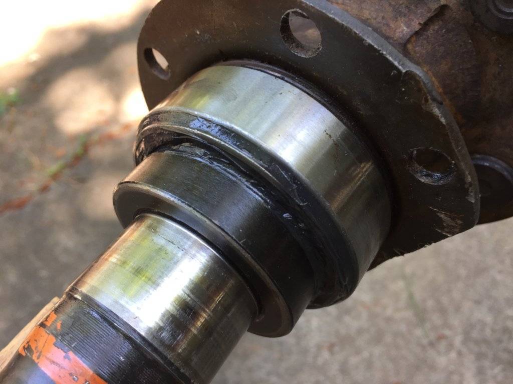

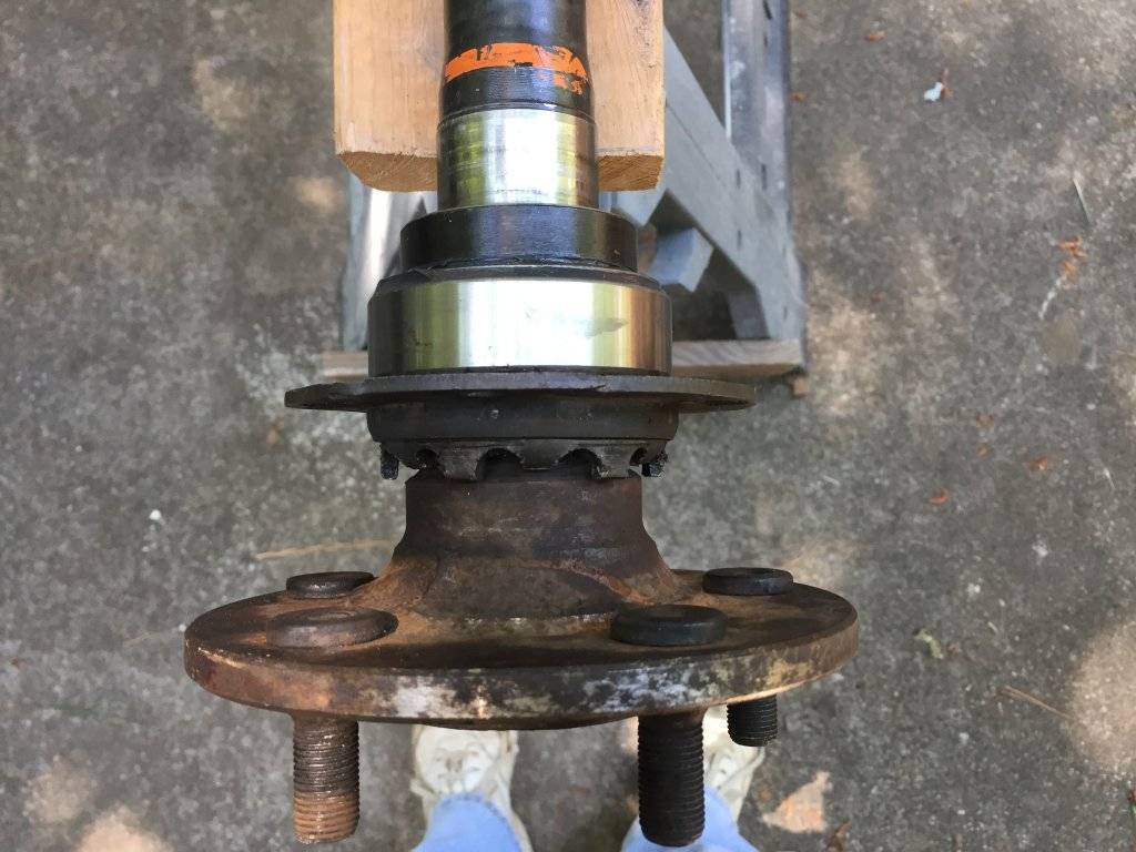

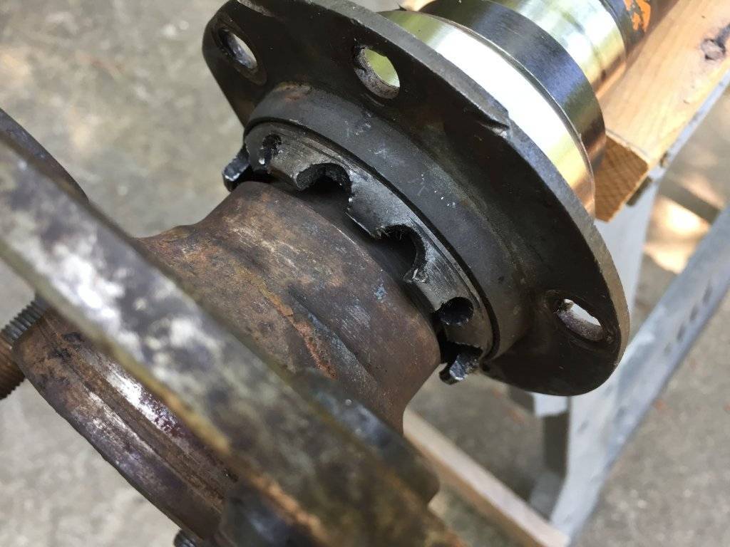

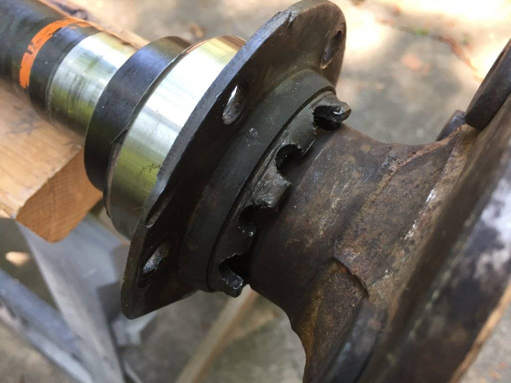

Okay guys. I have a question about the passenger's side axle. I know you install the driver's side first and then the passenger's side. You make your adjustment here. The axle flange case has teeth on it and there's a locking washer that when you tighten the flange down to the back place the key part on the locking washer fits down between a couple of the teeth. My question is how does it adjust and that does it adjust. Does it screw in and out or what. See attached photos. Also I cleaned out as much of the old grease as I could and used a grease injection needle that attaches into the end of my grease gun to insert the new grease.

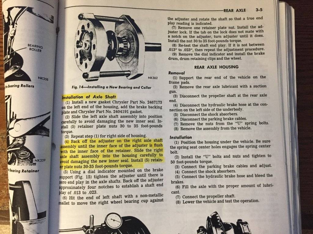

In going through my Plymouth 1965 Service Technical Manual last night I found on page 3-5 under Installation of Axle Shaft the steps on how to install and adjust the right axle. I don't know how I missed reading this as many times as I have gone thriught this section. From what I understand reading this section you back off the Adjuster ring that has notches by unscrewing it. Then after you get the axle in place you install five nuts you then tighten the Adjuster ring then hit the left axle hub with a mallet to knock the right wheel bearing cup against the Adjuster then rotate the axle and then back the Adjuster ring off four notches. Remove the nut to install the locking washer. If the locking washer end doesn't go down into between the notches back it off to the nearest notch and the install and tighten it down. Rotate both sides and make sure they turn freely. It also talks about use a dial indicator to measure the end play. Well I don't have one and don't know where to find one. I have attached page 3-5 for everyone's review. Is my understanding correct on how to do it. All comments are welcomed with open arms. Please try and write down how you Polara_500 and Polara71 did it for me. Please.
I did it per the FSM. I didn't reference it earlier since I figured you hadn't reviewed it there as it's so well described. I didn't have a dial indicator either, just pretty much ball parked it and it's been fine for about 30 years and 200K miles so I don't think the dial indicator is really needed. Too much detail to repeat what's in the book, at least for this old non-typist.

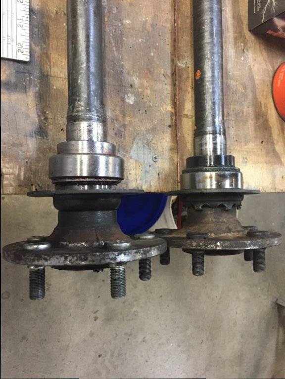

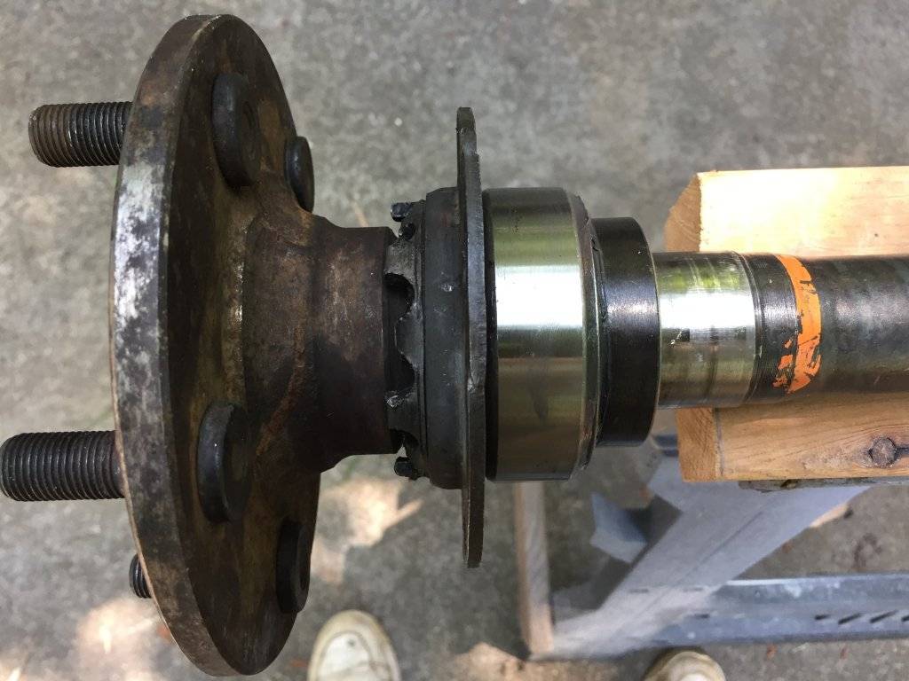

The guy that put my new outer seal, bearing and collar put the bearing on wrong and didn't press them on far enough. He's telling me that this is the correct way and I said that he is wrong and needs to do it the correct way which means he will have to buy new bearings and collar out of his own pocket. I'm posting a photo of the left and the right axle showing the bearings. The black collar is the passenger side and the bearing face toward the Diff and on the plain collar the bearings face the outside of the car. The passenger side is the side that he pressed on. Which one is the correct way the bearings should face. Black collar or plain collar.
The pic's of the axle in this post was it before the bearing replacement? I would use it as a guide.

Gentleman I have not forgotten about you. Here are where we are now. The rear axle bearing has been installed correctly. Both axles have been installed along with the wheel cylinders and shoes. The brakes have been adjusted and bleed. The assist vacuum pump has been installed a long with a vacuum gauge. The pump works great. Had been driving the car a couple of times a week but having a problem. I have a good hard pedal but was soft at the bottom at the final stopping point. Stopping the car was a lot better but it still didn't feel right. The softness at the bottom concerned me so I took it back to get that taken care of. Come to find out the dual booster and the dual master cylinder were both leaking. At this time waiting on parts. When I build the car I converted the front to disc. The single master cylinder and single booster was not strong enough because of the cam in the engine not letting the engine to product enough vacuum. After converting over to a dual master cylinder and a dual booster and installing a vacuum recovery system things were better. It now seems that time has taken it's toll on the brake system. This general maintain deal now has gotten blown out of the water.
