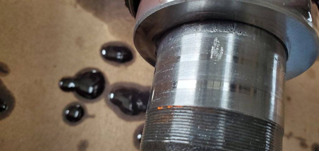

I was talking about the seal, not the shaft. I have also heard of people drilling a screw hole in the seal, installing a screw, and pulling out the seal by grabbing the screw with pliers.
This operation is one which the utmost care possible should be used on. I made a nice seal driver from some SCH 40 PVC pipe, to minimize damage to the axle tube or new seals. It worked well, with nary a drop of gear oil escaping after replacing one axle shaft w a nicked journal.
I used a socket and it worked fine. It's been at least 6 years with no leaks. For me it was important to measure and assure that the seal was seated, then stop hammering.

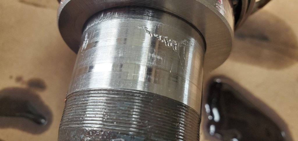

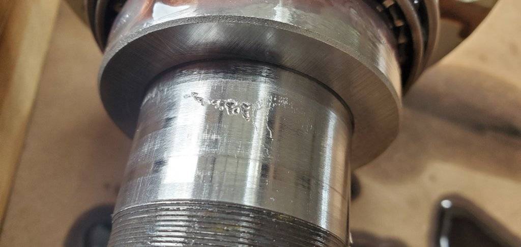

I did not know these sleeves were available. Might be just the trick to get the OP on the road to recovery. Another trick I heard about is to not drive the new inner seal all the way home in the axle housing. Drive it just far enough so that the seal contacts a good smooth surface that is away from the damaged / nicked area on the axle. Of course you hafta be sure the seal is straight and true and not cocked.
was thinking that same thing. looking at the damaged axle, i can see two dark rings. one intersects the damaged area, the other further inboard. thinking they were made by the two areas of the seal that contact the axle. looking at the housing it appears that the seal is driven all the way in. it would be easy to check the depth of the oil seal surface to see if it's contacting the damaged area of the axle. if it's only the outer dust seal surface area of the seal, i'd polish the high spots off those diggers with a cookie wheel, grease it, reseal the housing and try it.
One can even drive in 2 seals, or contrive some other spacer to avoid the compromised inner surface. The repair sleeves, being from Timken, look very promising. I'd try those if I had such a problem.
Redi sleeves are very effective and simple to use. They are made of stainless steel and as such will wear longer than the original surface. Since they are several thousandths thick, the seal will be just that bit tighter as well. I have used them on engine front seals as well as in machines with 4 to 6 inch shafts with excellent results in hostile situations. I'd do it in a heart beat! Lindsay
I sanded the axle smooth, repacked the bearing, installed a new seal at a different depth, added some 70W90. Test drive tomorrow. We'll see how it goes. Thx
Yeah those divots didn't look all that bad to me most likely were done in the collar removal process with a errant cold chisel strike. I would've just fine filed it down then some Emory cloth, (heck you can even go so far as wet stoning it for a final polish) then install a good USA quality seal and as the Aussie's say "Bob's yer Unkl".

Went for a 25 mile drive, no leaks so far. The diff still grinds and pops when turning left though.
Go to the MOPAR Parts counter and pick up two bottles of Sure Grip additive and pour one of them in the diff. You may or may not need the second bottle.
