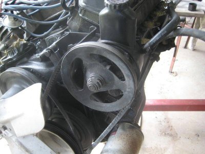

Anyone have an suggestions for new pulleys, brackets and turnbuckle bolts? I'd like to use the new style 6 rib belts for alternator and power steering. So any suggestions people have on a fill setup is appreciated.

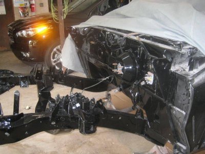

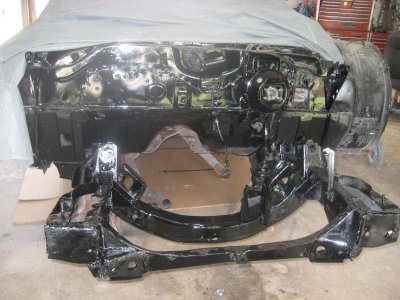

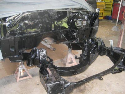

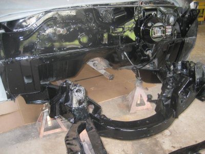

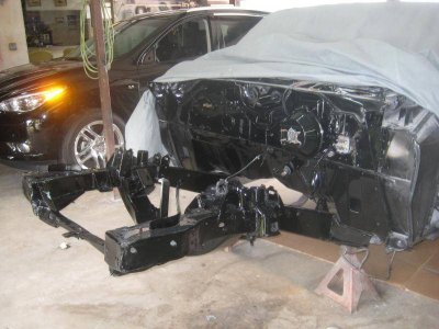

I stopped by the other day and here are some more pictures. Firewall and sub-frame have been painted. Once the motor mounts come in and installed then the engine and trans will go back in. Then the front suspension and then the headers will get a final test fit before they go out to get jet coated.
Here are some more pictures.

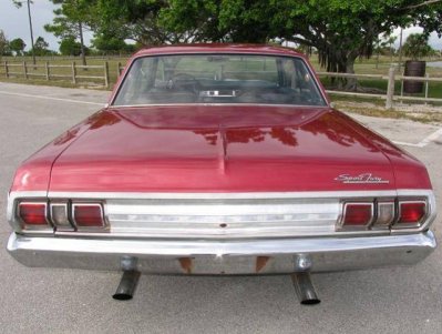

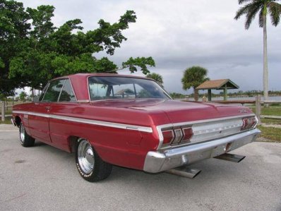

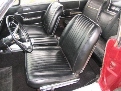

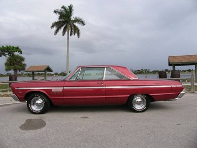

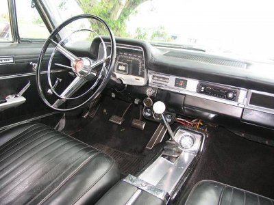

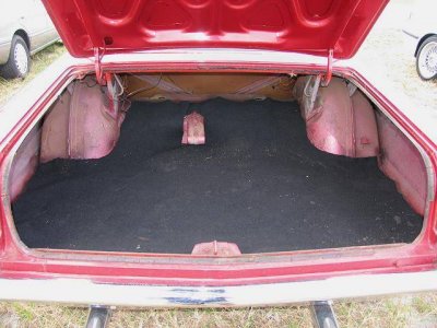

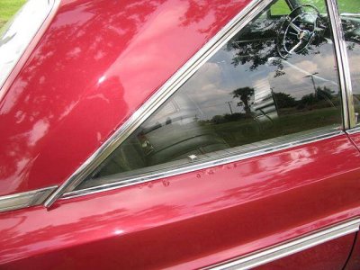

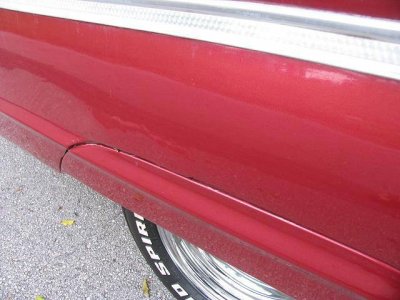

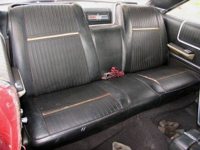

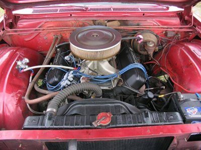

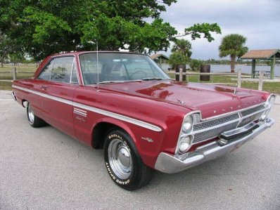

Well I thought I lost the pictures of what the car looked like. These are from the eBay ad when I bought the car in Dec 2006.
The person selling it was Lake Worth. It was so long ago. It ended up with me over around Tampa. At the time for the price I felt it was fair. In 2006 plan jane Roadrunners were going for well over 20k. So I felt what i paid for a big block 4 speed car was good. The body was in good shape and not too much rust. The driver side floor was rusted through. Then when it got on the frame machine it had been hit and needed to be tweaked.

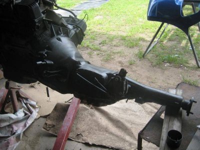

the rest of the pics that didnt upload.

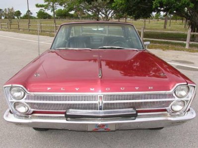

Can I ask,.what is the piece in the middle of the bumper? Post 71, 7th picture. I never saw that before? Car looks great.
This should be an optional grille / bumper guard, think this was even factory Option. Rarely seen, Looks a bit odd IMHO.
Factory Cattle Catcher option. :)
I agree it looks strange but it is rare. For what it's worth.
I was going to say it looked kind of strange. You could always remove it and put it aside if that's what you want to do. Car looks great though.
I was talking about taking it off of mine but the wife wants to keep it. WTF! LOL. She is really killing me with this crap!

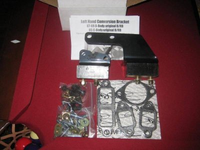

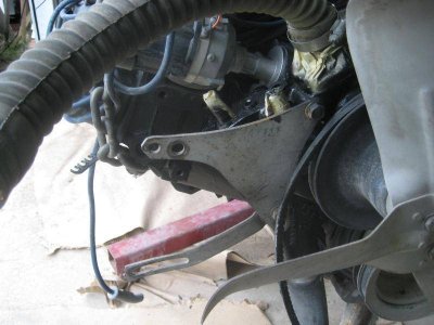

motor mounts w/poly locs, header bolt kit and gasket showed up today. Poly locs were on back order. i'll post pics when the mounts are done. It'll be a long while before i know how well they work. But the driver's side mount takes care of putting a 440 in a 65 Fury.
