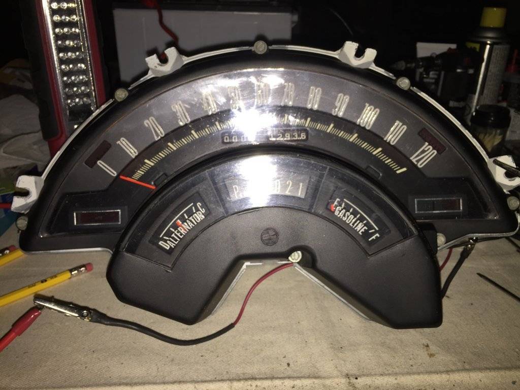

Back to the instrument cluster. Ironically, the last thing I was working on with the Road Shark was tracking down electrical problems and non-working lights, features, etc. When I crawled up under the dash and removed the cluster connector, it brought 2 pins with it. Oh, yay. More stuff to fix!
I like the brass brad repair, nice and strong and keeps things close to original in case the Mopar police pull a surprise inspection some night. Just be sure to clean off any excess solder flux as it can eat into things like the old phenolic board and other connections, as well as causing shorts. An old toothbrush works well.
For practicality in testing and repairing, as well as removing any stress from the old board, the remote approach is the way to go. This allows easier access to both the harness and cluster for testing a dead circuit, by providing a longer cable and connector to check with your DVM or VOM.
I need to test fit one of my connectors at home, but I think a standard 8 pin plug pigtail could be soldered to or in place of the pins and brought out to a convenient length. Here's an example on epay:
http://www.ebay.com/itm/6pcs-8Pin-o...lug-Base-for-EL34-6SN7-KT88-6L6-/281784757019
The one issue I see is that Chrysler mounted the keyway on the female connector, which would require removing that and replacing it with the corresponding 8 pin socket. Don't do this if you're afraid of the originality police.
You could come up with similar connector solutions to the other pins on the board, even make it completely reversible with a little extra effort.
Good luck with it, Dobalovr. So far my dash has a working ammeter and parking brake light. And 2 loose pins....!
The more I think about it Boomer the more I agree with your assessment. I know for a fact this won't be the last time I will be up under the dash and with how fragile the pins are you just know more will be coming off. Moving the pins to an 8 point plug seems the right thing to do. Now all I need is some 50 year old brass brads!!

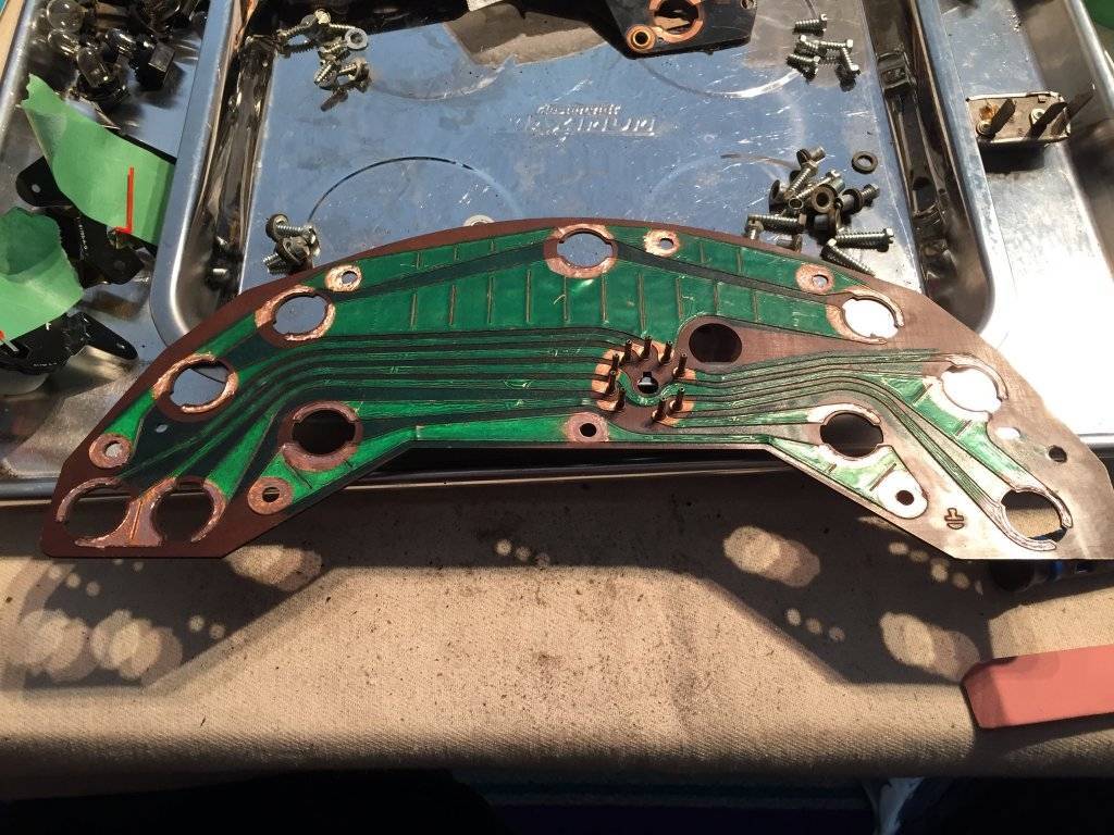

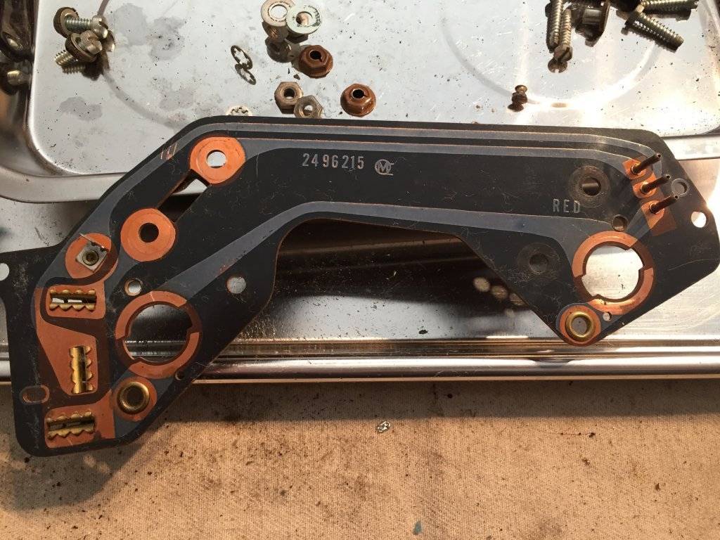

Getting good at restoring these clusters ...here's the second one I've done.

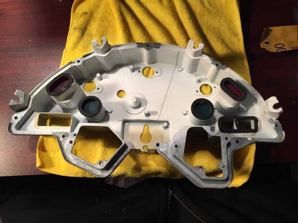

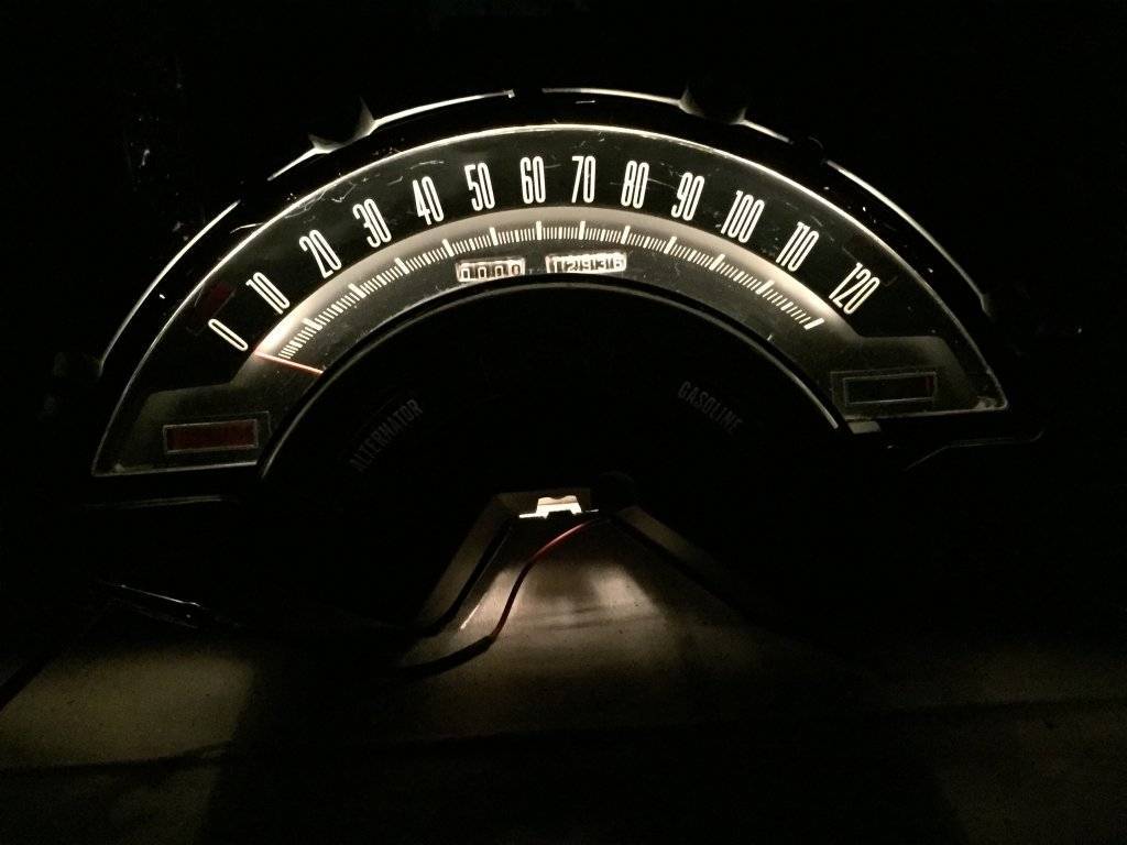

Disassembled & cleaned, contacts cleaned, guages checked, bulbs replaced. I remove the blue bulb covers as I suffer from poor night time vision and the blue light makes it hard to see the guages.
I had to remove the blue condoms myself. I tried the blue tinted bulbs but in use, they didn't have a blue glow at all. Finally replaced those with normal clears and said screw it.
Dammit. I should have taken out the blue lenses when I had mine out. The brighter lights look way better! Although I'm not out much in the car after dark. Looks good
