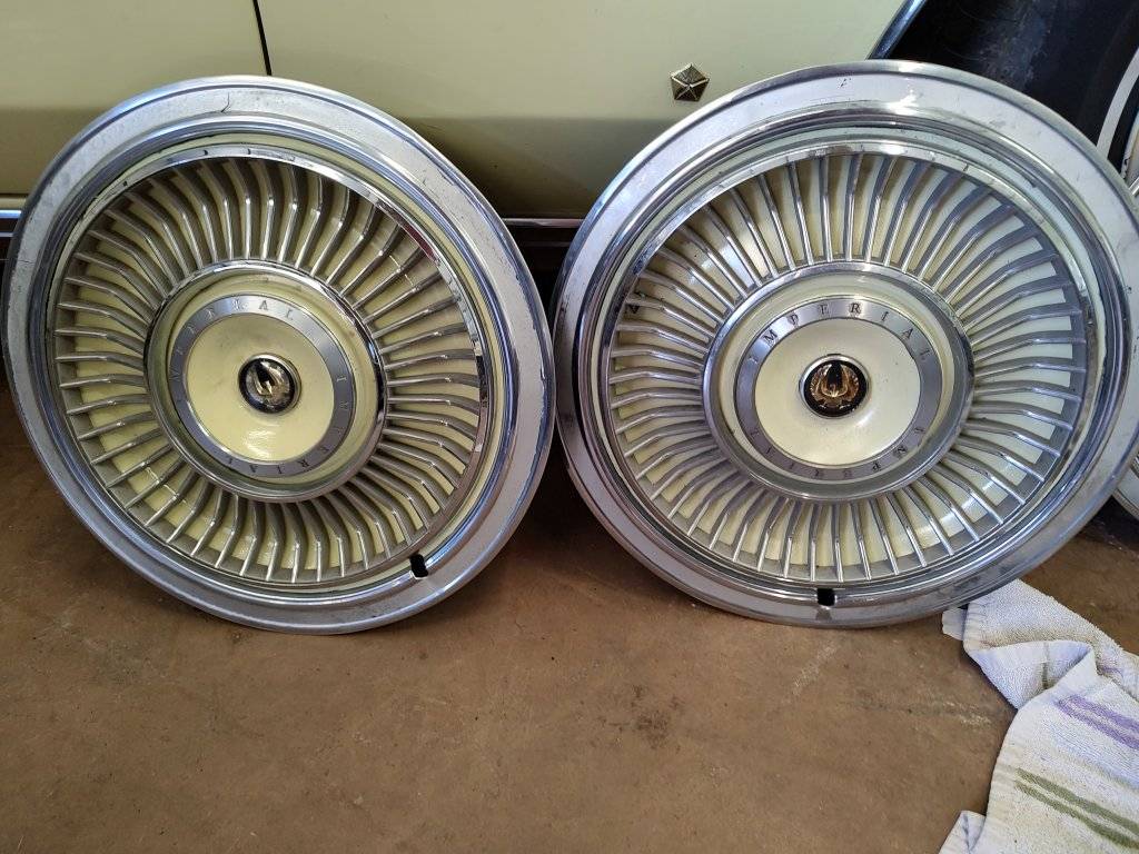

I decided to pull the wheel covers off the Imperial and restore them, somewhat. All four are the same, but two are original to the car, whereas the other two appear to have been replacements at some point. The color finish is the giveaway.

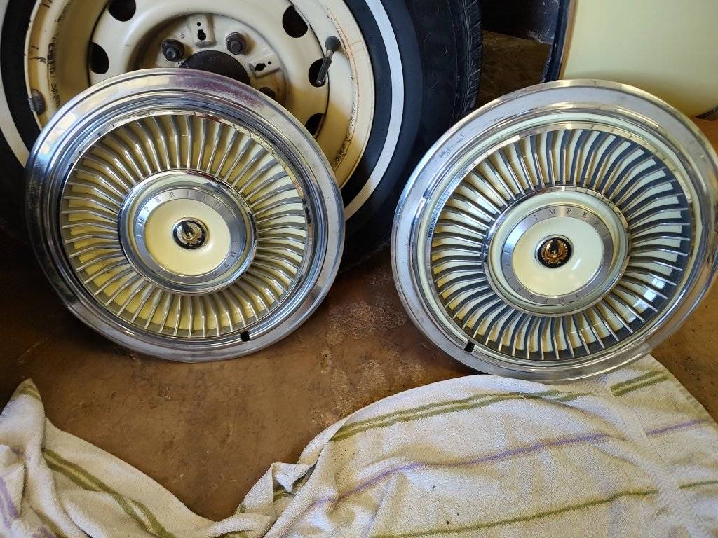

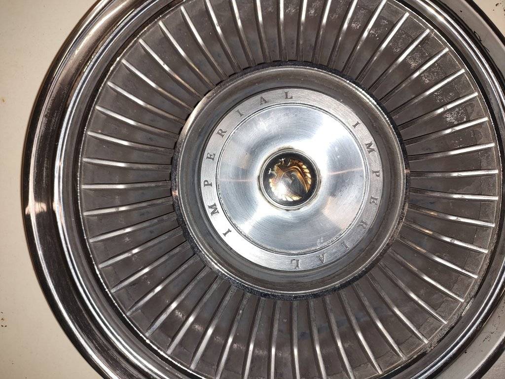

The first is a cover that doesn't match, as it has a bright center and dark background.
The other is body-color, but very faded. I was thinking one of two possibilities here - make the center shiny and the area behind the turbine yellow, or do both yellow; as the second cover is yellow behind the turbine.
One of the local O'Reilly parts stores does paint, as well. I brought the '66 Chrysler codes to them and they didn't have a Ditzler cross-code ability. But, Ford Crocus Yellow is a dead-ringer! I bought a custom-mixed 7-oz spray can and a vial of touch-up that can be used with a brush. I'm taking apart.my first cover in the morning and see what happens!
All of the ‘66 covers I have are black in the middle and some sort of mildly textured argent behind the turbine trim.
I was looking at the dark-centered cover I have. That is the cover I had apart once. it is black behind the turbine. I'm going to go ahead and stick with my original plan of yellow centers and background on one cover. That'll be a good comparison to see which will look better on the car.

I think it will look great!

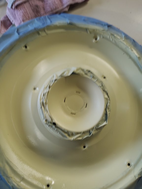

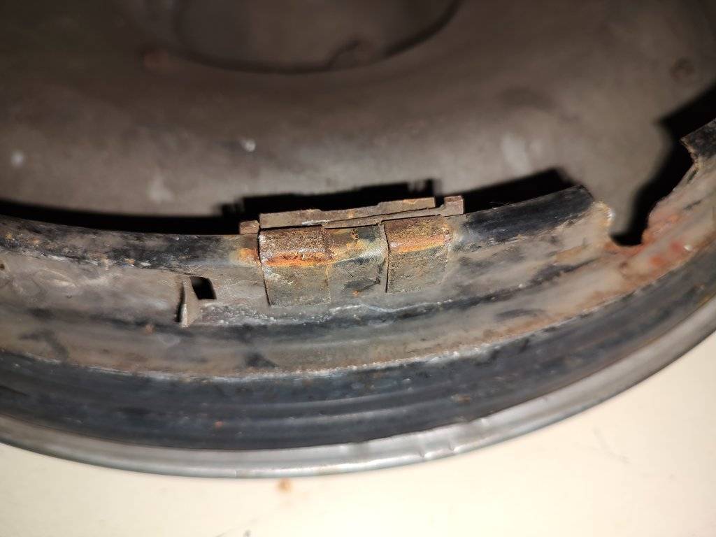

First pic is of the weight used to balance the wheel cover. Second is (probably) the date code when it was ready for the line after balancing. The third is impossible to tell, for me. It's very faded. The last pic is of the center and medallion attachment points. There are 12 tiny little 1/4" screws holding it all together

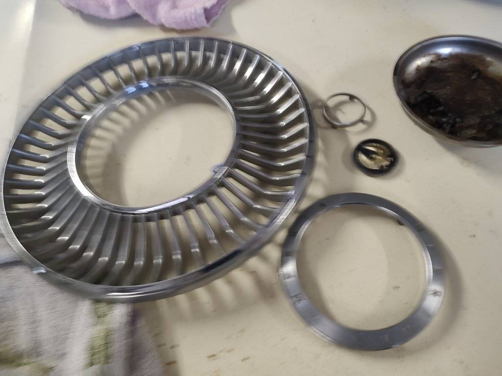

First cover gets disassembled tonight.
I disassembled the first cover today. I cleaned up the six components and masked off the main cover. The Crocus Yellow is so close to what' is on the car! I'm pretty happy. I'll let the paint thoroughly dry overnight and assemble it in the morning.

On one, the medallion was glued hard to the cover, so it is a little askew, compared to the other three. This one came out very nice. I painted the Argent Silver on the outside band on two covers, this was one of the two. Next pic will be the covers on the car, and the end of the story.
