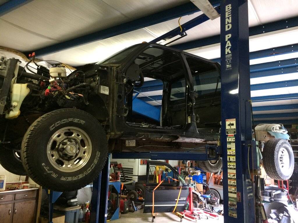

What's happening in Bigmoparjeff's garage?

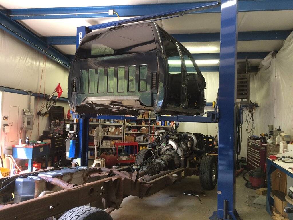

Up on the lift to disconnect the shift cable and unbolt the body mounts.
Up, up, and away!

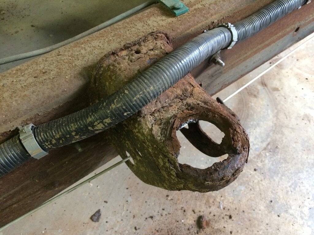

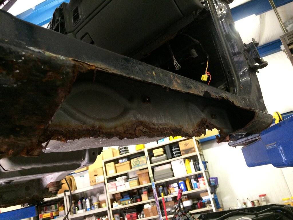

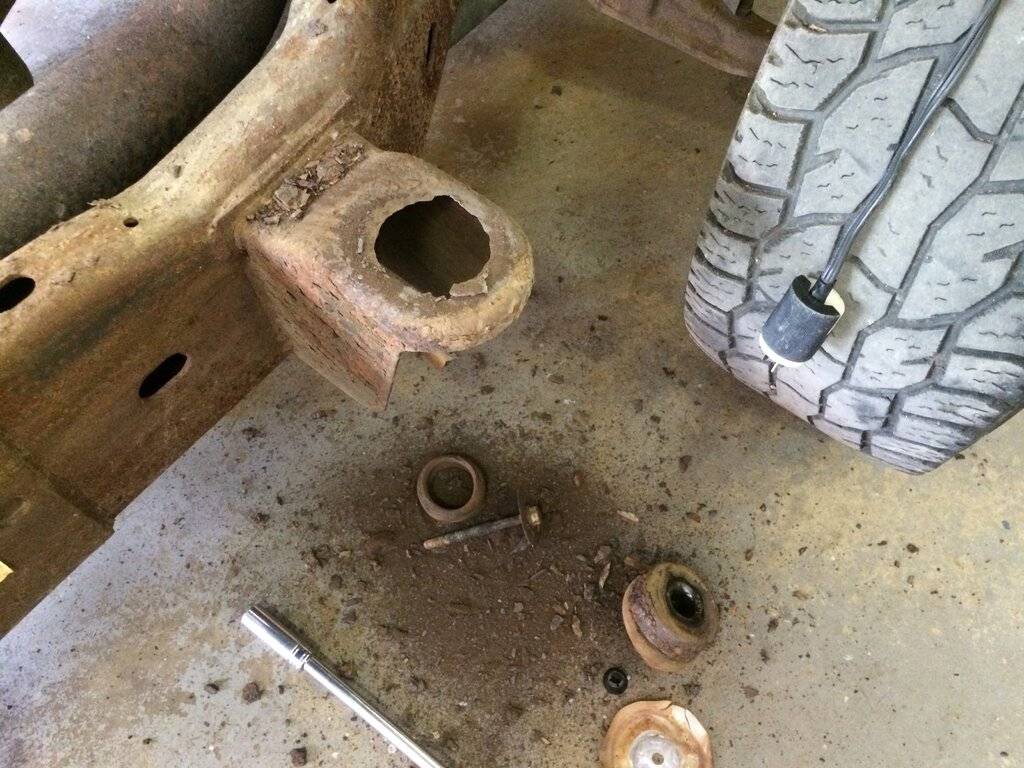

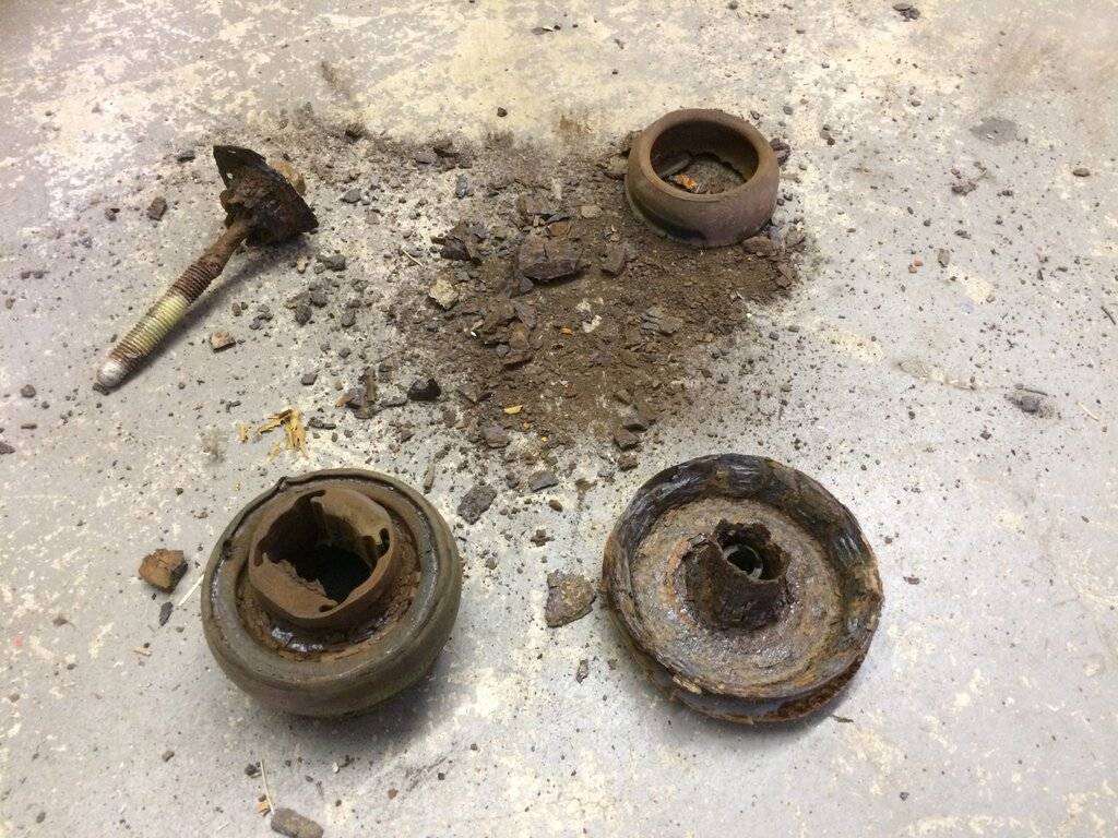

More rusty goodness.
Even worse on this side.
Think we're going to need some new mounts.

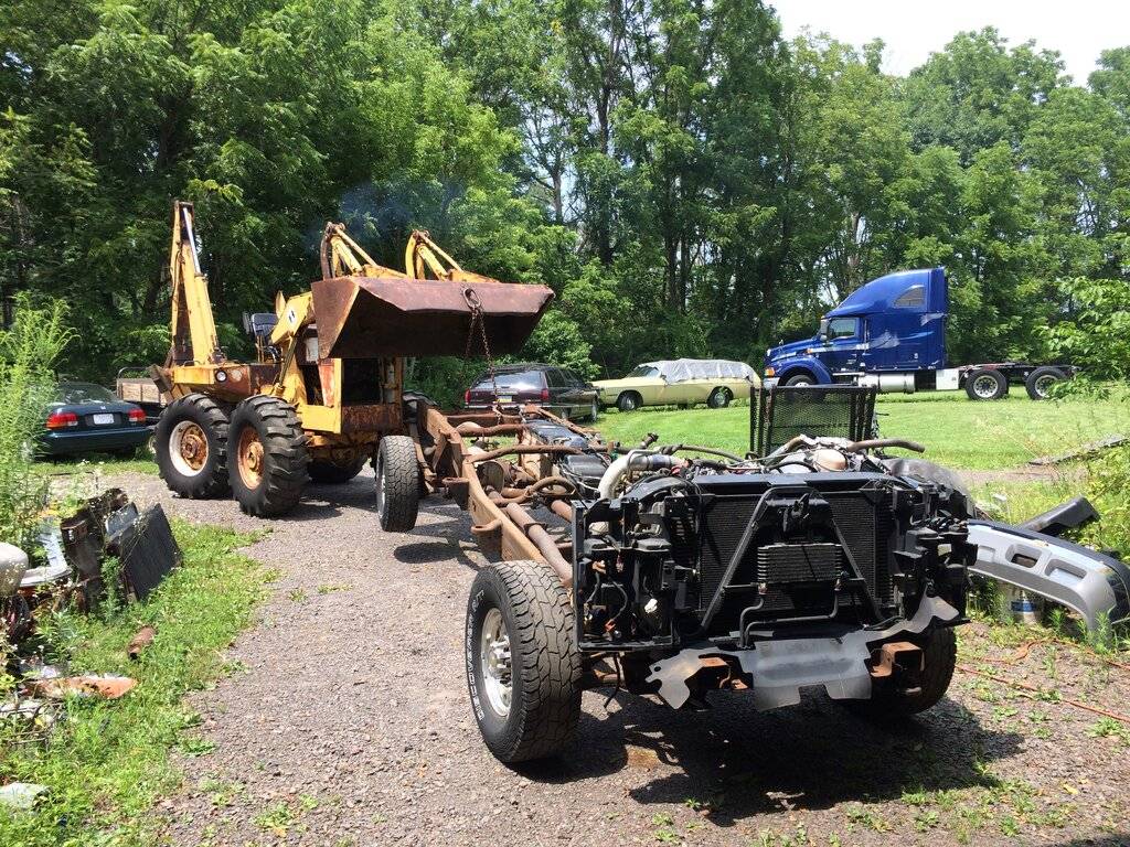

Out of the shop it goes.View attachment 482085

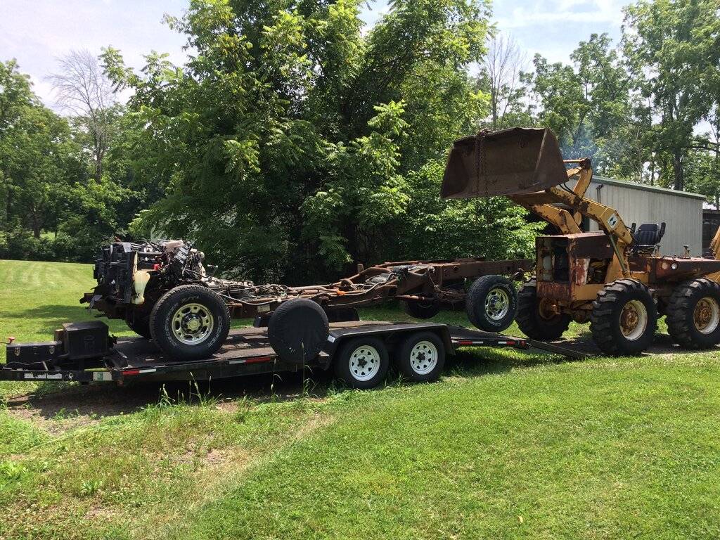

And onto the trailer.

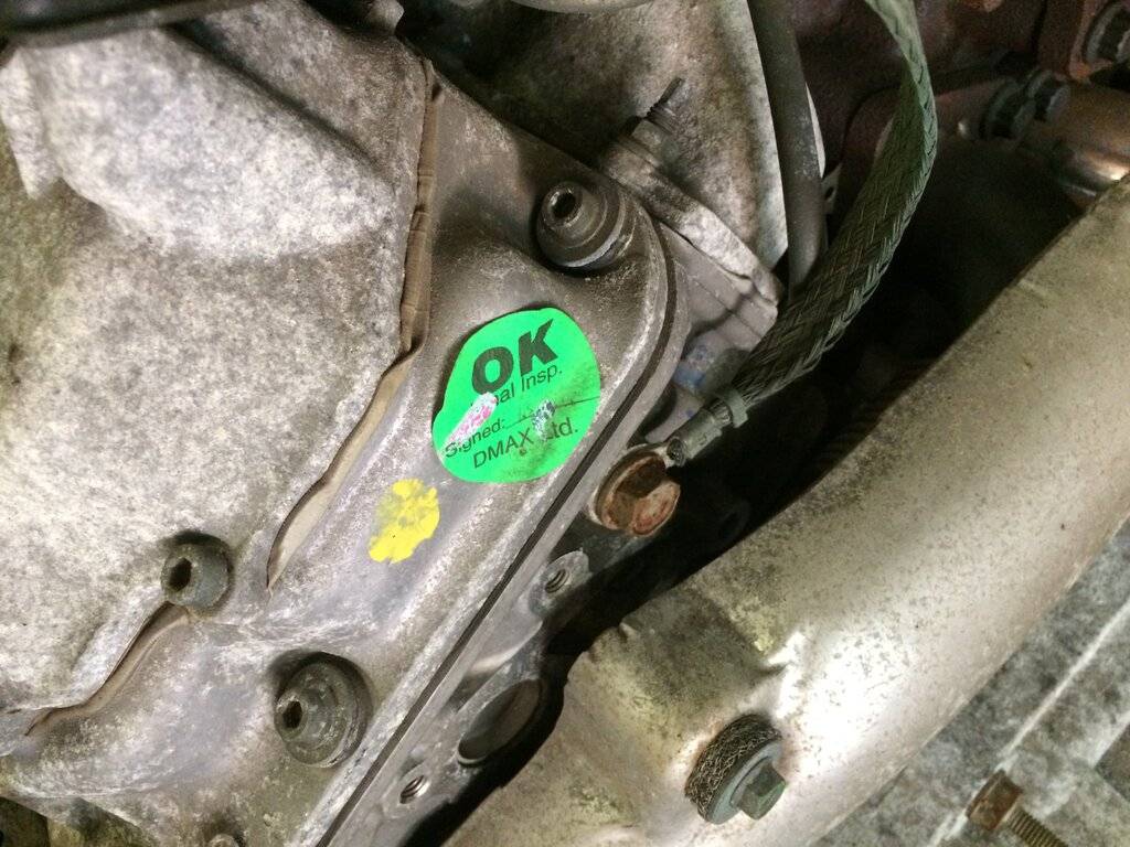

Paper sticker on back of engine outlasted the frame.

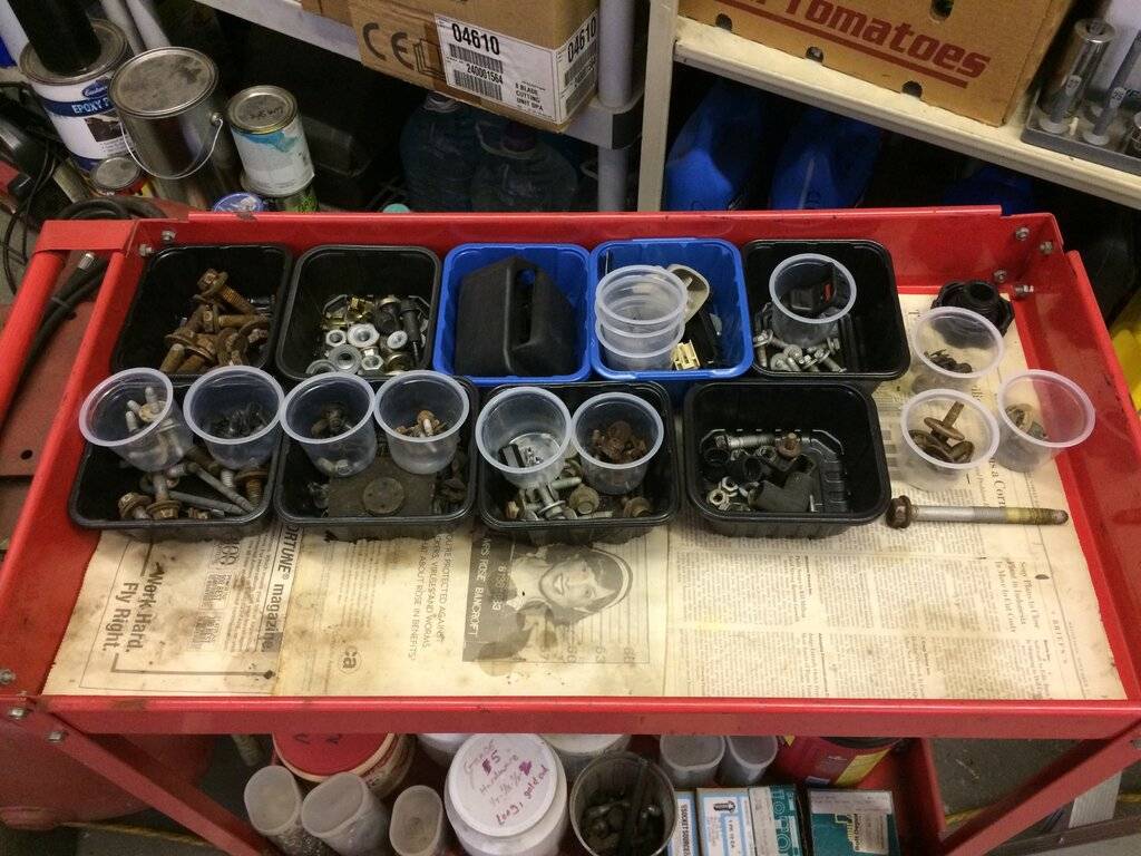

All the hardware removed so far.
Next episode will involve lots of drilling and cutting.
Jeff

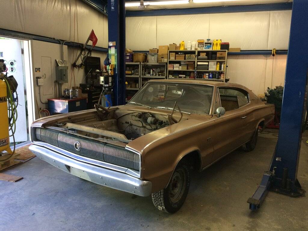

Originally, I was tasked with getting it up and running in order for the car to be put up for sale, but once he saw the car all cleaned up, he decided that he had to keep it. The engine had been pulled out over a decade ago and lots of parts along with all the hardware got lost. A different friend had much of what was needed and I scoured my parts boxes for the rest, along with some reproduction items that neither of us had. The engine was rebuilt at a backwoods machine shop in central PA. The first photo shows what I had to start with, and we had to scrounge up the rest.

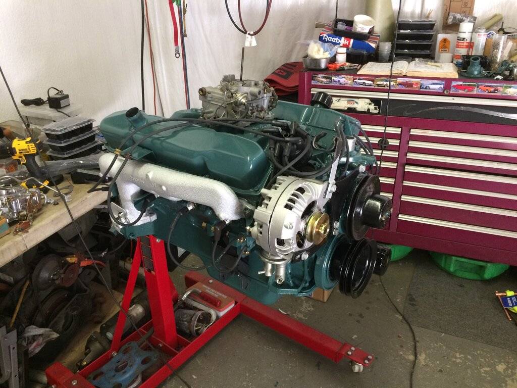

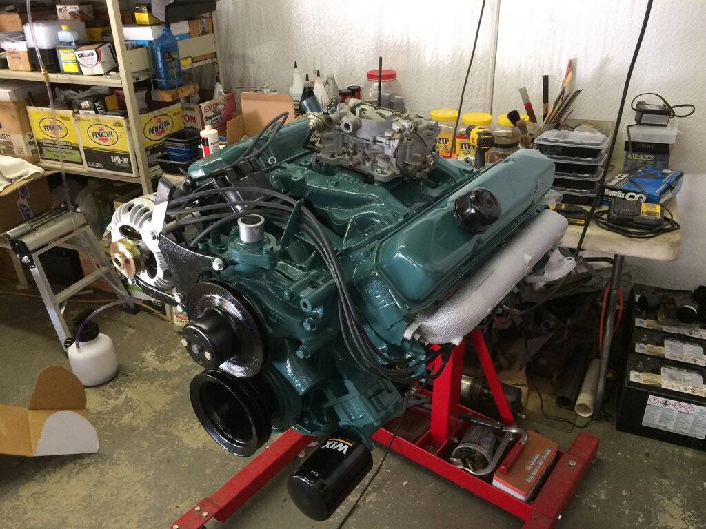

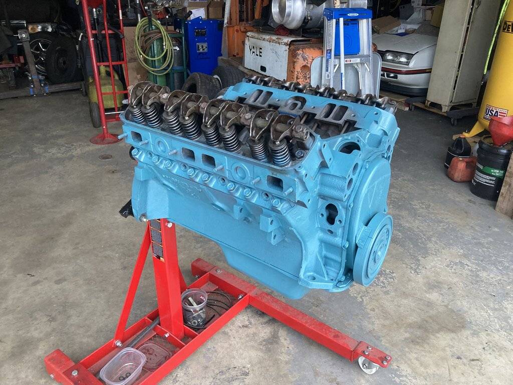

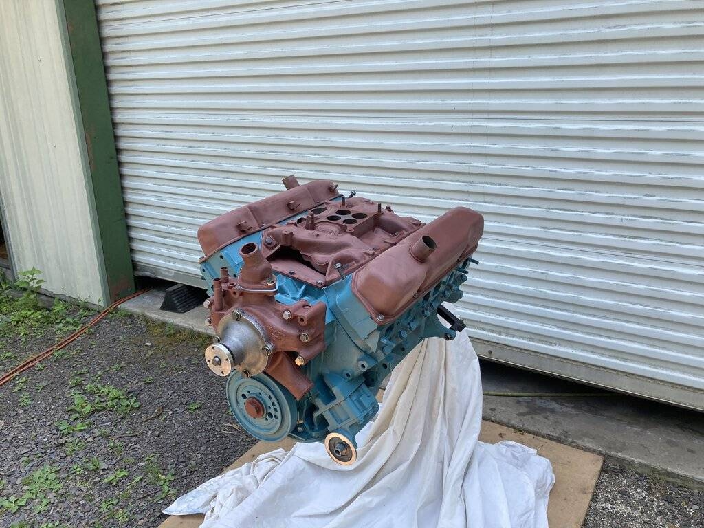

Mostly reassembled engine. A while back we had a big go-round on FCBO about Bill Hirsch's turquoise engine paint. People had me convinced that Hirsch had changed the formula to make it more accurate. Well guess what. He didn't. It's still the same sad gray-green that it was before. I'll never buy it again. The paint itself sprays beautifully, but the color is just too depressing, though I will say that it does look a bit better in direct sunlight.

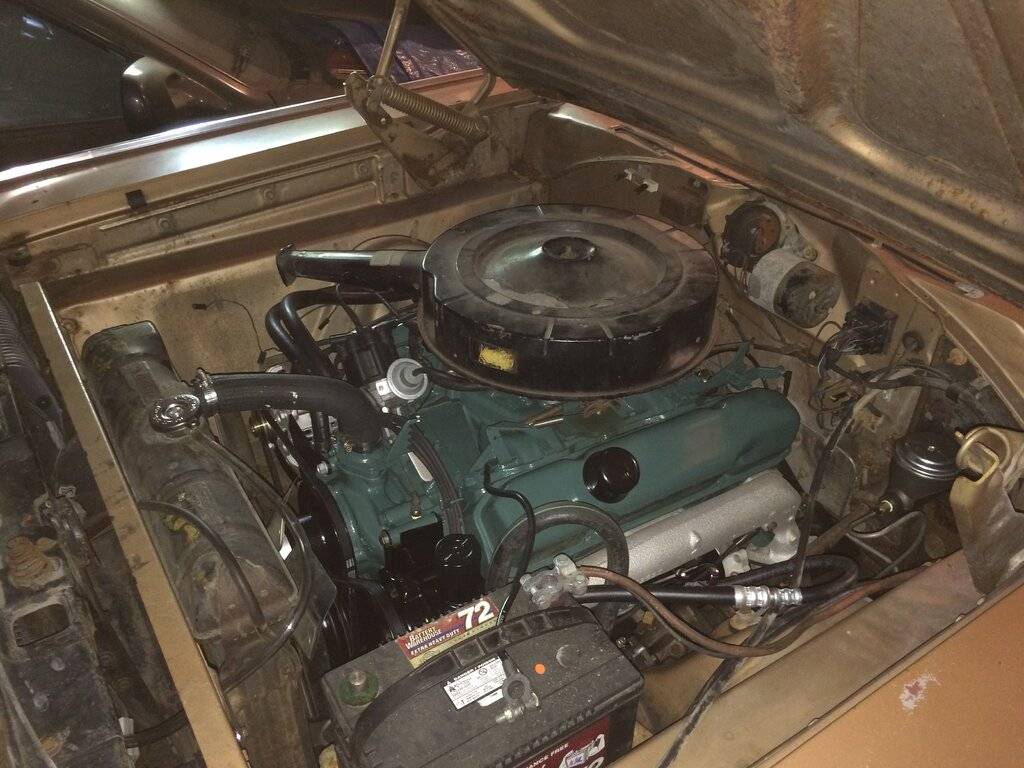

Somehow I never took a decent photo of the engine back in the car. This one will have to do for now.

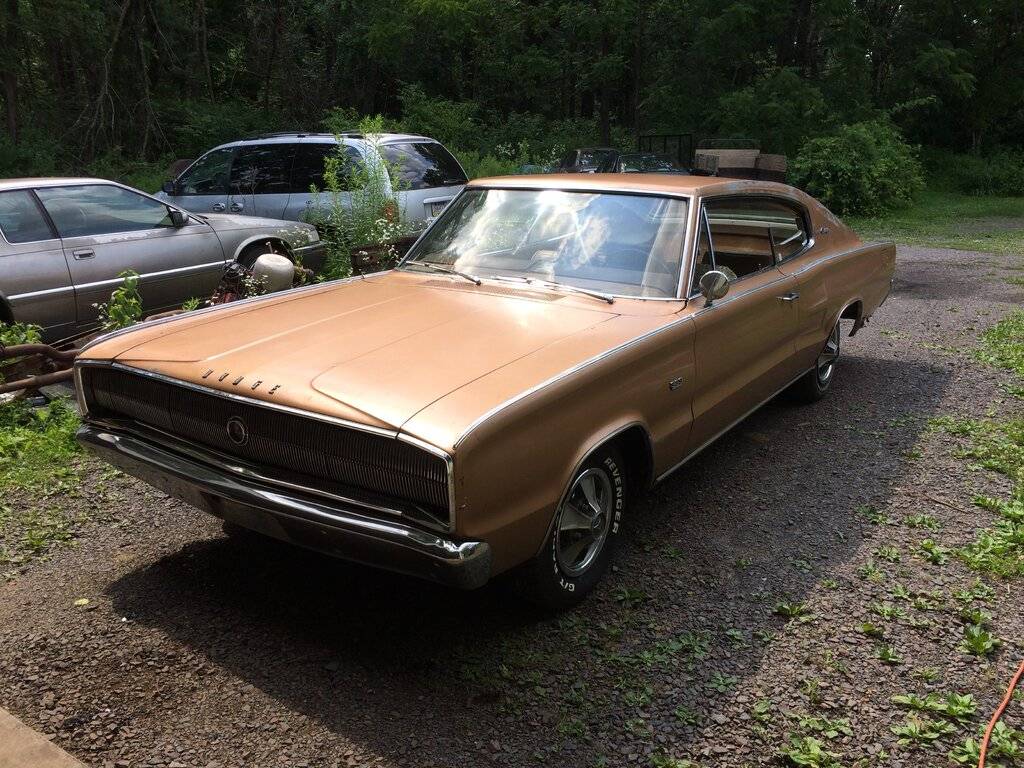

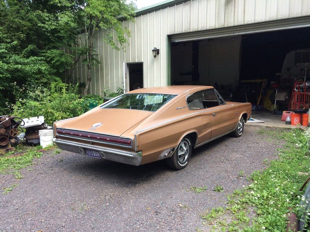

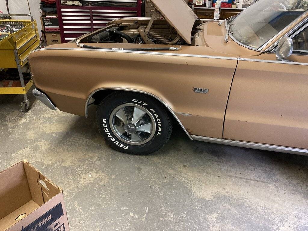

One regret was not running video during the maiden voyage. It was the first time the car had been on the road since 1979 and it would have been nice to have that trip on video. Other than the obvious rust, the car cleaned up quite nicely. It's all original paint and amazingly straight. It managed to survive 13 years of driving on Long Island without as much as a minor fender bender.
I was disappointed to find that the car had the optional fake mag wheel covers instead of the cool deep dish spinners. They were in the trunk, but I didn't have a key at first.

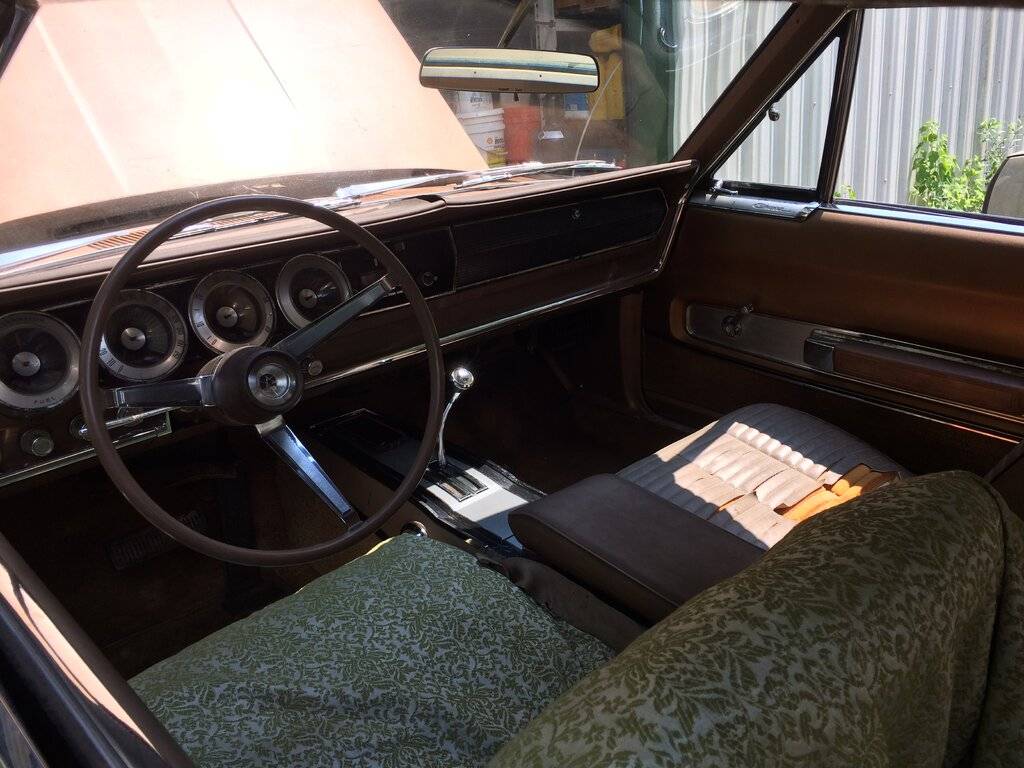

I don't have a good shot of the interior, but it came a long way from what it was like when it came in and how it is now. There were so many mouse nests in the car, and it, really, really stunk. The mouse urine had been so strong for so many years that it corroded a lot of the metal trim and the pot metal parts. The mouse nests completely filled my shop vac to the top and there was still more to go. One amazing thing is that the electroluminescent lighting on the instrument cluster still works, though I can hear some electrical zapping sounds coming from the cluster when it's on.

HI Jeff, so based on your experience what is the best procedure to spray a n engine, ie does one spray primer etc and then colour.
Even though the makers of the engine paints say it's ok to spray them over bare metal, I think it's best to prime bare metal first. The only exception would be the exhaust manifolds, where you're using a super-high temp paint.
Any type of self etching primer will work fine. Sometimes I use the green SEM self etch, and on the Charger I just used Rustoleum Professional red oxide, which is also bites in well on bare metal. Neither of these primers need to be sanded if you put your finish coat on within the specified time frame.

The manifolds are a used set that I got off of ebay. They've been media blasted and painted with VHT flameproof paint. I wanted the darker silver, but no stores around me had it in stock, though the bright silver is a nice contrast to the blah Bill Hirsch turquoise paint. I followed the instructions on the can to the letter and baked them in the oven to cure the paint. So far, so good. It didn't even discolor a little bit while breaking in the engine.
