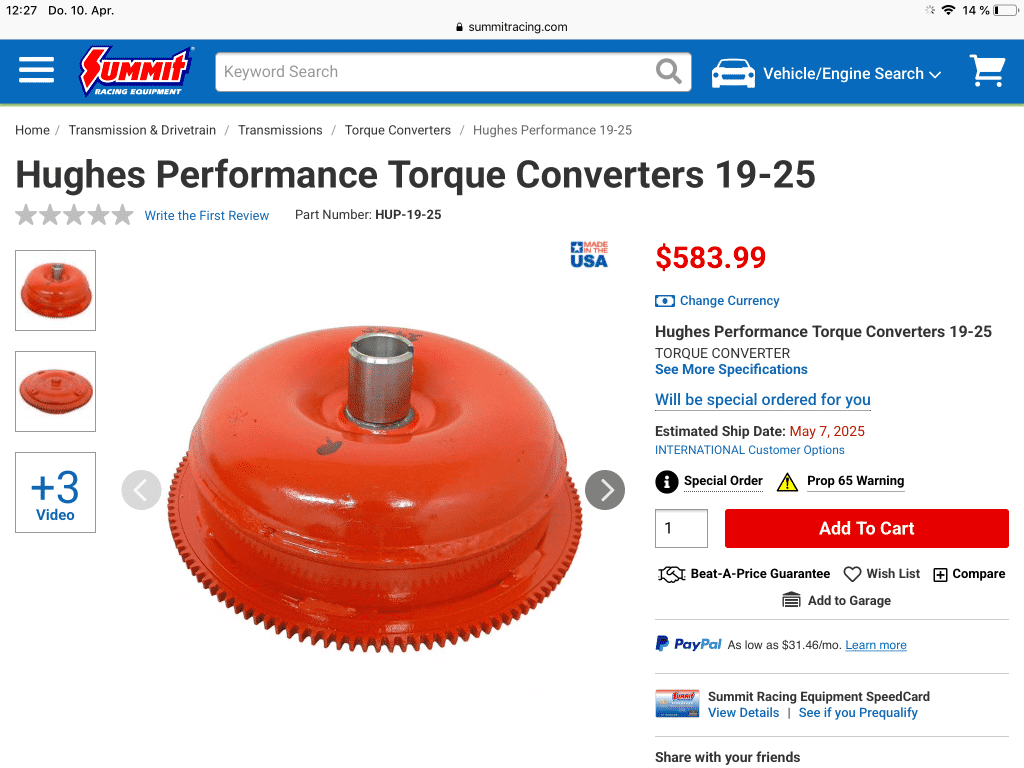

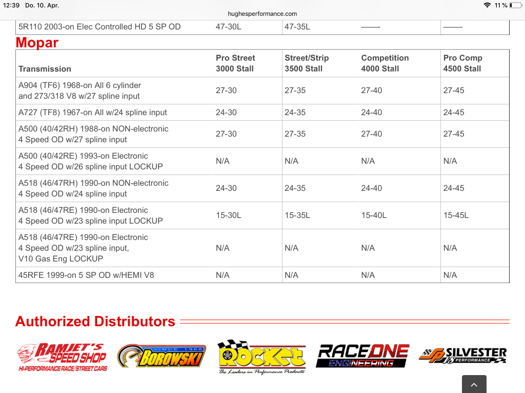

Using Google search I‘m finding Hughes 19 spline converters with 2000 and 2500 stall sold by Summit on special order, but these are not shown on Hughes website. There is no tech. Spec on summit site. That is strange.
Is anyone using this Hug 19-25 converter in a 65-66 C-Body behind a mild tuned 440 ?
