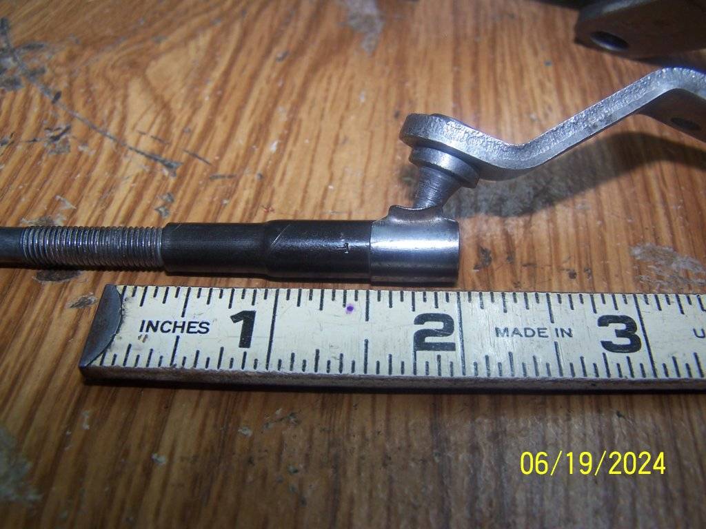

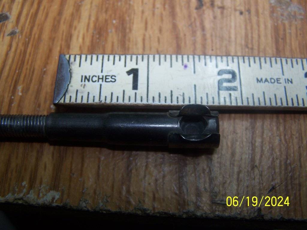

You still dealing with this?? I'm pretty sure your problem is in the snap on coupler that fits over the ball shown in my post #7. PM me your mailing address and I will send you one.
