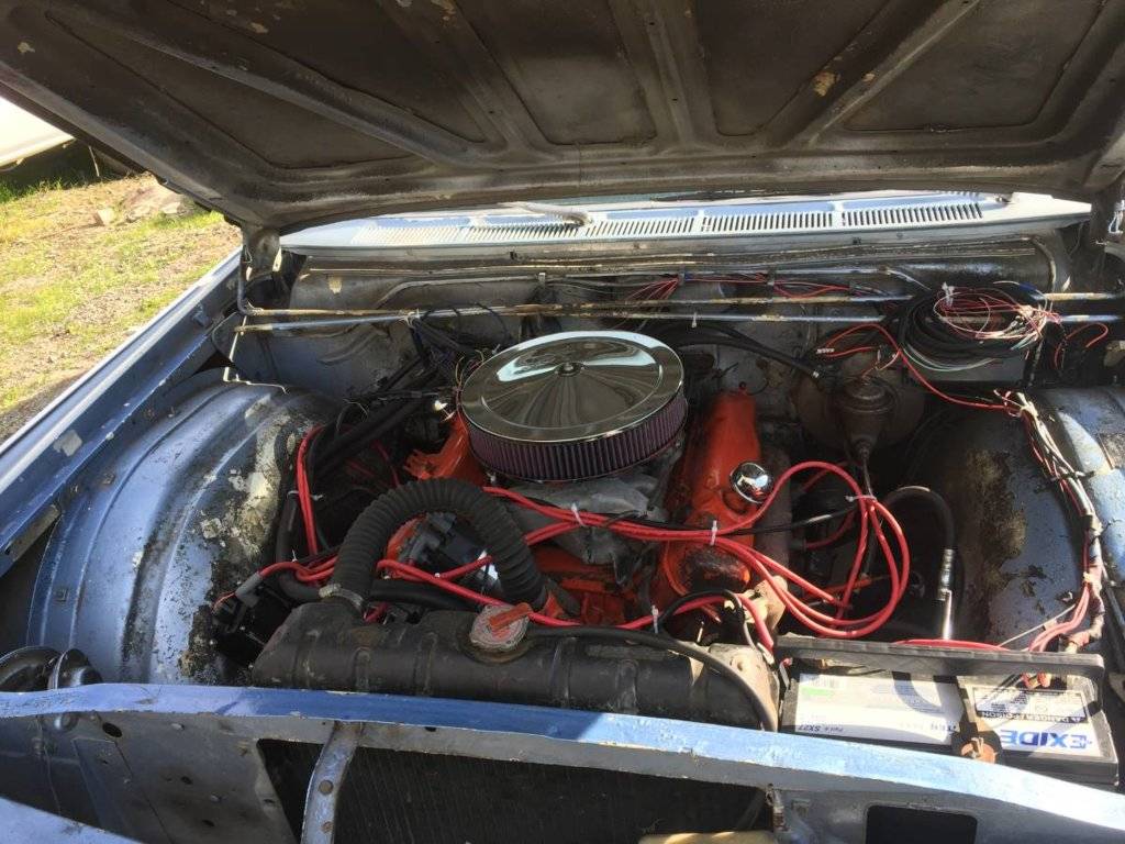

Saw this car today and the thing that caught my attention was the fuel injection claim. I see in the text that he is talking about the Holley Sniper EFI. So what is the info on that. Holley says pretty much any car with a carb although I see CFM starting at 800 and then much higher. Interesting nest of wires.

I wonder if he is talking about electronic ignition, as that appears to be in place. Car has an after market air cleaner and intake manifold with an extremely sloppy job of plug wire routing. I do not see any fuel hoses that would suggest this car has EFI.

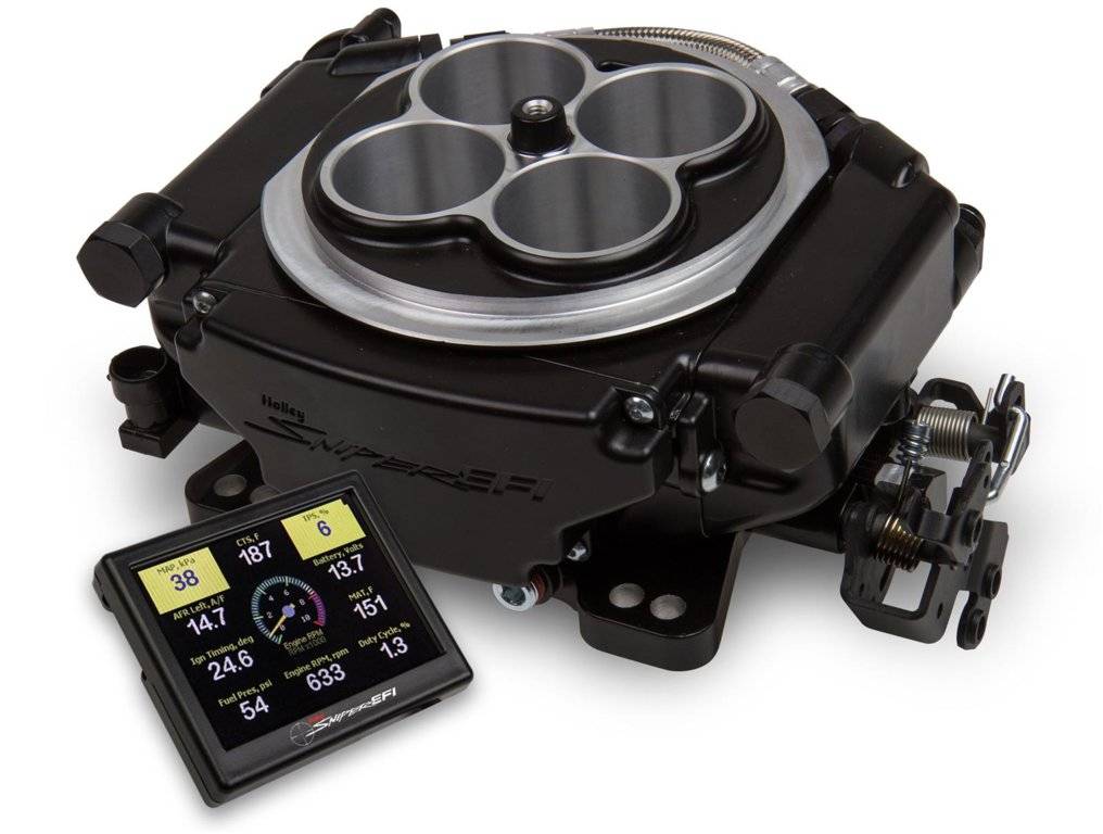

Apparently special fuel systems changes not needed.
  • Dual Pattern bolt on carburetor replacement, designed to fit 4150 Flange & Spread Bore manifolds - (Spread Bore Sealing Plate Part #9006 is recommended)
  • Throttle body mounted ECU – no extra boxes to mount
  • Supports up to 650hp with Four 100 Lb/Hr Injectors!
  • Only 4 Wiring Connections Required! (Battery +, Battery - , Switched Ignition & RPM)
  • Internal fuel pressure regulator eliminates the hassle of plumbing an external fuel pressure regulator (Preset to 58.5 PSI)
  • Integrated ignition timing control & coil driver
  • High Resolution Full Color Touchscreen for Initial Setup, Tuning, and Gauge Displays
  • Simple Calibration Wizard (Answer a few questions about your engine and it creates the base map, then starts tuning on its own!) - NO laptop required!
Can't really tell what is hiding under the air cleaner. Car has log manifolds and a single pot master cylinder, so I doubt that this car was built as a "Sleeper", but folks have done stranger things. Not sure what is in the box above the brake booster beyond the coiled hoses and wiring.
Dave
