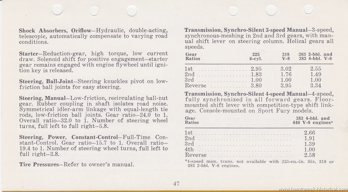

Wil: I too am wondering if the 440 was ever available in a Plymouth in '66. I never saw one or heard of one, back in the day - a hemi in a B-Body, yeah, but not a 440. If it was available, it had to be a late change engine-option.
I'm thinking they were a late production addition. The 440 had a "J" engine code. I have seen a couple.
66 was also the first year for the street hemi, not avaliable in the fury, which probably overshadowed the 440.
