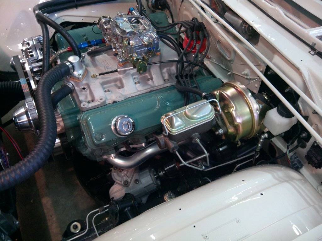

My car is an existing power brake car. So I'm not exactly sure about your manual brake car. But I am using an 8" dual diaphragm universal booster Performance World PB8531 Universal dual diaphram brake booster It will bolt in with minimal mods. And this master Performance World MC2912H Replacement master cylinder I'm in Canada so these are Canadian dollar prices.Okay, wilwood it is. Any master/booster assembly you recommend?
