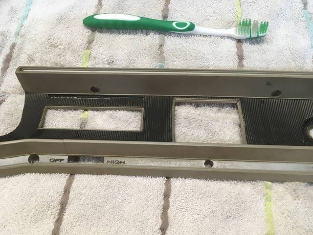

After installing a new radio and quartz clock conversion i’m cleaning the panel that covers both. I noticed that parts of the panel which are now bare beige plastic seem to be covered in silver paint on some places (above the words ‘selector’ and on the left side).
I’m wondering if the entire panel was originally painted silver, with black accents or if a previous owner repainted the panel and only masked off the readily visible part...

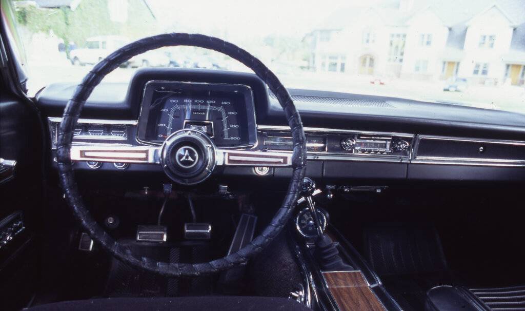

Does anybody have a photograph of how this panel should look?
thanks!
Kristof
The originals were never beige, but a combination of chrome, argent silver paint and semi gloss black. The beige is a combination of years of nicotine, and dirt/airborne greases. Add to that the aging of the original finishes and the base plastic yellowing and coatings wearing off.

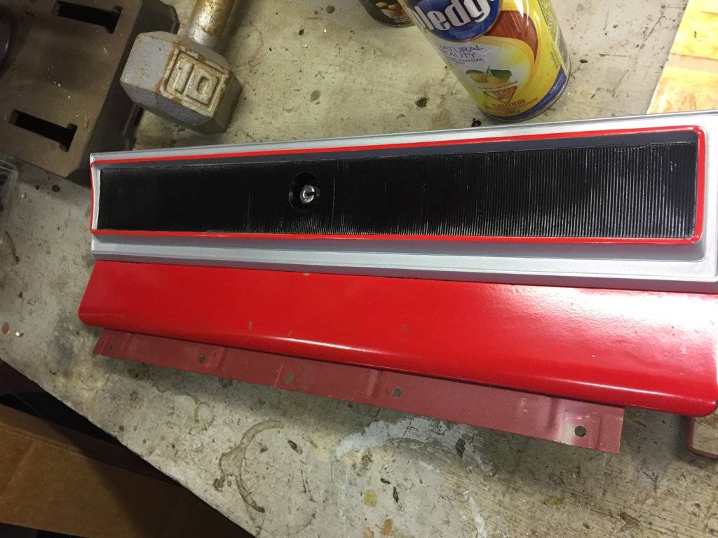

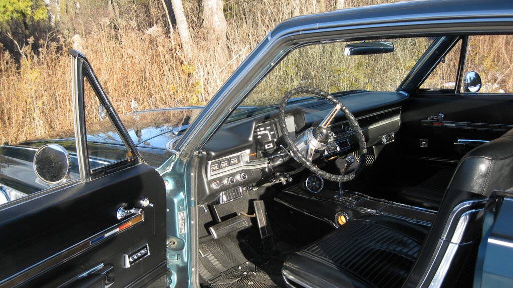

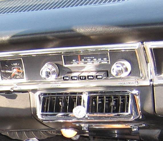

Here's some pics of the dash of my turquoise Monaco and my red Monaco.
Looks like they all turned out very nice. I have two radio delete panels so will send one of them out for re-finishing if I can find a place that does it right.

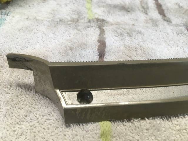

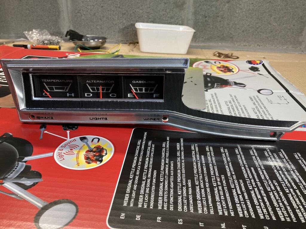

Just finished a spare left side gauge cluster. Quite happy with the results, altough not perfect. The chrome isn’t as shiny as it should be, but it was the best rattle can chrome spray I could find which would not rub off.
The glove box door is up next.
