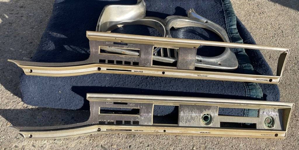

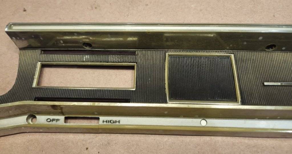

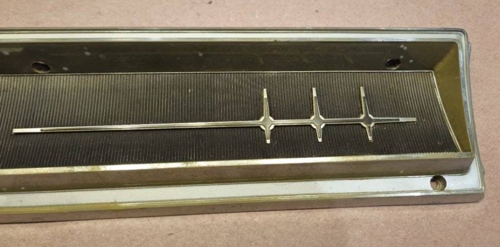

Attached is what I'm shopping for and the last picture is what I have if anybody needs it or willing to trade.

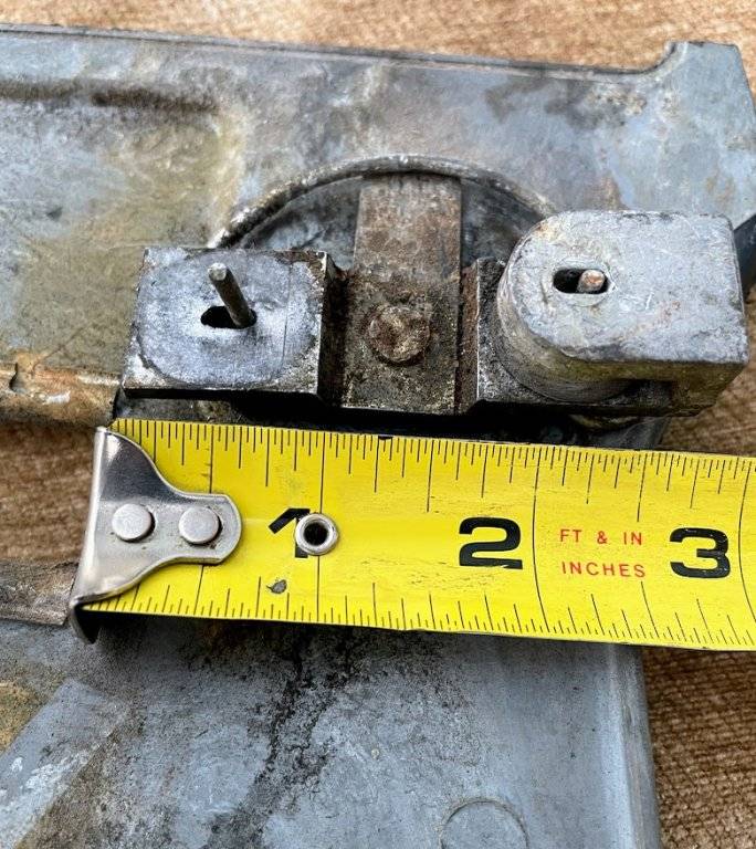

In addition I need a window guide for the driver side rear window. The guide piece is made of pot metal and should have 2 spools that guide the glass. One of mine appears to have broken off. It is riveted onto the rectangular piece so I will probably need the whole piece. Has anyone repaired the piece or made a new one? 3 D printer maybe?

Can't help you with the quarter window pot metal casting, but there's likely lots available out there in wrecking yards. Someone will have a lead.
Regarding your dash plate - firstly, the delete plate you show is for a NON AC equipped car, radio and clock delete.
The ones you have to trade are for a car with AC - and the setup for the controls is different.
Does your car have AC? Because if so, you need one with the AC controls' holes.

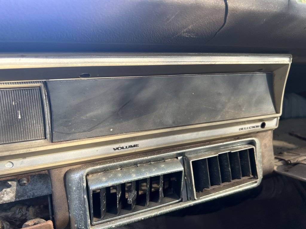

Radio delete with factory AC for 66 Fury/VIP is not listed in the parts catalogue to my knowlege, and I have only seen one car so equipped, and apparently its dash plate was cobbled together at the factory or the dealership - and if you look at the picture below, it's simply a plate that was adhered over the radio openings, since the VOLUME and SELECTION text is still there. This was a 6 cylinder with factory AC but otherwise a complete stripper that had no other options whatsoever.

Thanks for the reply and education. Yest my car does have AC but I was figuring that I could modify one of my existing panels and graft that control area to the delete panel with some careful dremmel trimming and JB weld.

Check out the wrecking yards as Ross suggested. When I was looking for 65 Fury parts here in Phx. I ran across several 66'S. I know several of the 65's I salvaged parts from had the guides and they may also fit the 66.
I assume 65 window parts would be the same. I can look tomorrow. The dimensions are very helpful. Someone is making the rollers now. It was on an old post FCBO. But let me look for what I have. I have a 65 radio bezel like what you are looking for, but they are different than 66. 66 is curved and 65 is straight.
