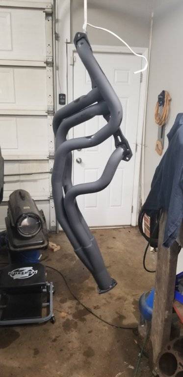

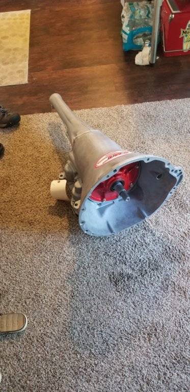

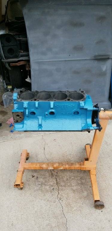

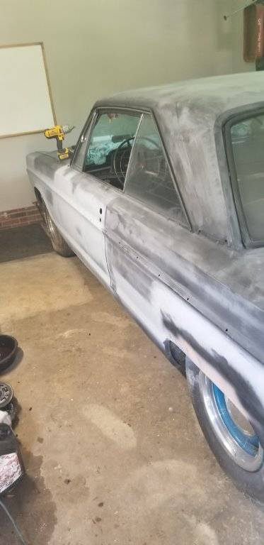

Well a couple years ago I got ahold of this 66 fury sport. No rust running driving car. The deeper I dug the more I found that I did not like. So now two years later I'm married moved to another county and still working on my old Plymouth. Car is originally 383, 727, bucket seats, console shift, manual drums, power steering, and no ac. Now it's a 30 over 10.7 to 1 383 with dome tops, tti long tubes, 521 286 cam, eddy alum heads, disc brake, not finished yet work in progress pain in the butt. Lol

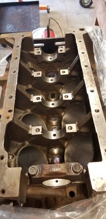

Be sure to check the piston to valve clearance with that cam and the aluminum heads. Most of the aluminum heads will require some milling of the pistons for a high lift cam and some will require some milling to clear the piston tops where they meet the chamber of the head. At 10.7-1 compression, you will probably need to run non-ethanol aircraft grade fuel to keep it from pinging.

Clearances are not an issue on this motor however they have been double checked just to make sure. When I started my factory pistons were a hundred thousandths down in the hole. I didnt want to mill that much off the block and heads and intake to make everything work and have decent compression. So I milled just enough off of the deck to even it up side to side and front to back then the dome tops with valve reliefs and small chambered heads and a thin gasket gets me 10.7 to one which tuned right I can run pump gas or I can use thicker gasket and drop the compression a little and be safer on pump gas. And as far as aviation fuel I'll pass its leaded and very very similar to kerosene. I am building my entire fuel system to be safe for ethanol fuels so I could go e85 with some carb changes and I have e85 everywhere around here but that limits me driving it because it's not readily available everywhere which I found out with my pickup.
