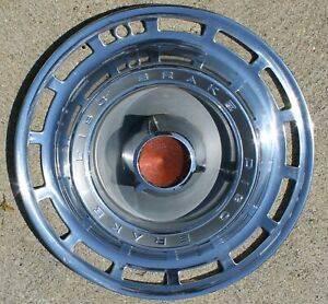

Hi all,
I am increasing my wheel size from 14-15 inch. I want to run these 1966 'disc brake' style hubcaps (see below), but I am not sure what wheels they will properly fit on. Can anyone point me in the right direction?
Best,
Cameron
Those covers will work on just about any 15 inch wheel.
It shouldn't be too hard to find some used 70's or 80's mopar rims at one of your local salvage yards. Just keep in mind that pickups and vans went to a larger bolt circle at some point, maybe 1981, so don't buy any of those.
