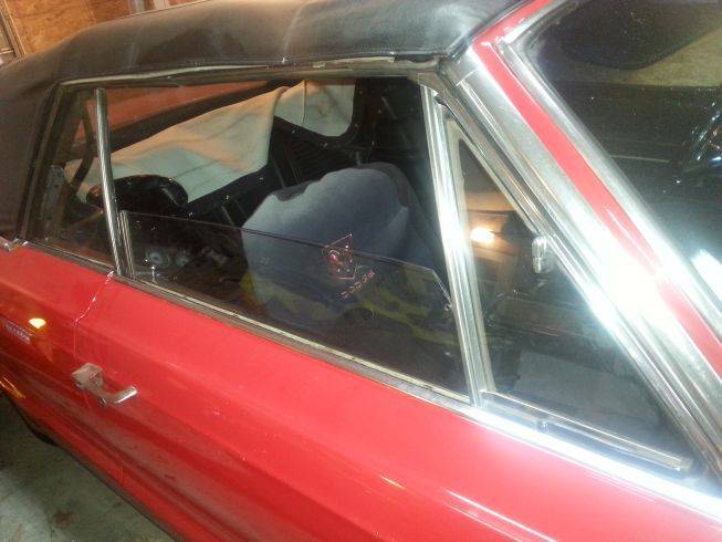

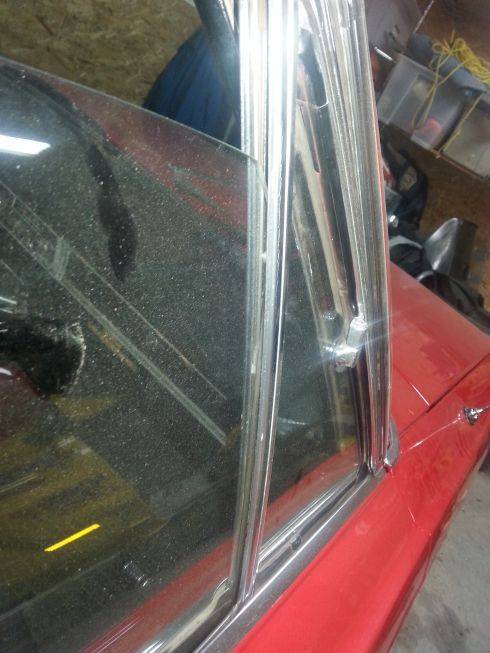

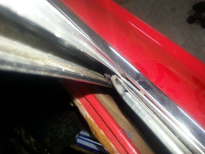

Please see attached pics. 1966 Dodge Monaco Convertible(canadian)
You will see in one of the pics, the hole in the glass for window in PIC 2.
I need to find the piece that goes in this hole that holds the front of the window in place but Im not sure what Im looking for and what else is missing.

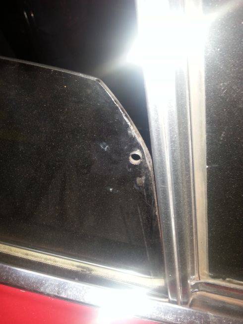

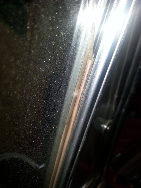

If you look at pic # 5, it shows the driver side window which is ok, and you can see a guide around the front edge of the window but it seems to be missing on the broken window see Pic # 3.
I have been looking online and found some some sites out there that sell some window parts for these old dogs. But I have noticed there is not much out there for C bodies.

This is the kit as sold...
http://www.ebay.com/itm/361089044066
This is for one side only, you would need to get two to do both sides.
This is a good price.
Probably available still through Chrysler, Part Number: 1-02932230
Alan
Hi Alan
Wow, this looks like what I need. Thanks very much for the link. the biggest challenge finding this thing was knowing what to call it.
Cheers!!
Glen
