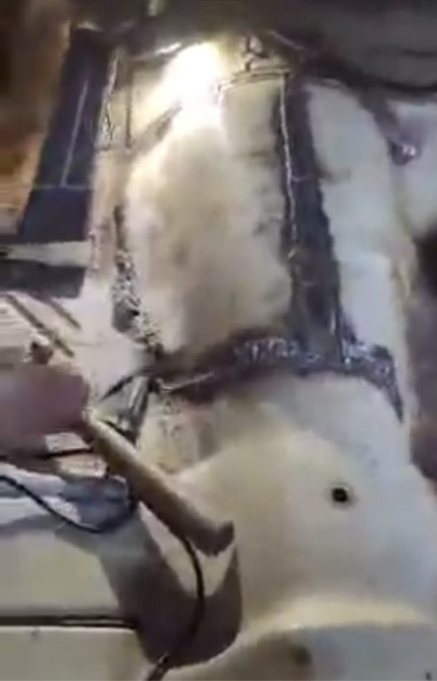

By no means can I take credit for this my good friend knocked this car out of the park.
So the tunnel was cut in a H Pattern and filleted open about a 2 inch strip down the center was added. All unnecessary tabs beret cut off the trans. Still fits the factory carpet! The only picture I have of the tunnel looks like it was taken with a potato. Next time it’s up I’ll get a better picture.
The transmission is a tight fit for sure but that modern 8 speed is so nice!
