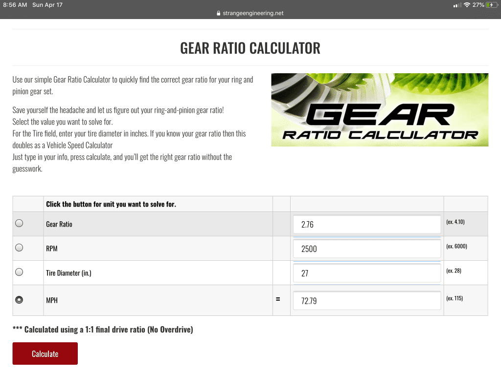

Use this calculator to see the rpm at any speed you choose Click the dot next to mph and then enter in different rear gear ratios to see MPH
Gear Ratio Calculator - Strange Engineering
