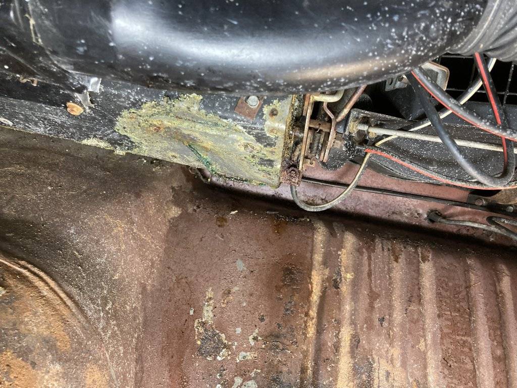

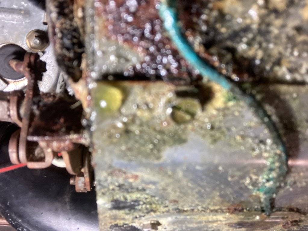

Walked into the shop and found a puddle under the 66. Long story short, I found a leak coming from the bottom of the heater box. It is a good thing that I have all the carpet already stripped out. So, I have a couple of questions:

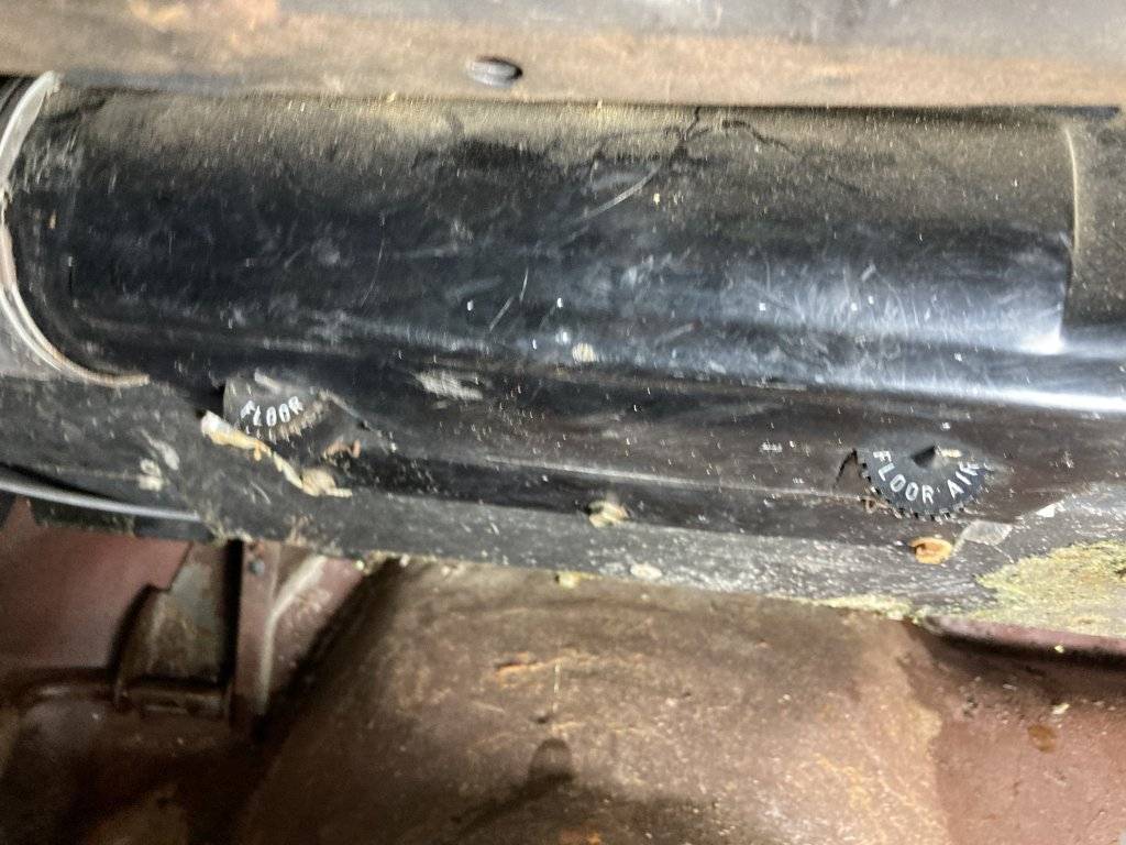

You got the AC version, I've seen a 1965/66 (no AC) heater box on CL for sale quite awhile and it looks just like my 1968 Fury's so I'll bet they were the same through those years (Chrysler did things like that)
But looking at your limited pictures of your AC box it looks just like my 1968 Fury III wAC. I lucked out on my leaky heater core in that car as it's a 2 part core with hoses that connect the 2 cores in the box and it was just the interconnecting hose rot causing the leak.

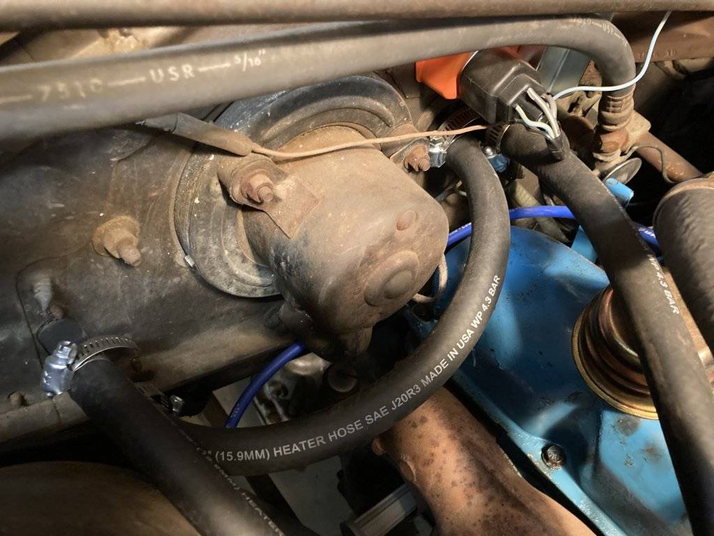

Thanks for the comments. I did the by pass as recommended. I will need to think more about pulling the box out.
