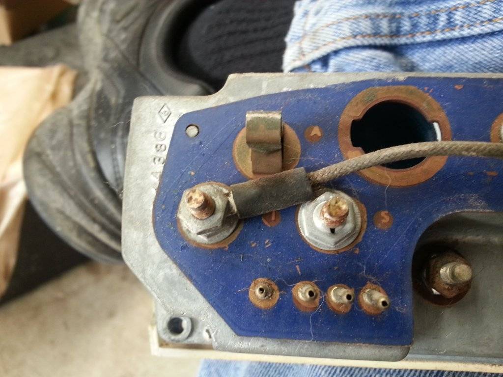

I have a new temp/amm/fuel pod and a service manual.
Does anyone have a pic of the proper wiring in the back of the pod? Mine is a bird's nest.

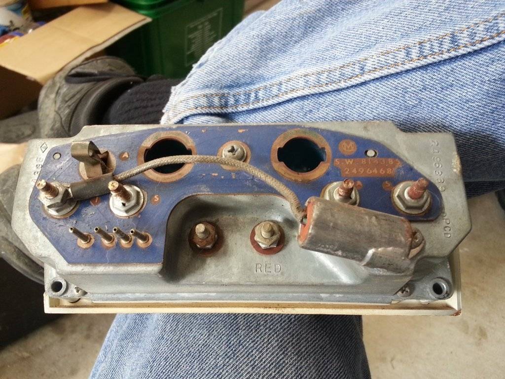

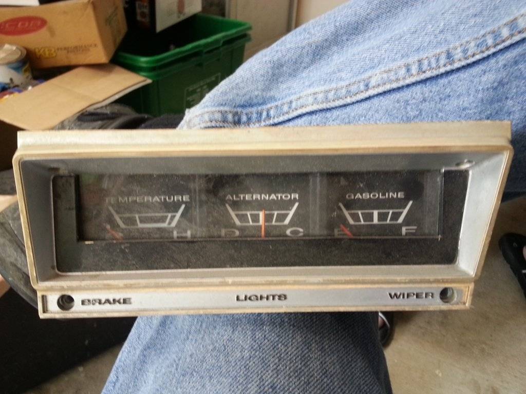

I did replace my gauge cluster tonight with one I found here locally.
My original cluster of gauges had been so butchered over the years that nothing but the ammeter could ever work again.

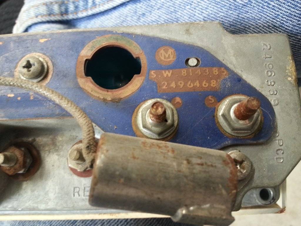

I still had to jumper a couple of wires to make everything work, but it seems obvious that someone in the past did not know that there was a voltage reducer built into the fuel gauge.
Also they scraped the printed circuit board off and tried to hard wire everything (which could have worked, had they done it right), but it was completely botched.
Oy va. :eek:
