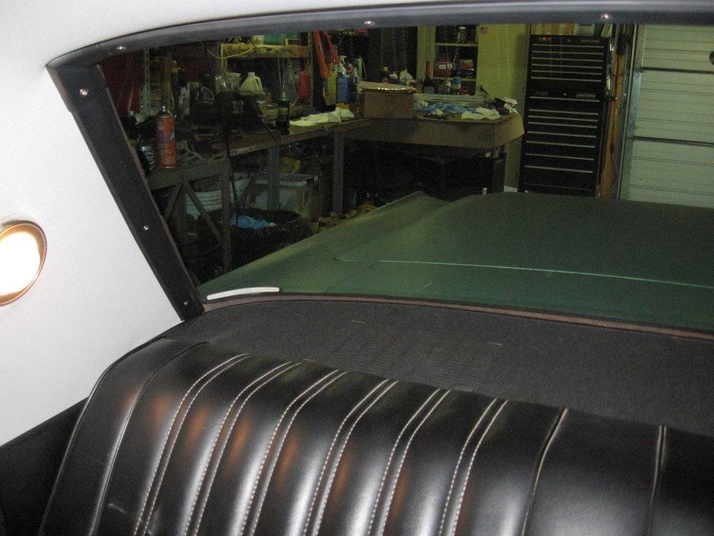

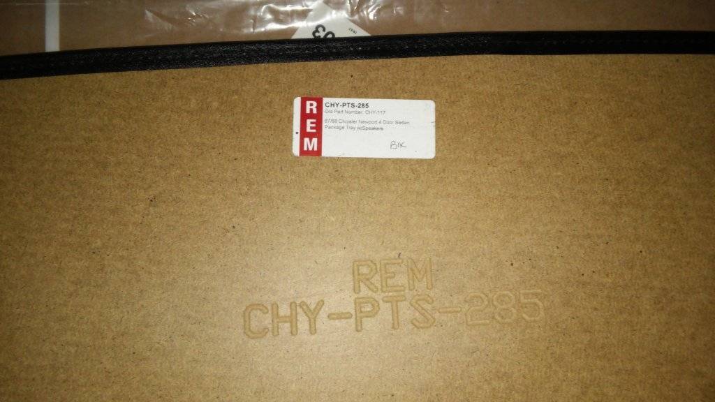

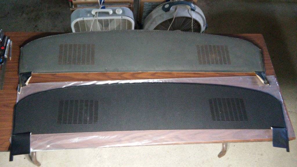

Now that I've figured out the pic posting on the new format, I figured that I would post the last part of this project: the package shelf and trunk divider behind the rear seat.

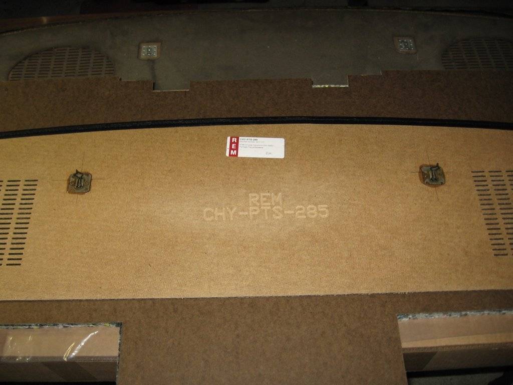

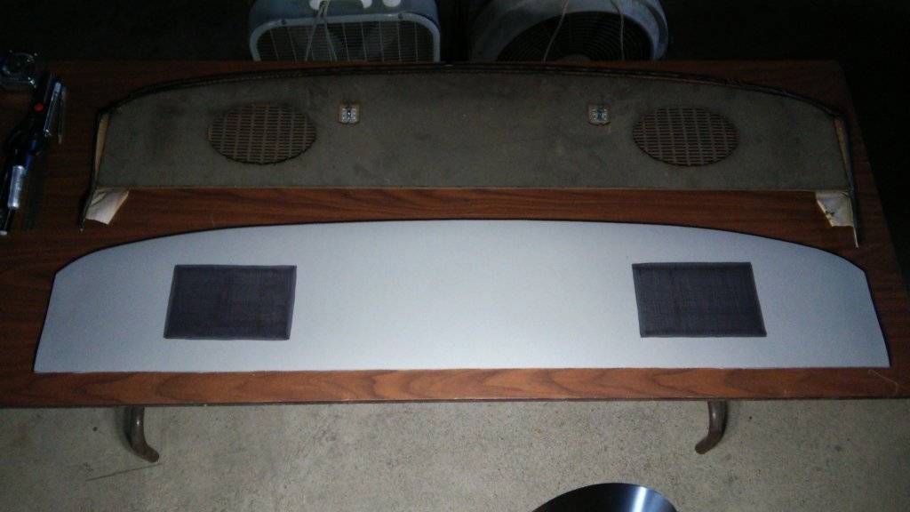

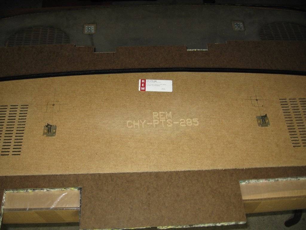

The package shelf is made by REM;

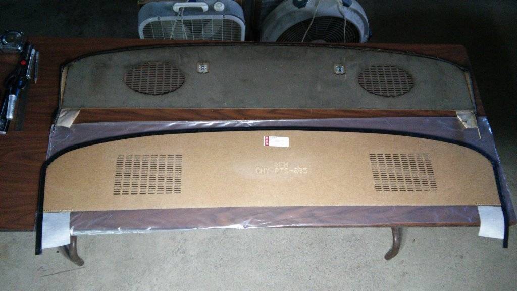

Original compared to new-topside:
Original compared to new-bottom side:

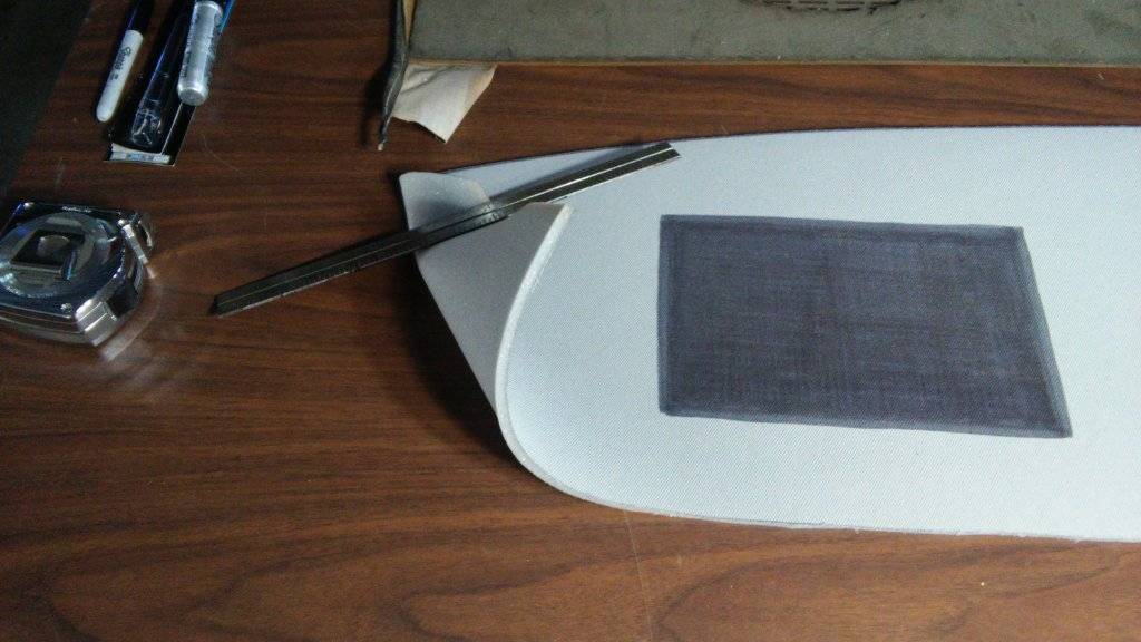

The new one did not come with the anchor clips or sound deadener so I transferred to clips from the original and bought a piece of deadener from an upholstery guy.
This car doesn't have rear speakers so I left the new deadener solid and used a sharpie to darken the area under the speaker slots. It's almost 3/8" thick foam:
I used epoxy to install the anchor clips the the new package shelf:

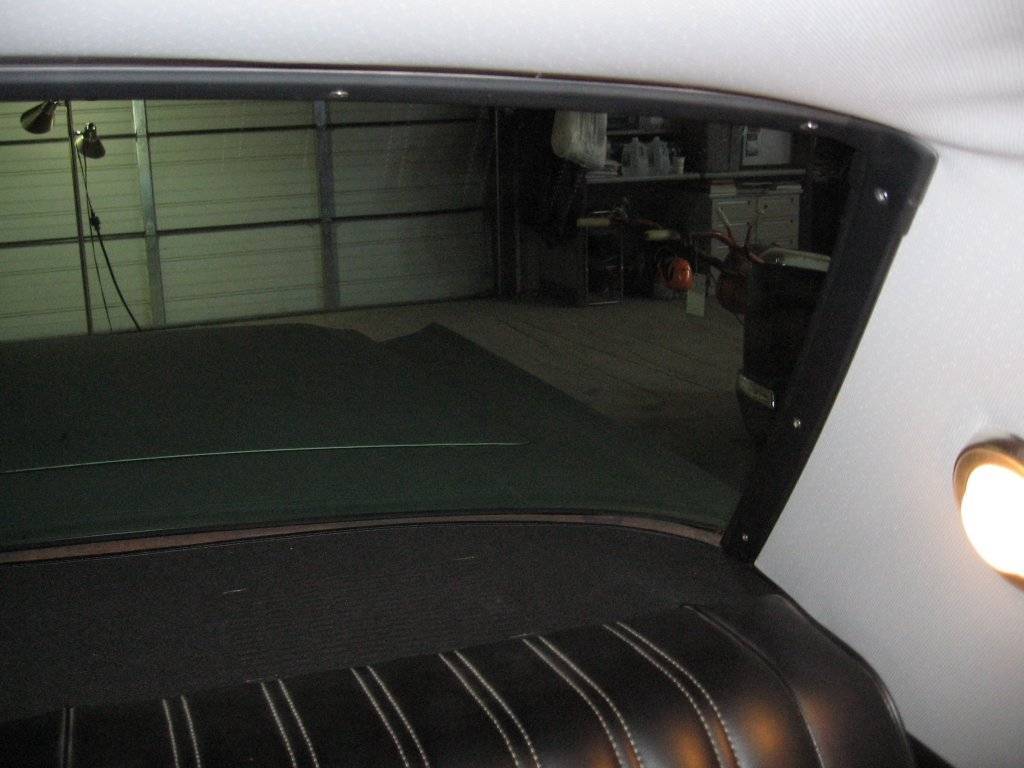

I laid the sound deadener in place and then dropped the package shelf on top. I put a thick folded up towel above the anchor clips and smacked it with my fist. It went in easily.

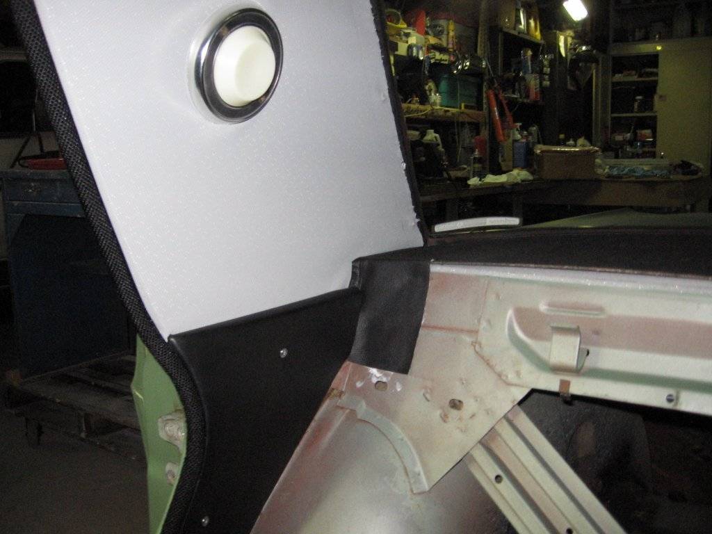

The flap on each side goes under the quarter trim:
FYI, the package shelf has to go in before the rear window trim.

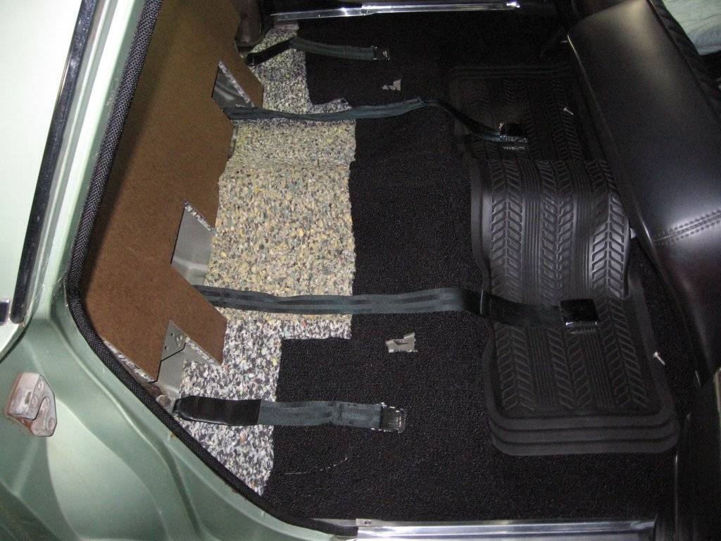

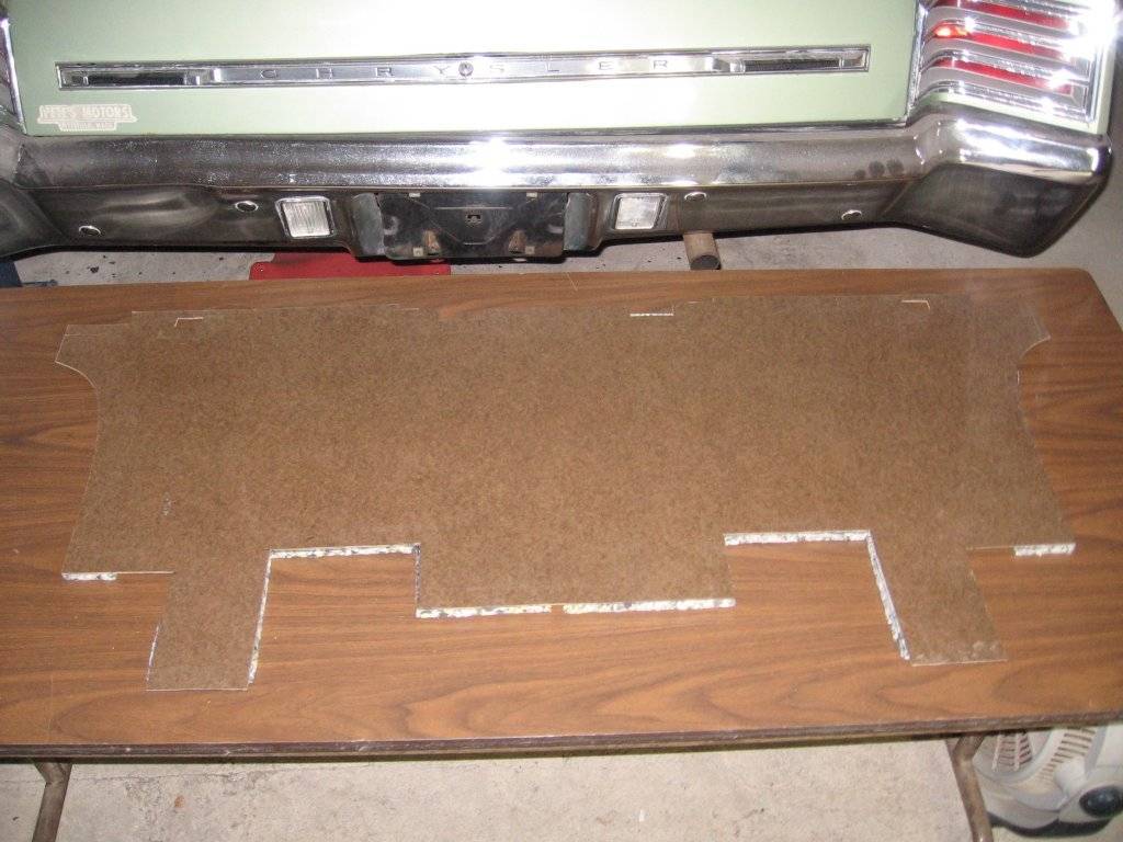

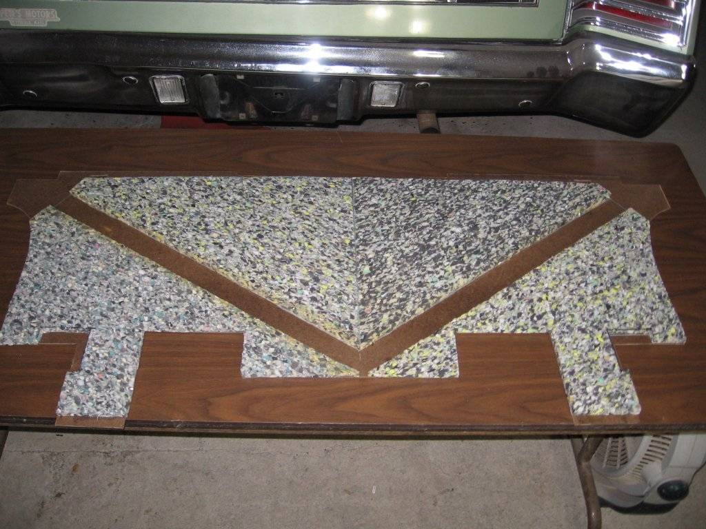

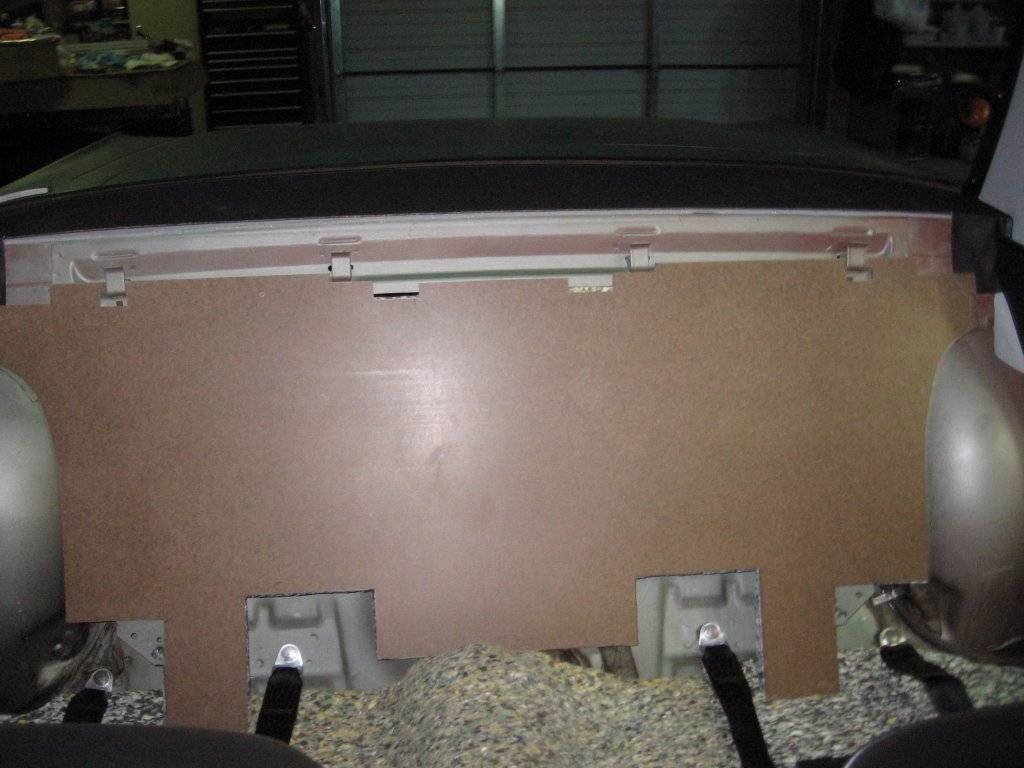

I traced out the original trunk divider on a piece of 1/8" tempered masonite and cut it out with a jigsaw:
Then I installed it, climbed in the trunk, and traced around the supports. Took it back out and glued some carpet padding to the backside:
Reinstalled:
Next I lined the floor with more of the same padding. It's just laid in, not glued/anchored. I figured every little bit helps to quiet things down.

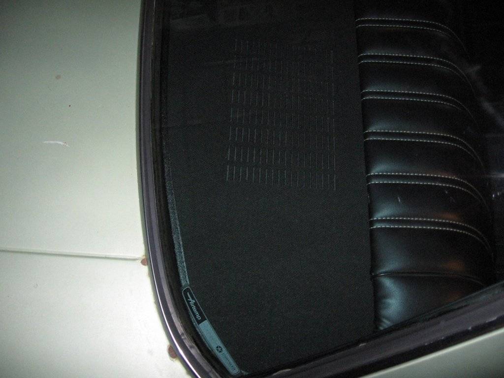

Then I installed the rear seat back from the Custom 4DSD:
Overall, I was very pleased with the quality and fit of the new package shelf.

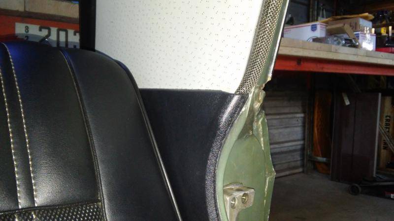

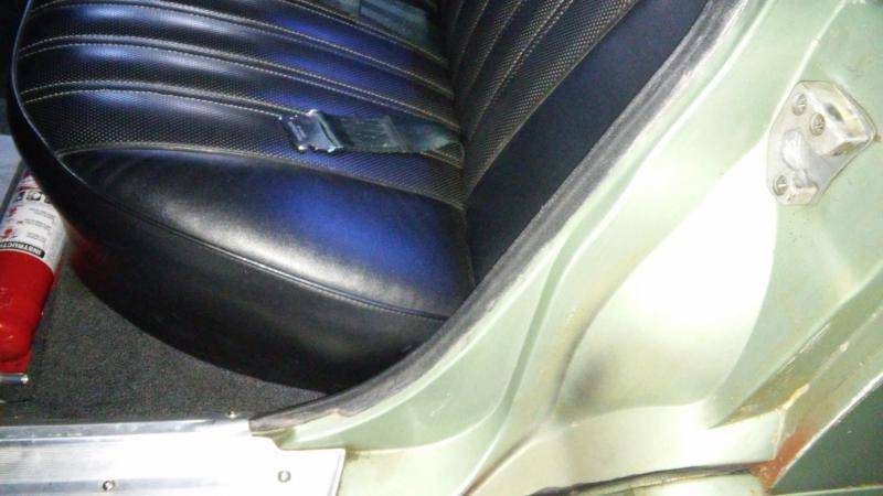

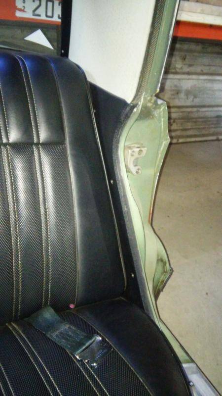

View attachment 50692View attachment 50693View attachment 50694View attachment 50695I'm replacing the headliner in the 4DSD after evicting the mice. I have the entire interior removed. This car had all the windlace removed when I bought it.
After comparing it with the Custom 4DSD, I realized there are two different kinds of quarter trim.
The Newp has/had windlace all the way down to the rear sill plate. The Custom stops at the beltline.
The Newp has a quarter trim panel similar to a door panel. The custom has a plastic trim panel similar to the cowl kick panels.
First three pics are of the Custom. The rest are of the Newp.

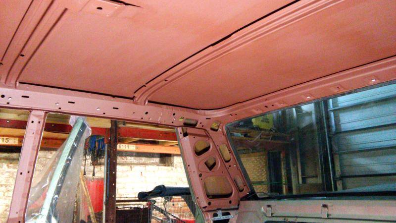

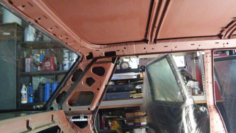

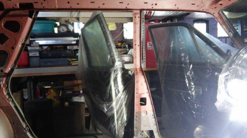

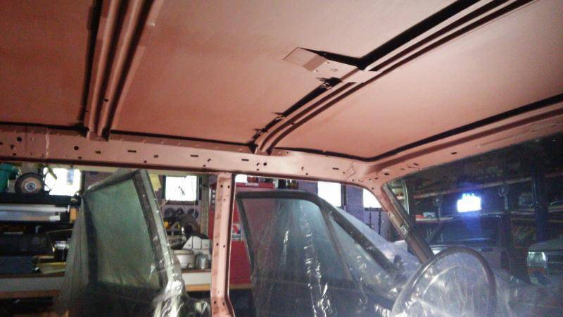

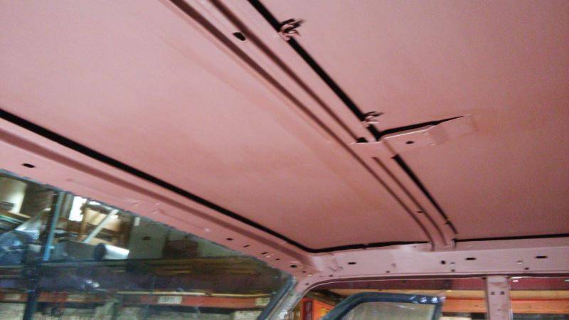

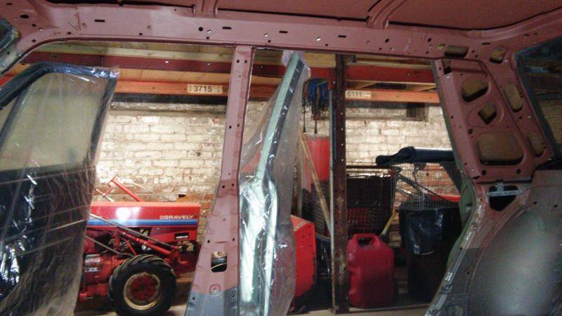

So I finally got back to this project. Got two coats on the roof and scrubbed everything else down.
Started cleaning up some trim as well

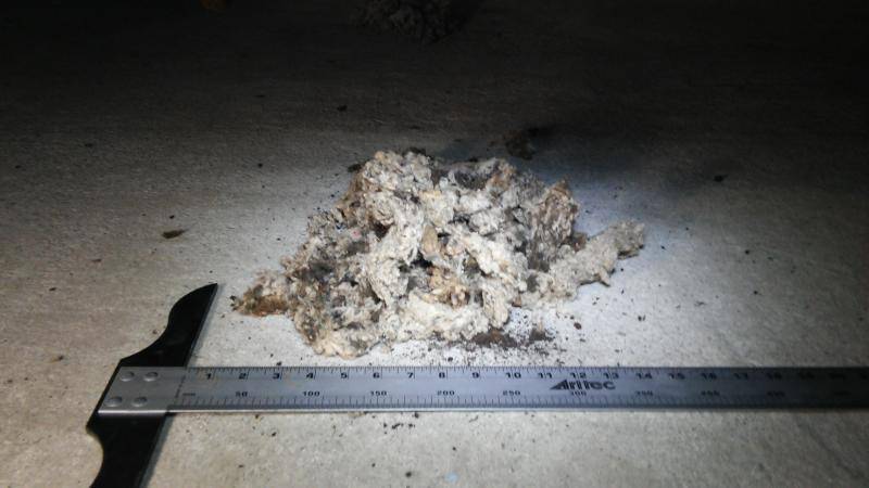

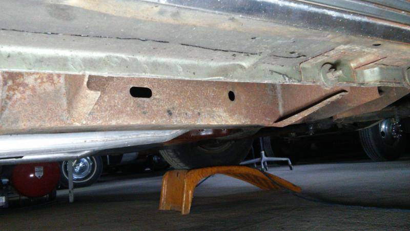

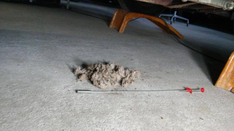

I put the car on ramps and jack stands to get a look at the underside of the front floors. When I got down on the creeper I was getting a whiff of mouse house still. (It was very humid here today)
So after probing these two holes on the frame:
I found this on the passenger side:
Which was nothing compared to what came out of the driver's side:
I pulled all of that stuff out of those holes in the framework. The last third of the driver's side was damp and really stunk.
I pulled a much smaller amount out of both sides under the trunk as well.
Once I get the interior back together, I'll put it on the lift and do a proper and thorough cleaning of all the under carriage nooks and crannies.
So I'll be checking the cowl vents and heater box as well now.
They are industrious little b*st*rds.

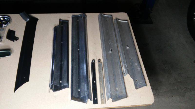

What did you spray on the roof and how did you polish the door sills?
I brushed on Rustoleum Rusty metal primer on the roof and pillars. I've had good results with it in the past on many projects.
I used this on the door sills:
Eagle One Nevr-Dull® Wadding Polish
A fair amount of elbow grease will produce good results.
