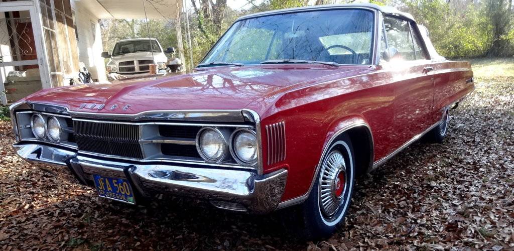

Simply gorgeous. I agree those wheel covers really suit the car. You've absolutely nailed the look in my opinion.

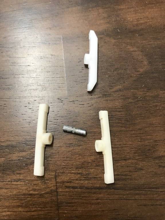

The clips are 3 pieces.
Original on the bottom. One of the new Mopar clips on top. I have one leftover because I couldn’t find it when assembling. I had to use one old plastic piece.
If I blow up their photo and lay my pieces on top the size, plastic and pins match. It is just the new ones have a little taper on the end where the old are straight.

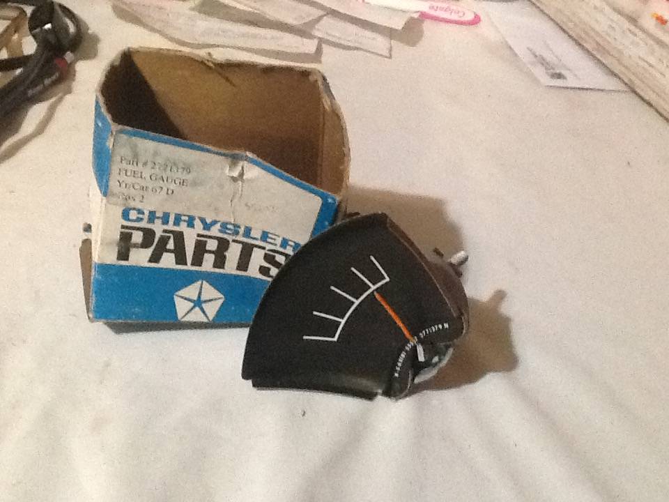

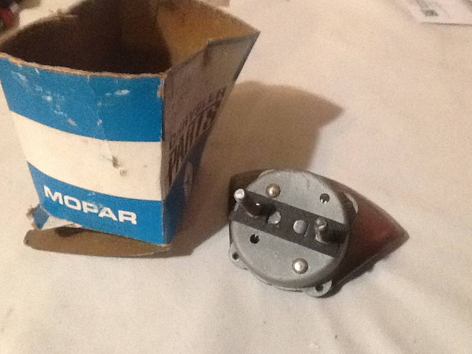

Found this today in the stash. NOS,but has some shelf damage to the needle instruments.
If yours is faded or yellowed? Maybe u can fix it?
FREE + postage

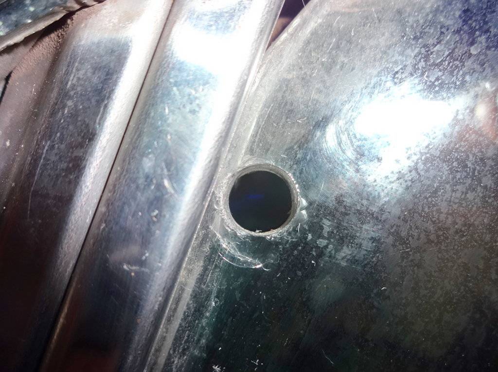

Maybe a "pressure equalization" hole. Perhaps the PO drilled it to aid when closing the door because of air being trapped inside like a bladder from the convertible top. Or to prevent the billowing effect on the top when driving at speed?
I don't know just a thought.. it's early...what can I say?
Definitely not factory and I hope it doesn't whistle when you're driving and make you nuts! :rofl:

It's been established that this is OEM and provides a mount position for a glass glide. Thanks though.

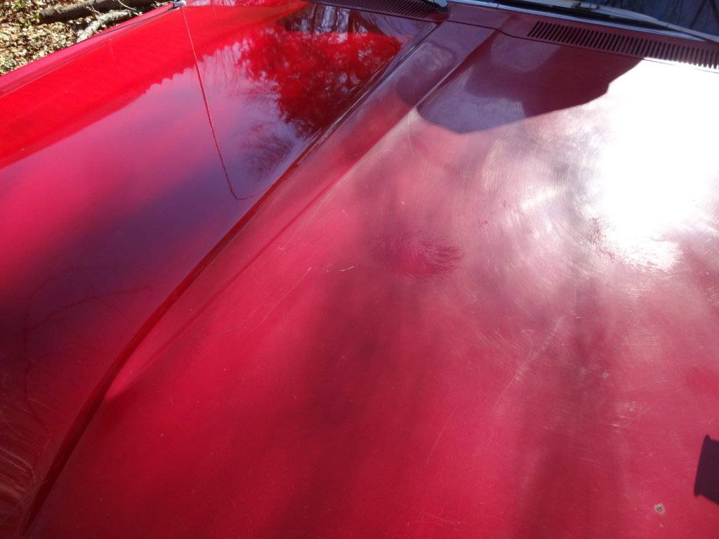

I used the comet designed for use on countertops. Not only does not scratch the surface but will remove minute scratch's in the paint surface. Did it yesterday. I wet the surface, sprinkled Comet on, scrubbed with a soft brush and wash rag then rinsed. Followed up with a wash with Dawn detergent. It removed all the remaining oxidation which will make the compound rub much easier.
My guru Mark gave me a 3M product with enough remaining to test. Its not an abrasive but a chemical, (36060...$$43.00 a quart, cheapest I could find.)

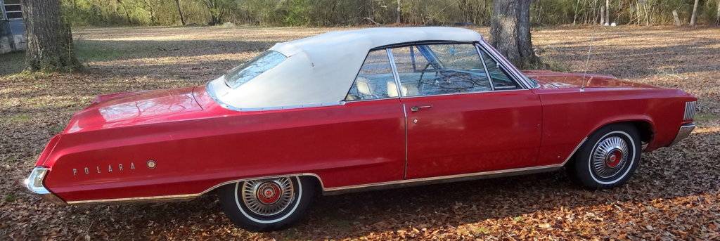

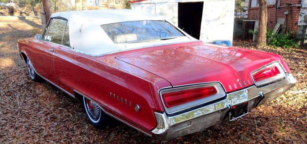

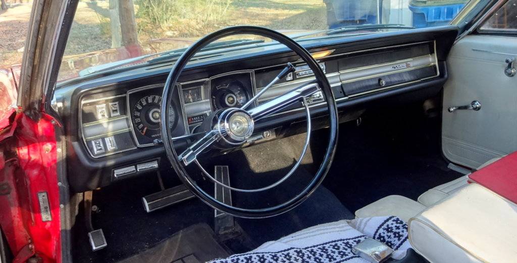

A few pictures, after the comet treatment and a test buff of the hood........ I captured a nice shot of the hose too.

:wideyed:
:thumbsup::thumbsup:
