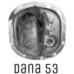

Google dana 53 Jeep and you will get 1,877,684 hits...
Who's arguing, I think we already came to that conclusion with the manual post.65Fury440 nailed it EXACTLY. Thank you
Here is the final word. You are warned NOT to argue with us on this.
It is a Dana 53 9¼ NOT to be confused the the 73½+ corporate 9¼.
Also, in the repair manual, the Dana 60 is incorrectly shown when referring to the Dana 53.
End of discussion. Everyone can go home now.

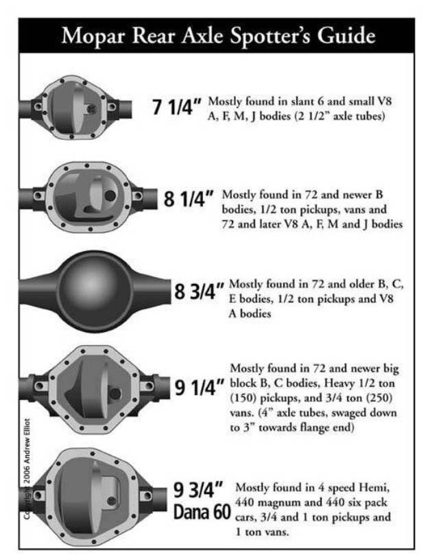

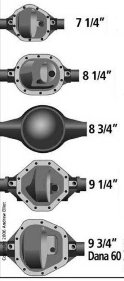

And I can't see a repair manual, Im not sure where that's posted its not showing up. I'm referring to this chart65Fury440 nailed it EXACTLY. Thank you
