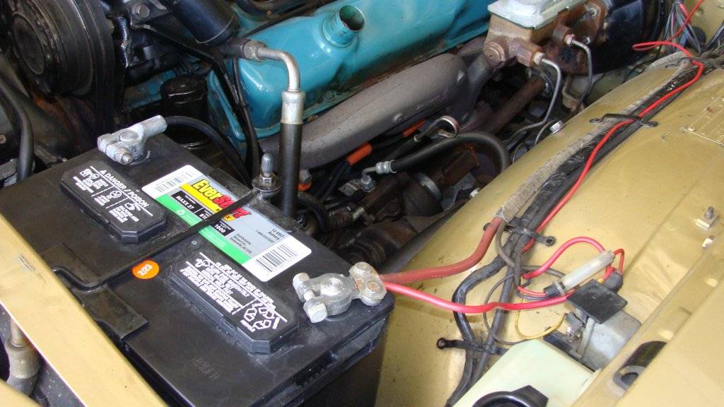

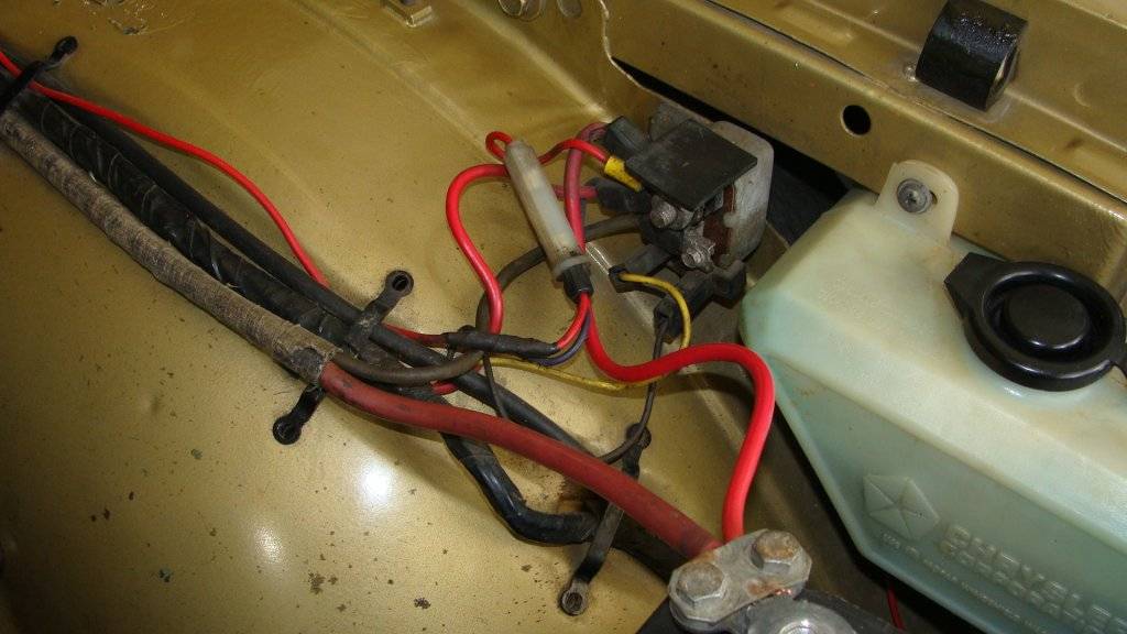

Hi, looking to hook-up key power source, What lug do I attach to on starter relay (example) ? The big lug to the starter w/yellow crimp and fuse?
no, that one is under, the one with the fuse is the one I'm talking about
What does the line with the inline fuse attach to?

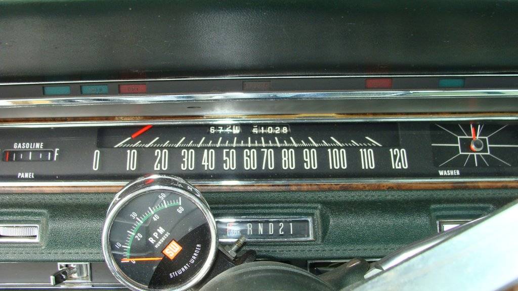

tach, I sold that car, looking to hook another up in different car and using this as an example
so, where the heck can I power the Tach w/o chopping my original wires ? I appreciate the help mike

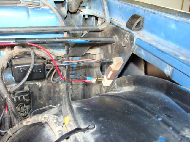

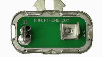

Do you have the RTE IVR3 gauge voltage regulator? If so, the additional prong/blade for the 12V input side is perfect for ignition on-power.
I used that for my electric choke power as the rubber grommet for the vacuum heater control hose was right there too.
