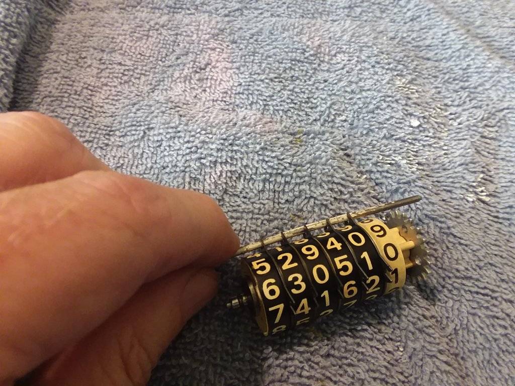

Picture from 1970. If you your 67-68 is like my 70:
Are the steel tangs aligned?
Link below is me learning to move a 1970 odometer from a rusted gauge face speedometer to a clean replacement. Hope my experience helps.
