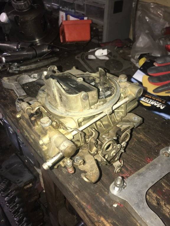

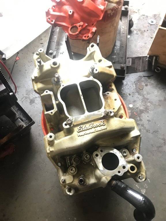

Will do! Do you guys know much about my 4 bbl Edelbrock performer intake manifold and 4 bbl carb swap? My question is this. I have a Holley 650 with what looks to be a vacuum secondary, and I also have two thermoquads, one which is in good shape and another that’s complete but needs rebuilt or to be used for parts. I can either use the Holley or use the thermoquad and have plenty of parts if needed. On a 360 2v with 9.1:1 compression and stock cam I’m not sure which way to go. I know I can dial the fuel back, and I always hear Steve Dulcich praising the thermoquad religiously on Roadkill and RK Garage. I have no experience with either.

so... Holley or thermoquad?

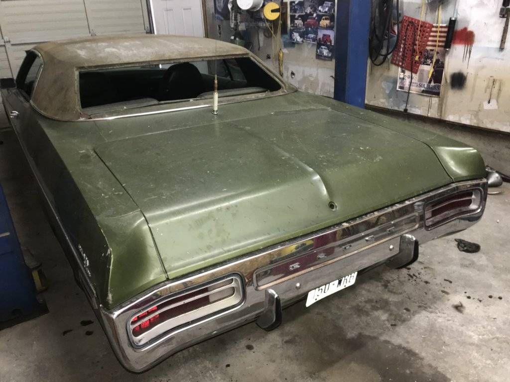

That green one is a 72
I have a question. With the green car. After the top is done and back window in, I just want to check the car out mechanically, and spruce it up with a wash and wipe it out. I was trying to see exactly what the factory wheel caps look like. Do you have a pic? I just want to put very little money in so I can sell it cheap to it’s next owner. No engine dress up or exhaust (well muffler needs replaced). Motor and trans are great so I’m thinking 32-3500 will be a good deal for what the car is.
You sure? It has different front side markers than my 72. Mine are big and down below, these are smaller and up towards the top. Could it be a 73? I’ll check the Vin I swore it was a 71
Because your other car has cornering lights, this car has standard marker lights .
And , No , not a 73
