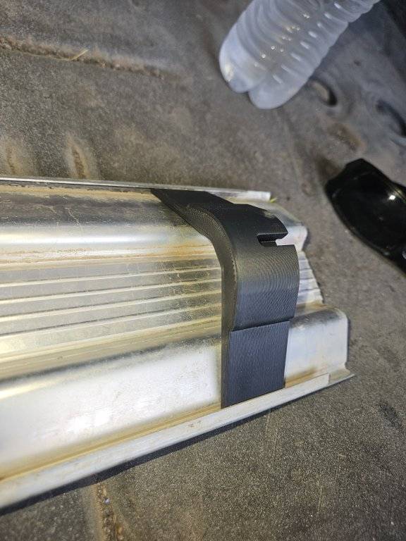

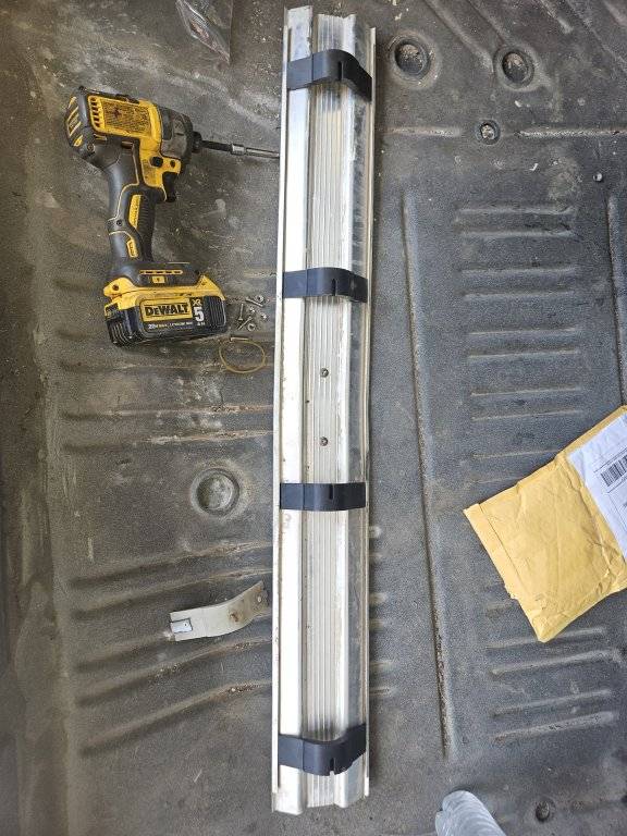

Hey guys, who all is still needing these clips? I have worked with a buddy of mine and have some 3D printed stock built up. They are a slightly improved fit from OE. They feature a removeable bolt, same thread as original so if you have the OE nuts they will work. These will be turn key and sold in sets. Still finalizing price on them once we have a manufacturing and material costs streamlined will have a better idea. That being said we do have a couple sets ready to go currently.

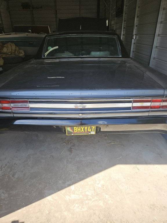

I have fit these to my car in the photo and they are perfect. Little tighter fit as my clips were in tact but loose (may have shrunk), but these hold much better. One thing for certain I did not want to lose this panel driving down the road!

FWIW, a suggestion on the design:
Get rid of the slot and make it a keyhole instead. That keeps the bolt in place while you're straddling the rear bumper and trying to insert the bolt into the hole and not drop the insert panel or scratch the paint and reach for a nutdriver and not drop the panel etc etc etc...
The T slot dimensions are pretty snug and do not allow the bolt to slide around once in there. This was a revision that we made when test fitting.

I purchased and installed a set of these. As mentioned the bolts fit very tight in the slot so there was no chance of them falling out during install. The clip themselves also fit quite snug in the finish panel itself. Overall I am very pleased with these.
