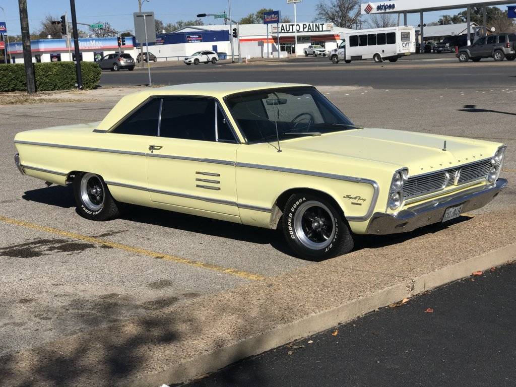

Has anyone put the 15x8.5 Torq Thrusts with 3.77 or 3.81 backspace on a '68 Fury?
I've got 15x7 cop wheels with 4.25 BS on it now and the sidewall is like 3" away from the lip and it looks kinda dopey to me. I'd like to move the tires out closer to the lip but I wonder if losing a 1/2 inch of BS and adding 1.5 inches of width will be too much.
Torque thrust on 66 fury
