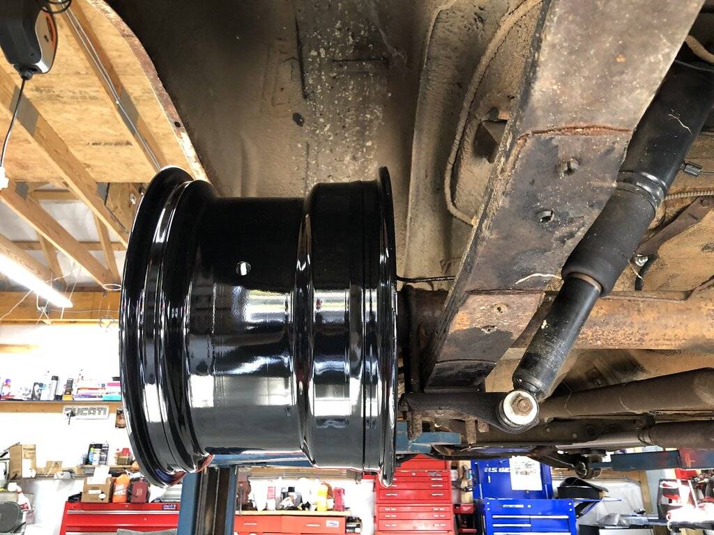

Re-reading back through this thread on this COLD morning in TX, as to the size of tires on an 8" wheel, there were lots of middle-later '70s and later Chevy half-ton pickup trucks running around with 15x8 (factory) rally wheels on them. All with P235/75R-15 tires on them. They looked good and didn't weight that much in comparison to the 15x7 rally wheels GM had on many car models. I have no information on the backspacing, as "offset" was more important back then (at least to me AND the load on the wheel bearings!). I have found the backspacing specs on the 15x7 Z/28 (1970s era) wheels (also used on Chevelles) and it is 4.25". Yet some Buick repro factory chrome wheels only come in 4.0" backspacing, so that is another datapoint for their intermediate-sized cars, too.

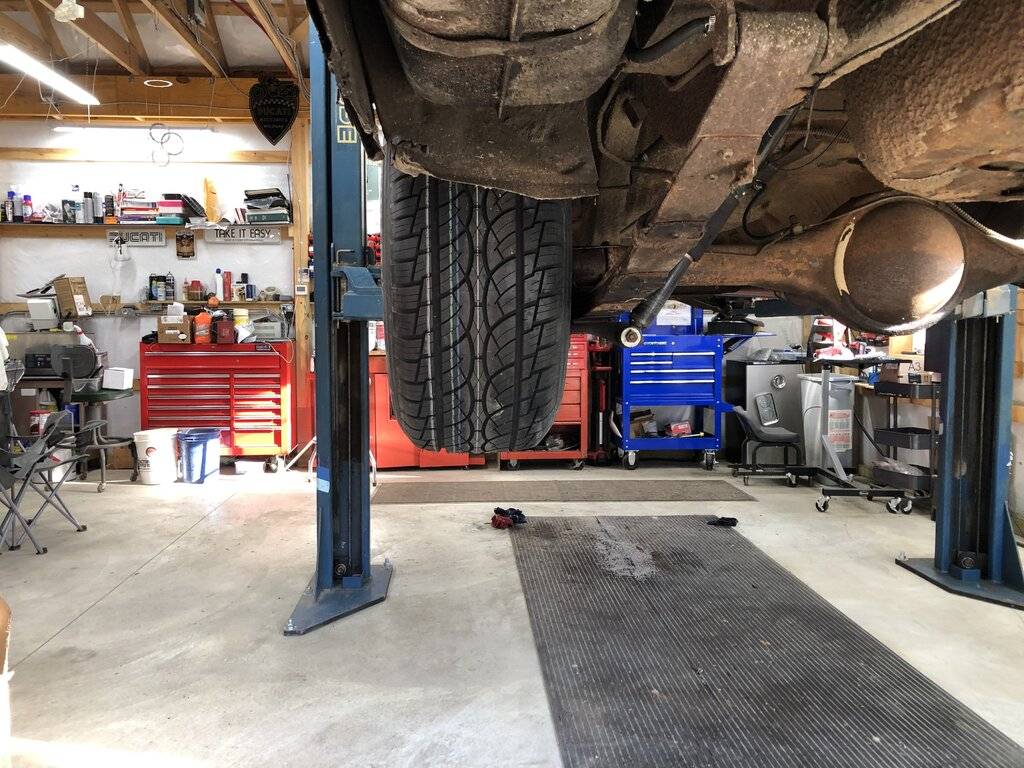

On the rear, other than the obvious quarter panel wheel lip, it's the sidewall/leaf spring distance that is also operative. At issue here is the lateral deflection of the rubber bushings in the rear spring front eye mounts and the rear shackle bushings. Urethane replacements can diminish that, I suspect.

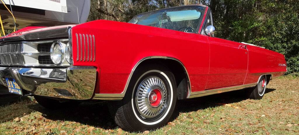

One thing I learned YEARS ago, when washing the whitewalls on our '66 Newport Town Sedan, even with the stock 14x5.5 wheels and 8.55x14 tires. I didn't want to have to move the car to get all of the whitewalls scrubbed, so I got a brush that would fit over my hand. On the lh side, with the fender skirts removed, ample room to scrub the upper half of the tires, but on the rh side, there was slight interference with the inner wheel house's factory undercoat. Not sure exactly why, but it was that way from the factory. Other Chryslers seem to be that way, too, by observation. Maybe not so much, but still that way.

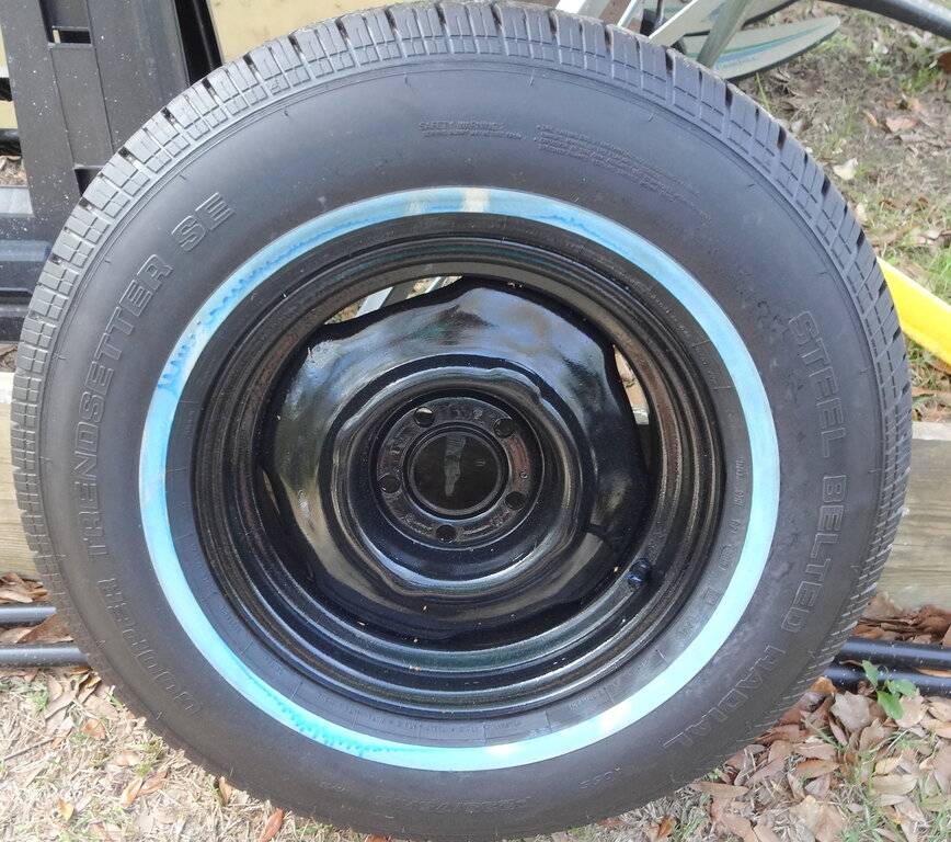

Now, I like a wider wheel/tire look as much as anybody, but I prefer using OEM-type sides of up to 7" riim widths and OEM backspacing. That's just me. When we got a set of (Uniroyal-built) Golden Sonic whitewalls in H78-14 size, on the factory 14x5.5" steel wheels, they had a wider tread width than other similar tires. I measured them to be an actual 70-series aspect ratio AND noticed that there was strong evidence that their sidewall's widest point had also been touching the factory rubber shields on the outer tie-rod ends. Not enough to tear the shields off, but still contact when turning (obviously at the higher highway speeds we could drive back then, which the car also enjoyed doing). Otherwise, about 3/8" clearance. Didn't think to look at the rear tires inner sidewalls, back then. But tires back then, especially the BFG Silvertown belteds which came later, had wide "curb protection" rub-areas on their (inner and outer) sidewalls, which kind of over-stated the tire's sidewall width a bit. Just the way many tires were back then. That extra bit of sidewall structure would keep the whitewall from becoming "scrubbed" wider when the wheel would contact a curb during parallel parking maneuvers.
