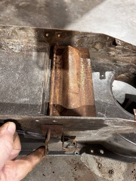

I’m cleaning up the heater box from Elwood, my 68 Fury II 4 door sedan.
It doesn’t have AC.
Can I remove this piece? (The steel)
It appears to be swedged onto the shaft that it pivots on.
I believe that is a mixing door for floor to defrost air flow. I did mine some time ago and was sure there was a reason for it. That curved tail piece looks like it should have cable attached. Maybe others can assist with more accuracy.
I got all of the other pieces out and am cleaning them up.
I believe that you are correct on identifying the blend door. I am asking how to get the door out. I am probably going to clean it up in place, paint it and move forward.

It is one piece but you should be able to get it out. I think when I did mine, I popped it out of the bottom hole, then finagled it through the metal bracket without removing that bracket but it has been a lot of years. At least I don't recall having to rivet that bracket back on to the housing. Good luck and I hope you took lots of pictures of the dis-assembly.

If I recall correctly that is the one piece I couldn't remove when I rebuilt my heater box. I cleaned it up best I could without damaging where it mounts to the box. I found repairing and using the original heater box very satisfying once I figured out how to properly route the vacuum hoses that controls the vents.

I drilled out the rivet and cleaned up and re-plated both when I rebuilt mine. I did not remove the rubber bumper from the door as it was stapled on.

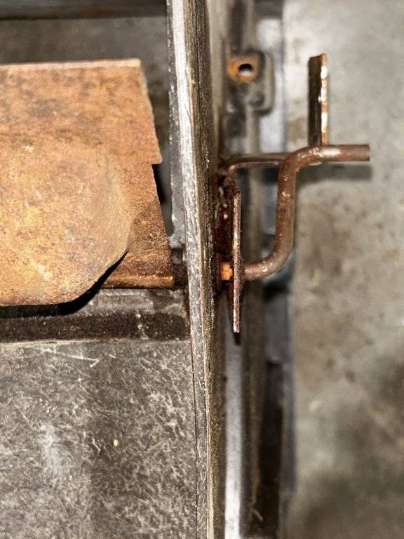

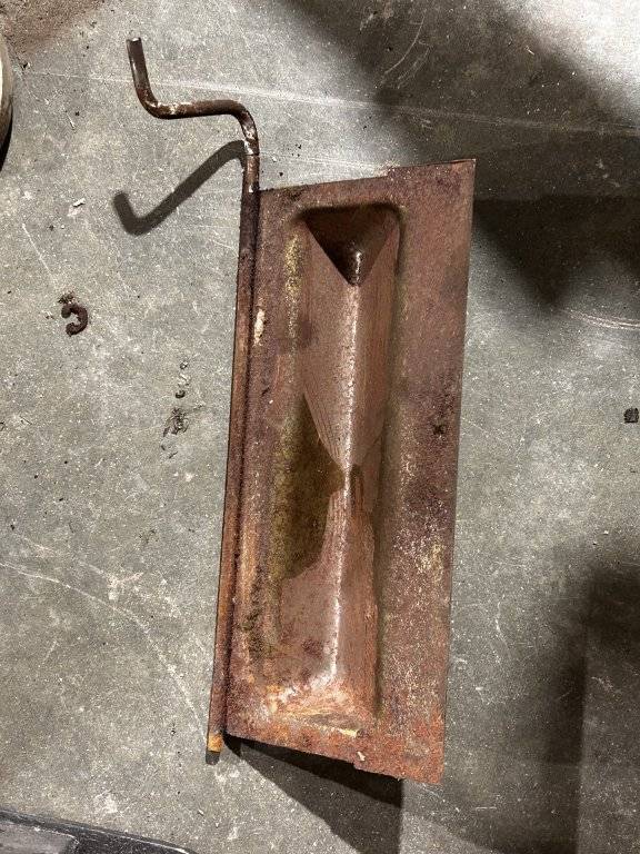

I figured out that there’s a c clip under the sheet metal, popped that out and was able to remove the pieces.
I had to bend the end a little, but was successful.
