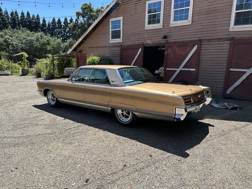

I did the same as you and purchased a clean low mileage original. I’ve been driving it about 3-4 days a week since I bought it. It’s been a dream to drive and extremely reliable. I started out with shorter trips, and then increasing the distance and frequency as my confidence has been gaining. It’s bone stock with points and drum brakes, but starts every time with a quick bump of the ignition switch and effortless stops straight. I’ll be upgrading to Disc brakes and do a petronix conversion soon… but so far everything has been working great. Still feels like a new car.
Wow your's is beautiful, that color combination is ideal. Not sure exactly what mine might turn out to be, but it's got to be blue somewhere, keeping the cars original personality.

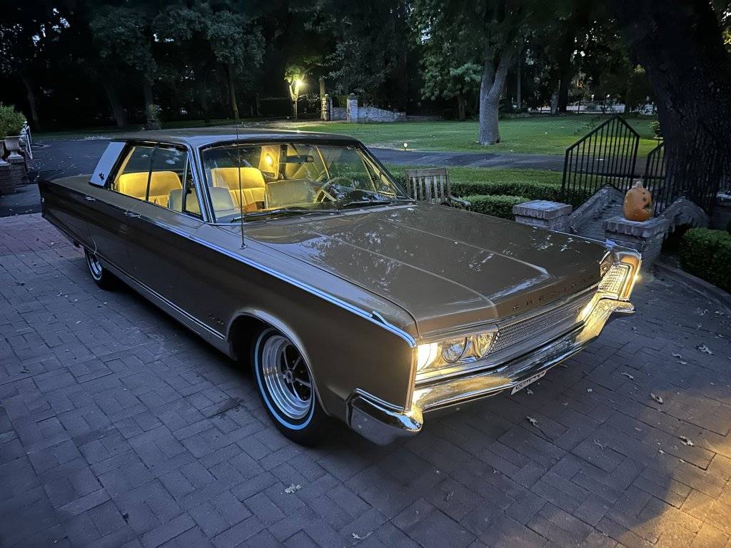

That '66NY is beautious!! Always did love those gold cloth interiors, no matter the model level. The VN501s compliment things, too.

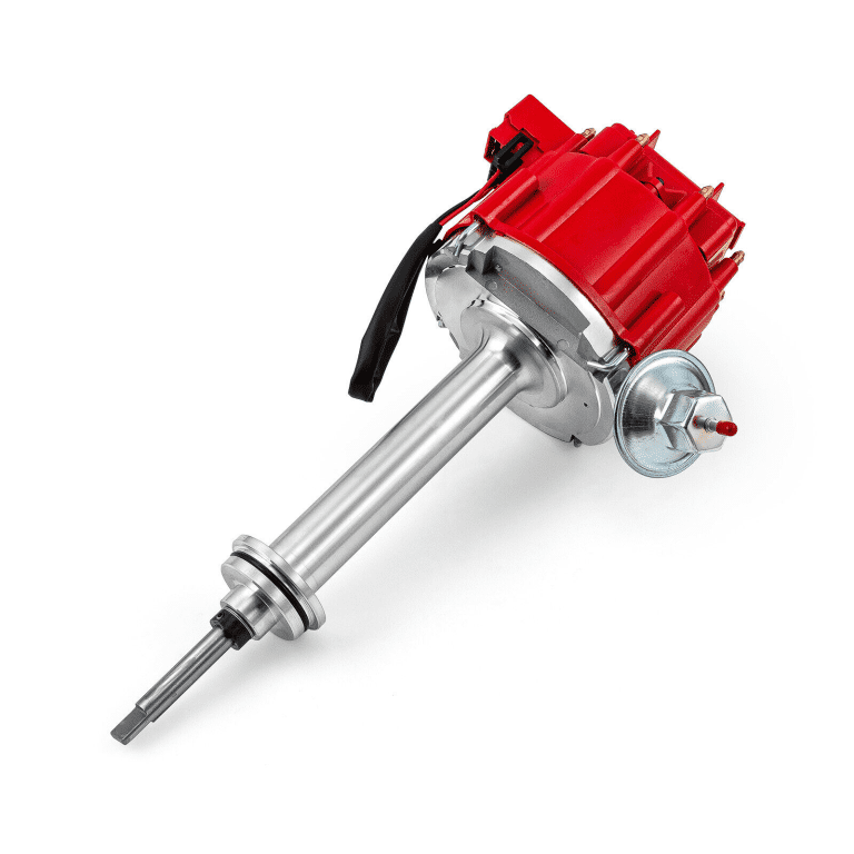

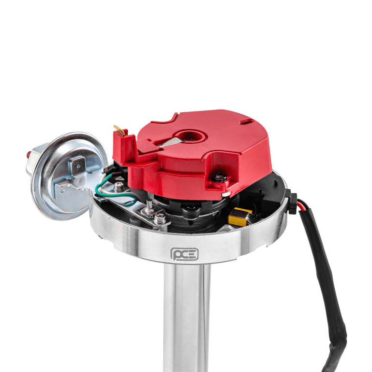

This works good. $75 with plug wires and pig tail to $125 without plug wires or pig tail depending on where you get it.
And service parts aplenty at the corner store.

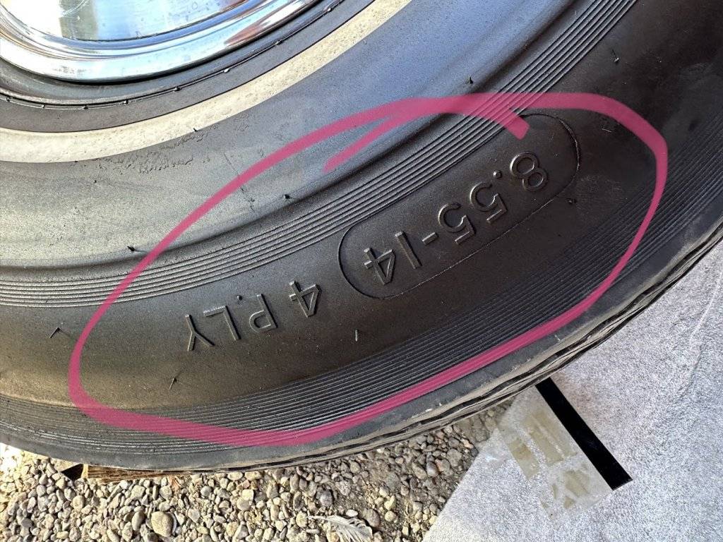

My stock tires were 8.55 x 14 Bias Ply tires which I believe are pretty close to 225 75R x 14's. I'm running 225 75R 15's as my future plans are to convert to disc brakes. The fit is perfect and appear to be about the same size.

That '66 NY looks fantastic with the VN501s!! Which width and backspacing on them?
