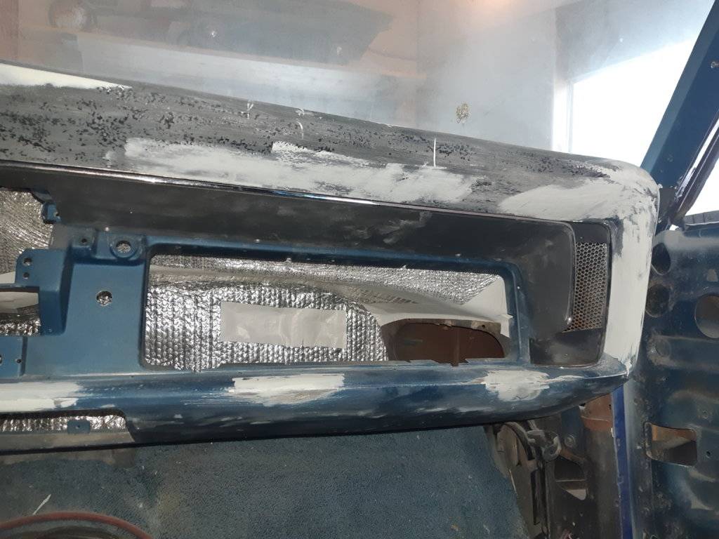

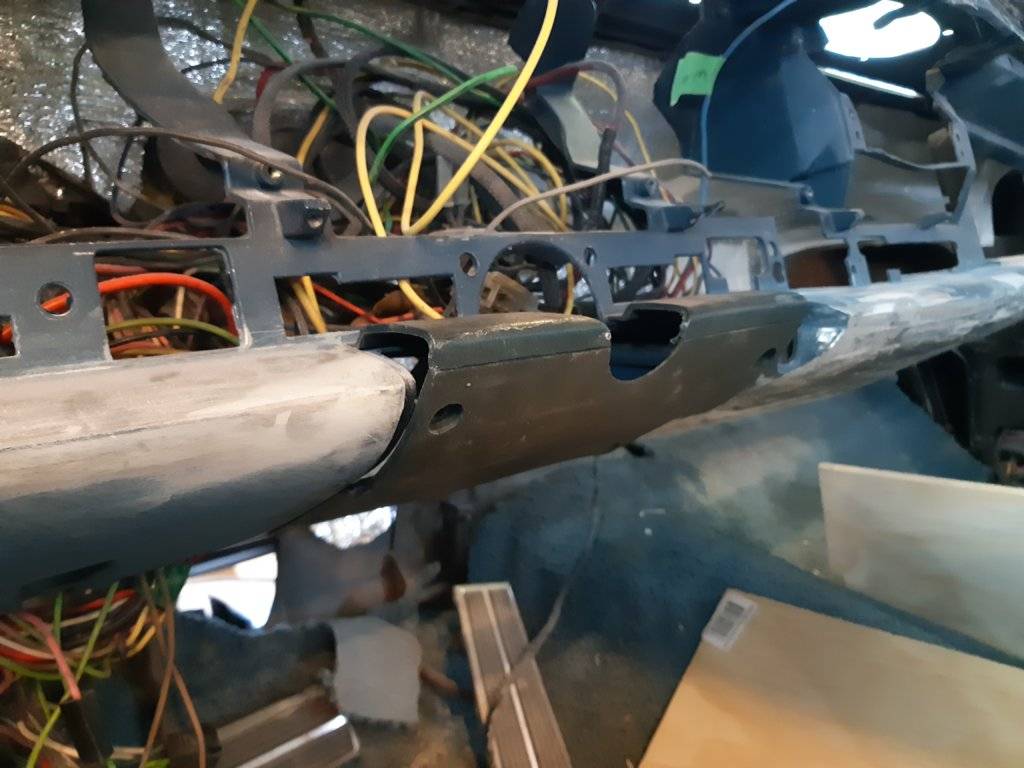

68 Newport with twist

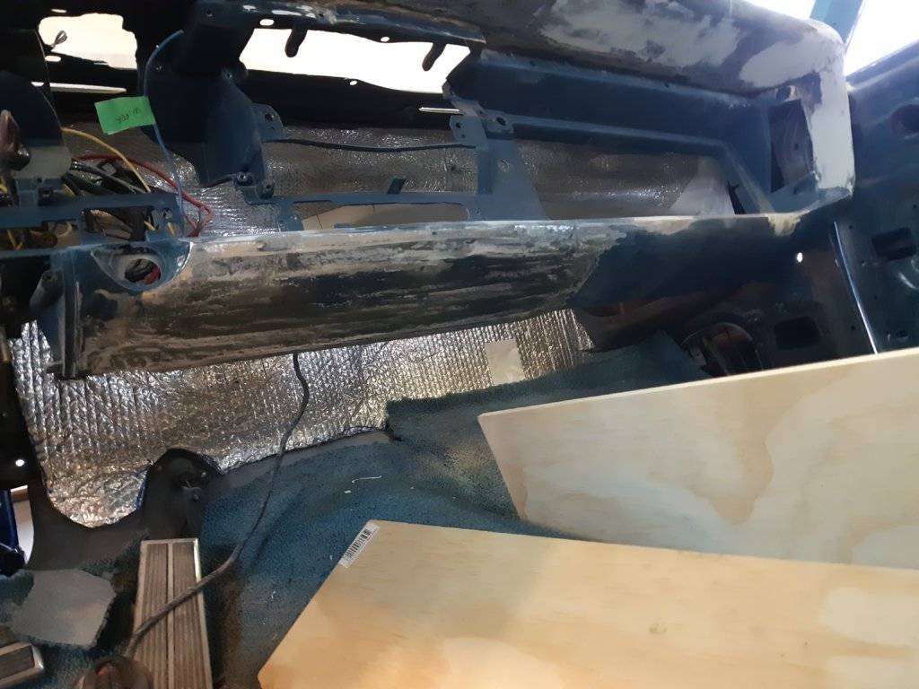

Also a few years back I removed the auto heat/air system and installed on earlier model system. Picked out up original controls for it and floor vents as well. Nice to have air movement down there. Crap pic but they are coming apart for paint so will show better later.

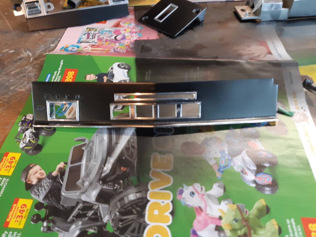

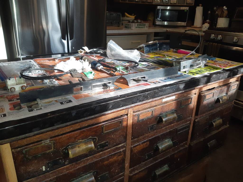

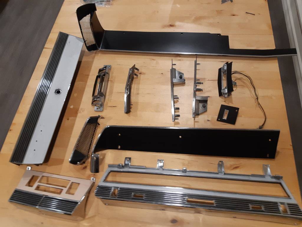

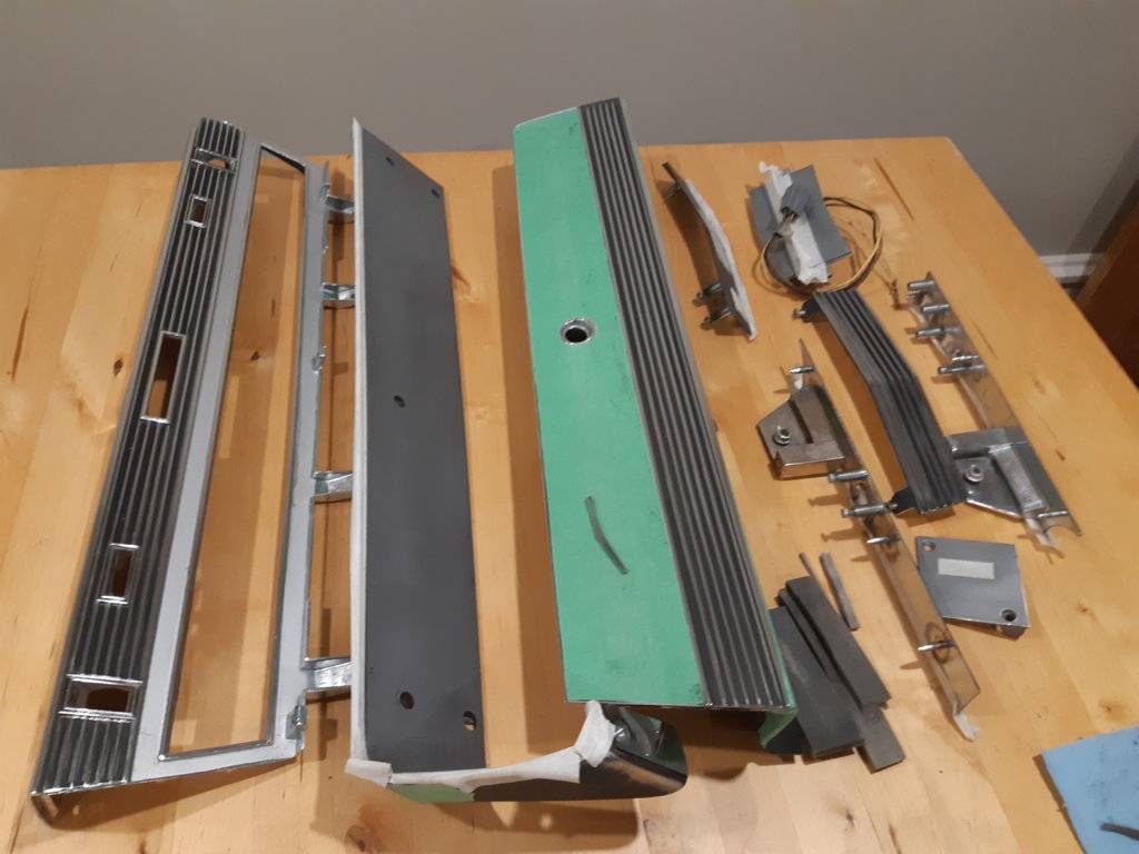

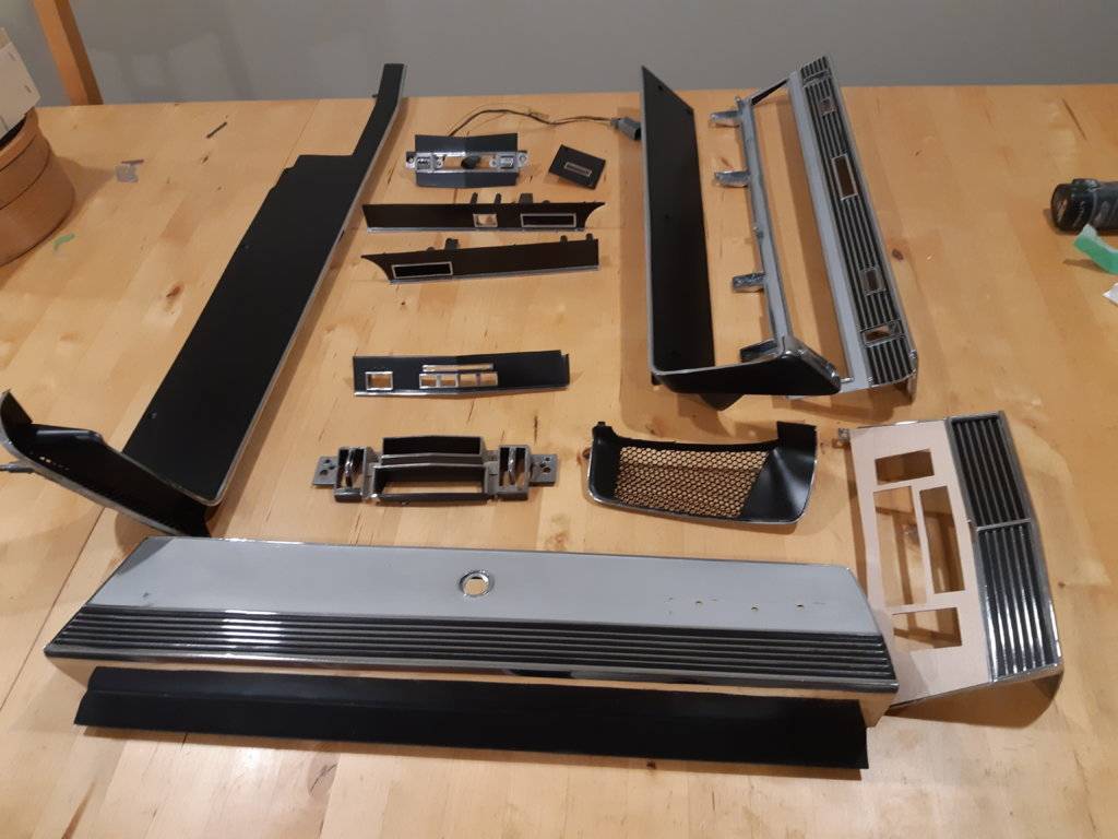

Got all the dash panels painted today as well. Only this pic so far and parts have to stay at shop tonight. Not allowed to dry parts Indoors in winter. Or bake them in oven anymore.
Factory had 2 tone of silver and black. I just did satin black
