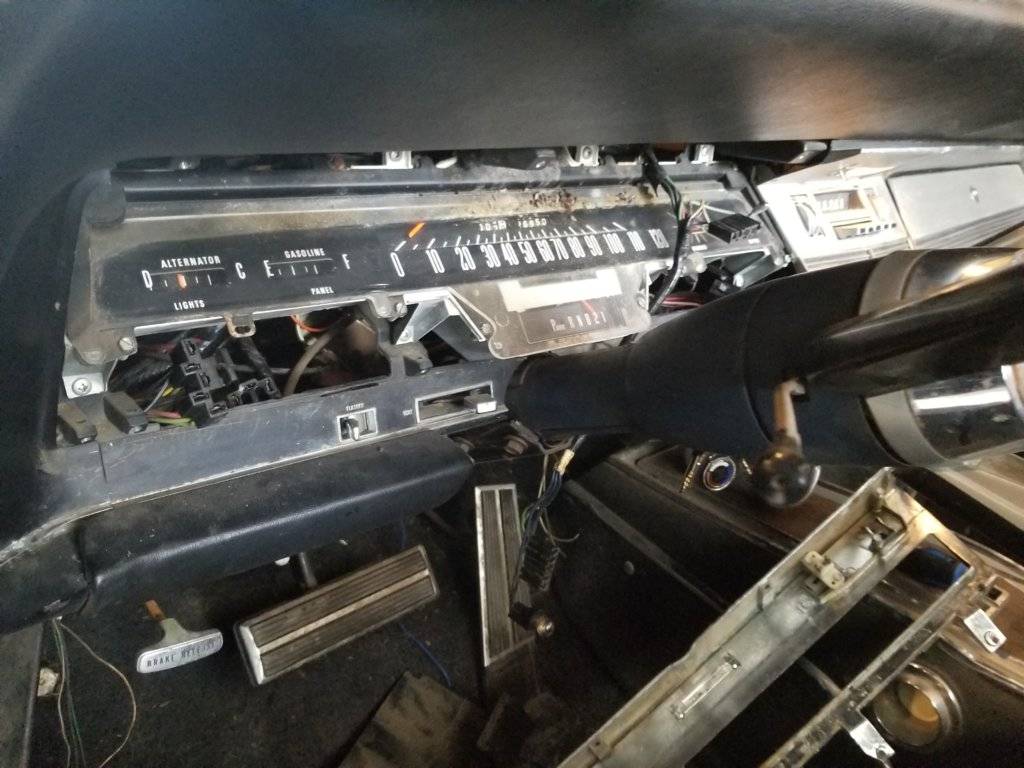

Hello all i decided to tackle the wipers on my 68 300. Its a 3 speed wiper. The switch in the car didn't do anything. So i tried another 3 speed switch from one of my parts cars. But it only goes at one speed. Is there a guide on how to fix them or a place to get them redone or replacements?

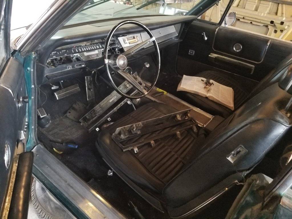

I see you do have the shop manual on the passenger seat.
In it is the troubleshooting chart.
I would double check the connections at the bulkhead connector at the firewall.
Also you can jump the motor from the battery.
Body is ground! make sure the ground strap at the wiper motor is not broken or corroded.
Typically the motors fail before the switches do.
Hope this helps.
Hope this helps.
