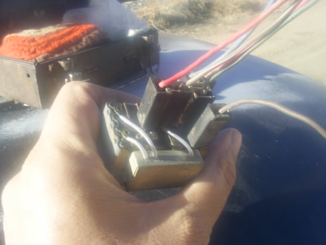

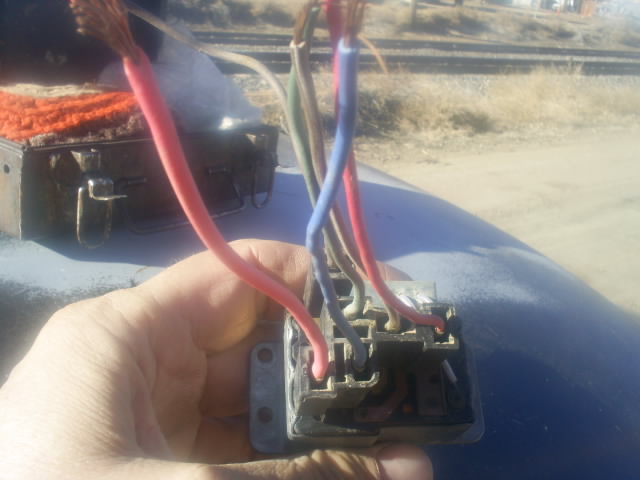

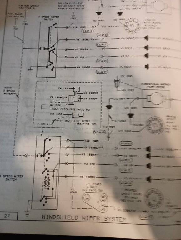

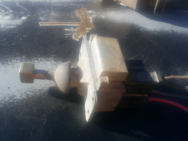

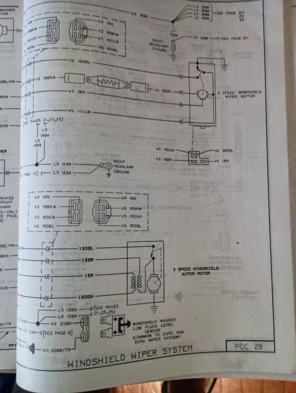

Ok I'm trying to figure out a mild electrical fire that may be the result of a bad decision. Its a 3 speed wiper motor and when I got the car 10 years ago they did not work. The switch has a strange "Borg" looking ( heat sink?) that sits ontop of the switch. Its a rectangular block with a few thin wires going into the switch. So, I replaced the non working switch years back with a junkyard one that was identical. Viola!! They worked although it was touchy ( had to tap the switch just right) and only 2 of the speeds functioned, plus it had difficulty "parking". A month back they switch would no longer park and only barely worked with a wipe or 2 before freezing up. So...I di through my stash and find a switch w/o the "Borg" box ( a 2 speed switch I presume), it plugged in the same and the wipers promptly parked. It was dry out so I did not run it through its paces. Drove it for 2 days, all good and then the blue/pink wire caught fire and scared me 1/2 to death. This car is my daily driver. I checked the plug and the "hot' wire was still hot, no fuse blown. The blue/pink is a 'delivery" wire. Of course this wire is deeply embodied in the harness so I'm going to build a new sub harness so no stress is put on the main.
Could the install of a 2 speed switch on a 3 speed motor cause this? Is all grounding through the switch body? What is the "Borg" rectangular box ontop of the 3 speed switch ? Can I trust the wiper motor? Blue/pink wire function? The rest of the sub harness is all good?
