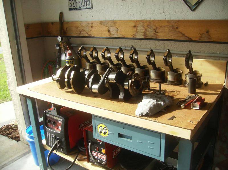

I know you guy's and gal's like pictures, so here are a few after removing the engine this morning. 440 going to get freshened up with new heads,rings, bearings, cam, lifters, timing chain, and gasket set and oil pump. Wish me luck. As always your help and advice would be greatly appreciated.Thanks.

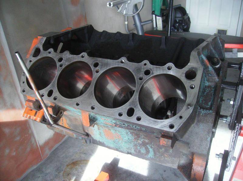

Engine block is pretty much stock bore and it's in good shape so...what I would like to do is hoan and built to or as close to TNT specs as I can. But we'll se after closer inspection. So far I have a rebuilt set of 452 heads, new timing set . comp cam and lifters as I can remember been a while since I did my research 268 110* w/.454 int and exh lift, which should be fairly close to stock tnt. Moly rings Sealed power rod and crank bearings not purchased yet as I haven't taken measurements. Nice to get away from body work and get into some mechanicals for a change.

Looks like a great project, good luck with it! And damn, that's a nice looking shop! Seems to be a good place to do effective work!
Thanks. Here is a quick update. Did manage to get some work done yesterday. Not sure if I'm into it today.
This little brother has seen better days.
Now onto all the cleaning which I'm not looking forward to.
