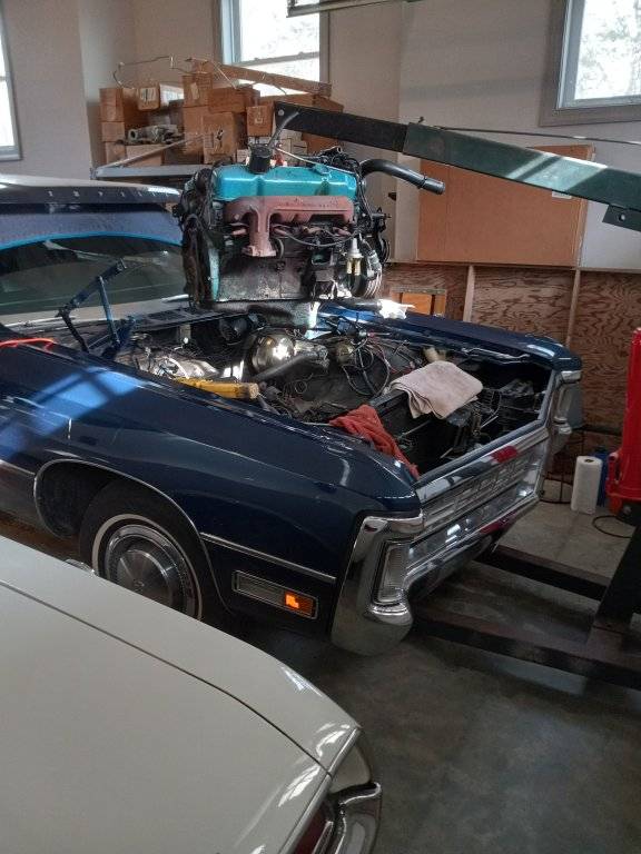

A couple of pictures...

Usually only one heated freeze plug in the engine. You can see it in the photo on pass side middle hole. If it had 2 block heaters it would have 2 cords to plug in.
