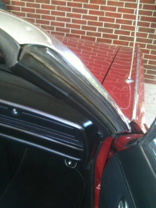

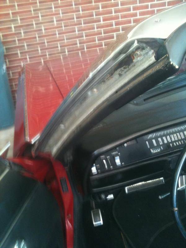

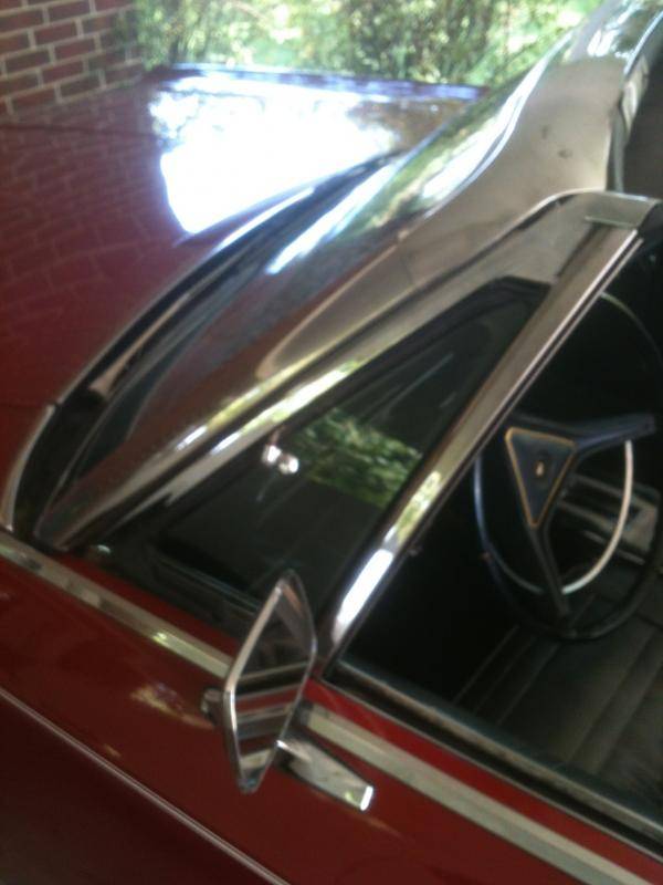

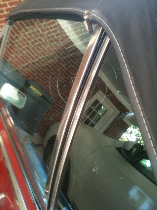

Just purchased a 69 300 and noticed when the top is up it seems as though the drivers door does not close entirely at the top. Upon further inspection it seems as if the window assembly is "loose"? and keeping the windows from sealing properly with the top up. You can see there is a visible 2cm gap between the door window and the back window. How do you fix this? the body lines are all straight. Does the window assembly come seperate from the door? can I just remove the door panel and tighten the bolts or am I in for some real body work problems. Thanks for any help you can impart. See attached pics for more clarification.
Also I noticed there is no rubber gasket/ trim between the drivers door and the windshield frame. any idea where i can get this part. Please see attached pics.

The side glass adjustment.....? it's not clear as to weather the gap is front/back.. or side to side. It may be the rear 1/4 glass is moving to far forward at the top when up. There is a stop adjustment at the front and rear to adjust that..... You really should get a Factory service manual..... The adjustments are all covered in it.

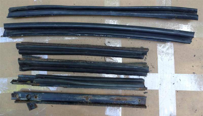

Here is a pic of the seals I have. One of the rear 1/4 rubbers is missing, the other 5 are in pretty good condition.
If interested pm me.... or contact me at rockerarm@juno.com
