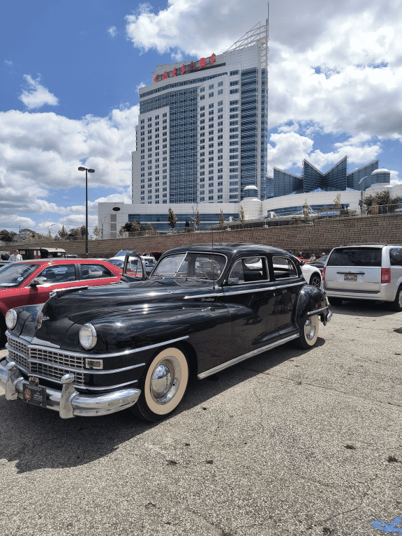

There is a friend of mine (Greg Biskey) in the WPC Club who has a 48 Town Sedan special order custom he just purchased. It was a Chrysler factory custom build for Fred Zeder a Chrysler executive at the time. The car is a beauty, and is a one-off.
The car is a survivor, and also needs hydraulic window repairs. Greg may have some information for you, but I do know that he was pretty stymied on how to proceed as well, and it was he who said that taking the door panels off may ruin them.
If anyone has extensive knowlege of these cars, it's Greg. I am going to try to hook you two up. His Facebook profile is: Greg Biskey
