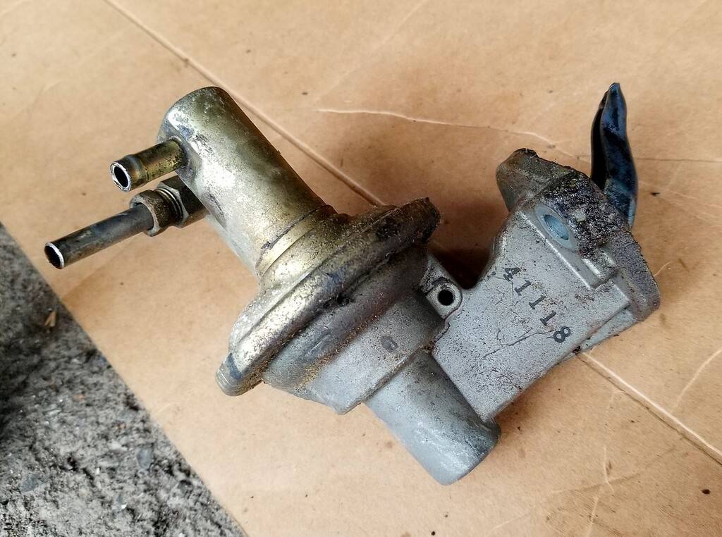

I know it's normal but is there a way to check the pump (without specific tool to test the pressure)?

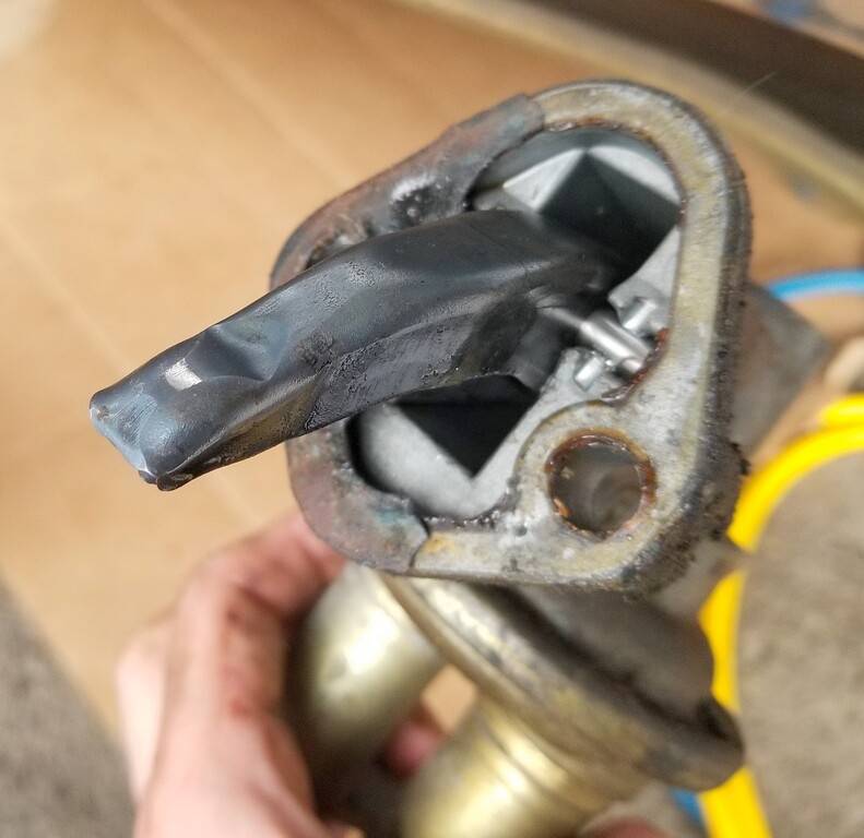

Don't worry about the traces on the rod it's my finger mark
The mechanism seems to work very well, but the internal diaphragm is probably shot I suppose
Considering the price I intend to change it anyway, but for the rod I don't know how to make sure that it's good
And for the pump, in appearance mine looks more like that for L engine with the 1/2 nut connection, but fitted with a rubber hose connector
1969 CHRYSLER 300 7.2L 440cid V8 Fuel Pump | RockAuto
I better take the one for K engine anyway?
Is the connector the only difference between the two or do you think there are internal differences?
Thanks! :)
The fuel pump rod IF it needs replacing is pretty easy. Pull the pump and there's a small plug screwed into the block right below it. Take the plug out and you can wiggle the rod down through.
Personally, I think the original is better than most of the replacements out there, but you can check the length easy enough with a pair of calipers. It should measure 3.25" long.
Of course, if it turns out that it's pumping gas like it should, don't bother with it.
See Big John in the quote above 3.25 inches long.
It really doesn't look like what I expected, I don't see how you can remove it or even measure it without removing it, but I will start looking for a caliper to try to take the measurement :D
Yes, you turn the engine over with a soda bottle on the gas line and check the volume of fuel that comes out. Very easy, involves disconnecting a clamp...
But, instead of checking it, you've taken it apart...
Yes I tried that of course (see above in the thread), I checked that 2 times, the first one the pump was working, it spitted gas, and the 2nd time (when I wanted to try again the flow), nothing

The guy on this forum advises not to try to unscrew the access plug to the fuel pump pushrod, how do I replace the rod without removing this plug? XD
You didn't say anything about checking it a second time.
Now that you have, it's a reasonable assumption that the pump is shot and it's a good idea to check the length of the rod.
You can only lead them only so far, then they're on their own! Good Luck

I finally received the new fuel pump, installed it (what a pain with the pushrod which falls back and blocks the lever of the pump) and the car started easily...
