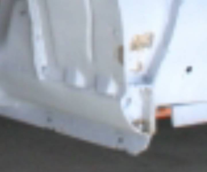

Rubber flap below the wiper motor. Often plugged with leaves and pine needles.
Also there should drains on the bottoms of the front fenders to allow water that runs down the outsides of the cowl. Again, often plugged.

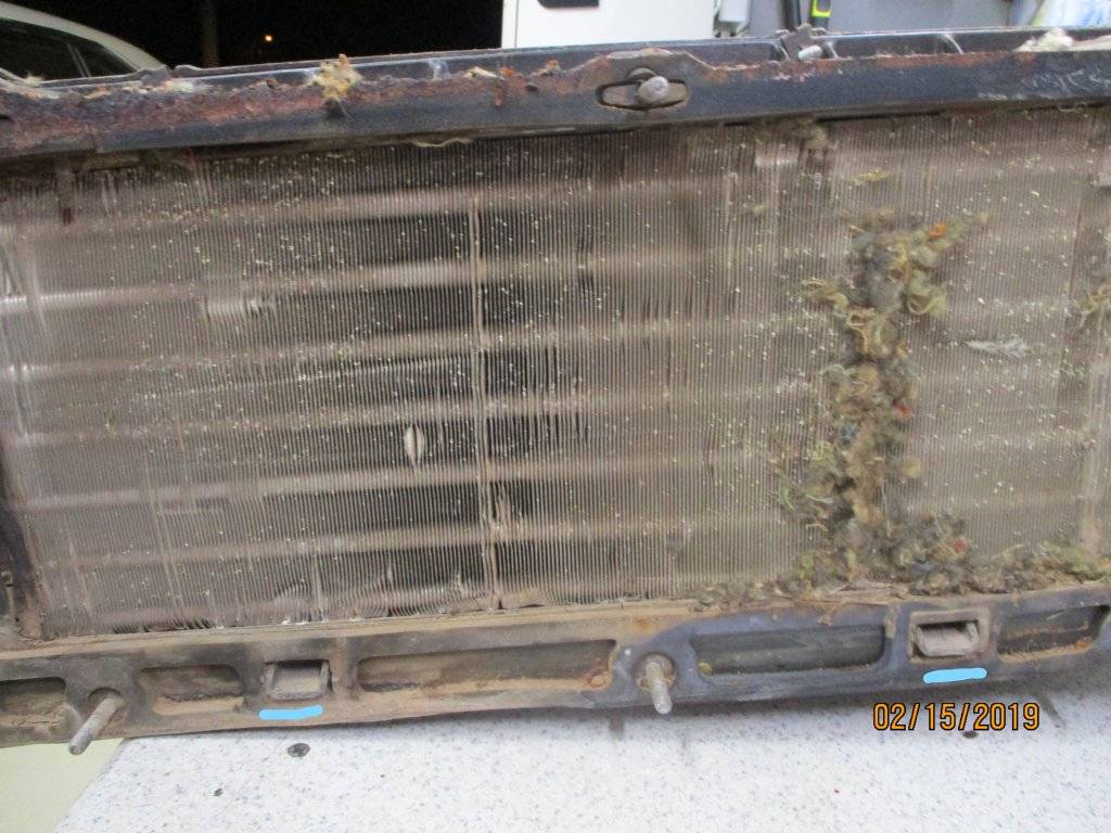

Water in the AC core is a different problem - there should be two drain pipes that allow water to drain from the AC box. Found typically on the passenger side of the cowl.

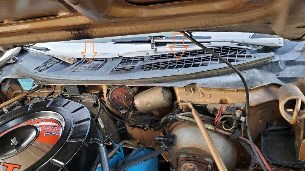

I'll have to look at the car tomorrow, but this is what I have from some dated pics.
The Cowl Vent and A/C drain are two separate questions. I gave the car its first wash and have water in the vent cowl area.
I havent run the A/C long enough for it to drain, but needed to know where to look and un-plug line if needed. Thx

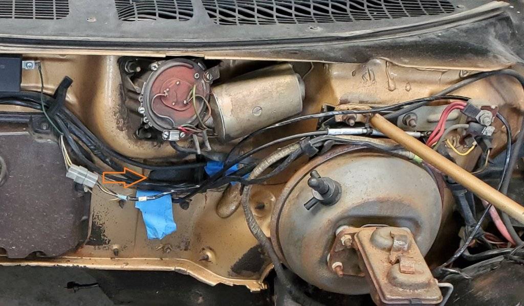

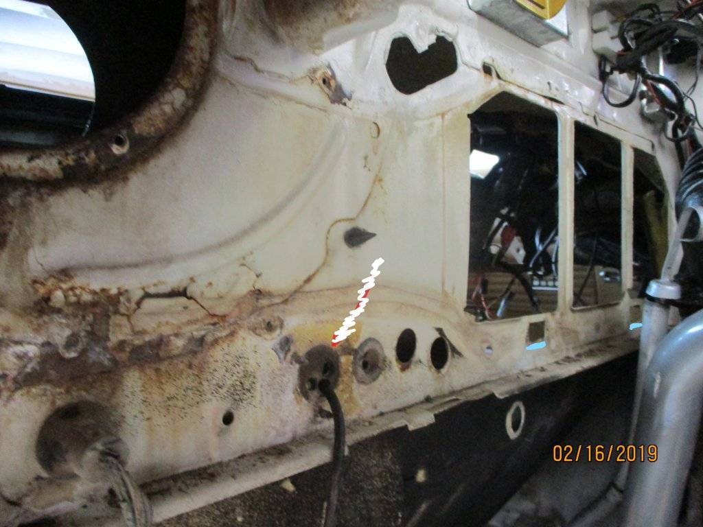

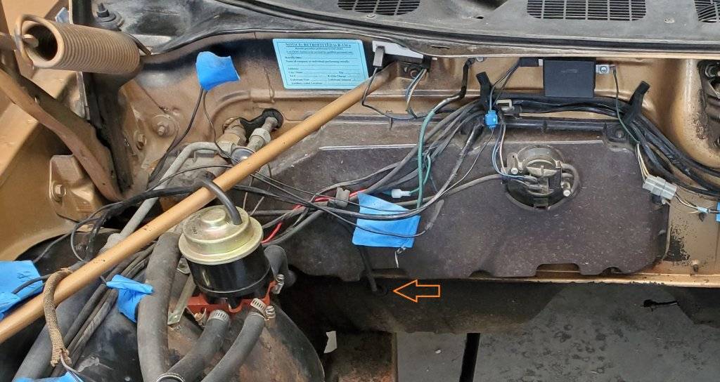

The drain spouts (not rubber tubes or round pipe) poke thru the firewall as shown in the light blue markings. Very hard to see as they're under the AC box and don't poke out much.
