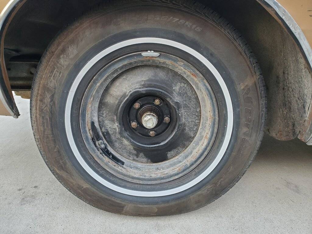

My 69 Chrysler 300 has these 15x6 wheels with 300 hubcaps, both of which are kind of beat up.
K-1-9 5*16 60 (I understand the Kelsey codes except for the 60, what does that indicate, 6.00"?)
1. Will poverty caps fit this type wheel? (Are all 69-73 poverty caps the same size?)
2. This repro is 15x7 with 4.25" backspace, will they fit? Wheel Vintiques 63-571204 Wheel Vintiques 63 Series O.E. Chrysler Black Wheels | Summit Racing
3. This repro is 15x7 with 4.00 backspace, will they fit? 69 series Black Chrysler Steel Wheels | Wheel Vintiques®
4. Should I search for original HD wheels instead? Easier or harder to come by?
Thx
Poverty caps will fit, that is what the nubs on the center of the wheel are for. Many of the 300 series came with slotted road wheels as standard equipment and those with the correct center caps are getting hard to find. The 300 was a high end model that would not be expected to be equipped with poverty caps. With the exception of police cruisers, very few Chryslers had poverty caps. If you have the build sheet for the car, it should specify via the correct code what wheels you car had from the factory. Build sheet in '69 will usually be tucked inside the top half of the rear seat.

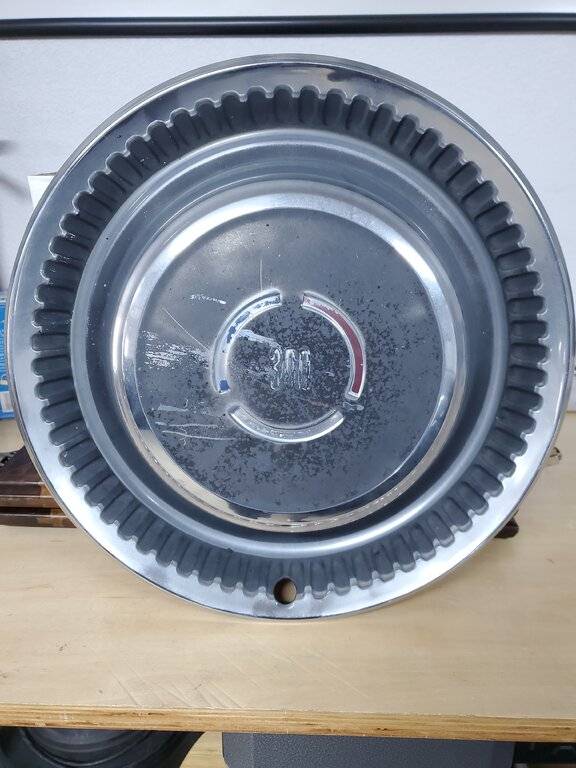

Thx for the reply. I know the 300's wouldn't have had poverty caps, just changing up the look a bit.

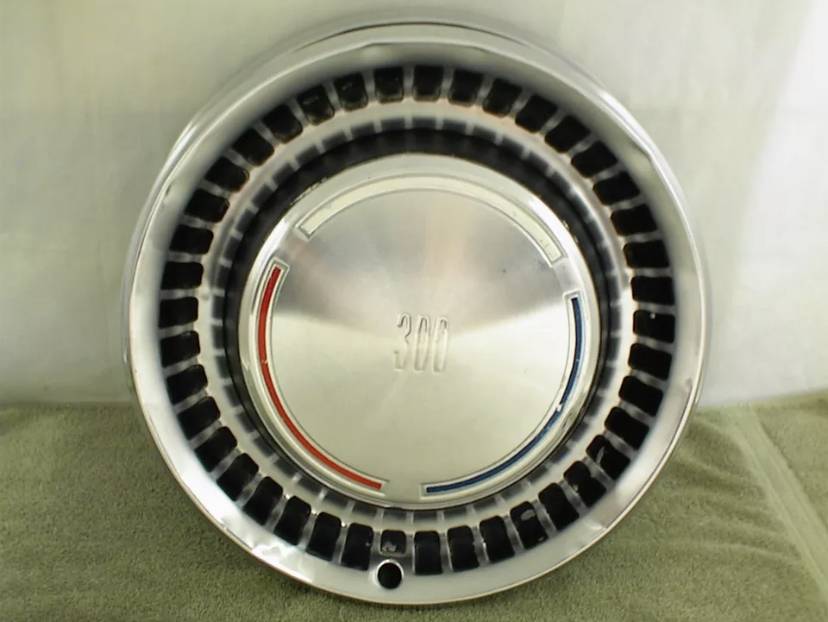

I have a ‘68 300 and always like that Chrysler made 300 specific wheel covers. I also have disk brakes which gives me 15” wheels which meant the 14” ‘68 300 wheel covers would not fit my car. But in ‘69 and ‘70, the 300 wheel covers were 15”. I ended up getting a set of 1970 300 specific wheel covers for mine.
i am eventually going to get mag 500 wheels, but for the time being I really enjoy the look of the ‘70 covers.
My caps aren't the best, so I thought I'd change up the look a bit.

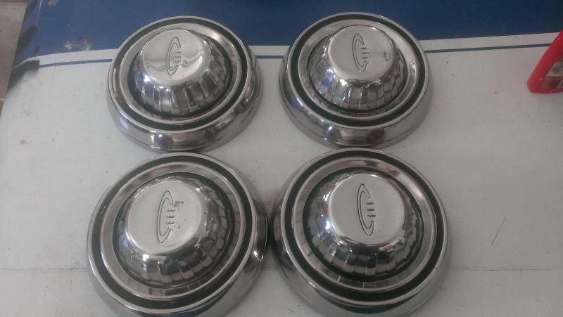

I've seen the generic aluminum caps, the police caps, dodge specific caps, Plymouth specific caps, but I don't think I've ever seen a Chrysler specific poverty cap, did they ever make one?

Yes they did.
These would be base equipment on Newports. I know they were used in 1966, probably 1965, and possibly '63-'64. Full wheelcovers became standard in '67.

well I'll be dipped, those have to be some rare caps
I've had the same set of police rims for almost 30 years, every time I put them on a different MOPAR I always search ebay for a set of matching caps, but have never seen a set of those
I'm sure that they aren't very common. I doubt that more than 1% of Chryslers left the factory with dog dish caps. I know that they will fit the '66 to '68 14" wheels, but don't know if they fit the common "modern" style 15 inch wheels.
