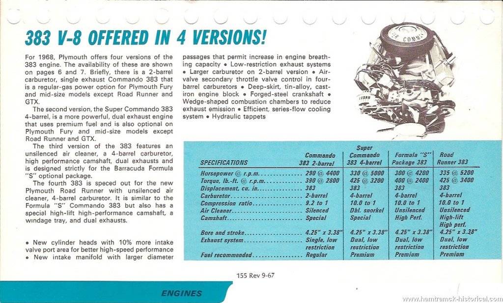

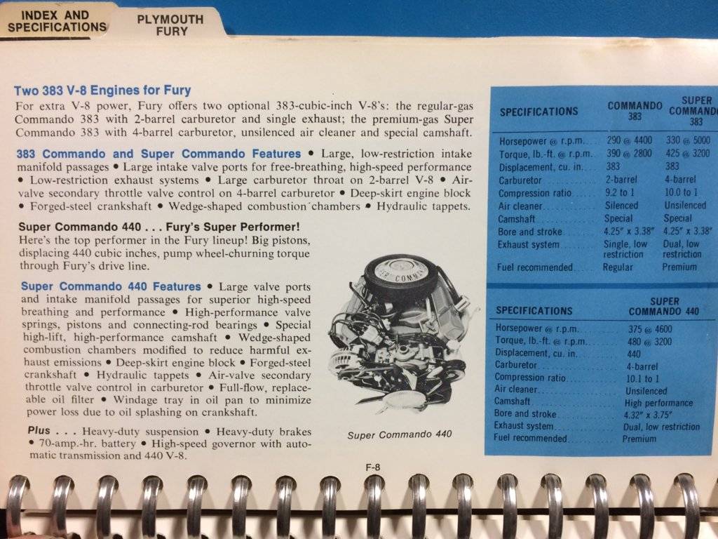

Aug 12, 2025 #2 68PK21 440.6bbl Old Man with a Hat Joined Nov 29, 2017 Messages 9,650 Reaction score 9,208 Location Siren City FL. Depends on your carburetor 2bbl vs 4bbl or version, Commando vs Super Commando. Nick's Garage - Air Cleaner Identification . Last edited: Aug 12, 2025

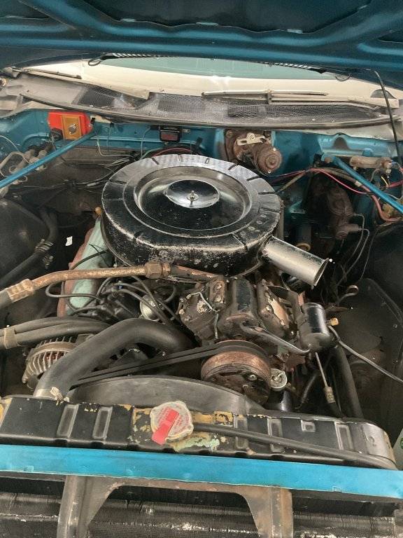

Aug 12, 2025 #3 66l78rat Well-Known Member FCBO Gold Member Joined Aug 28, 2017 Messages 580 Reaction score 730 Location troy mi Original 2 barrel setup
